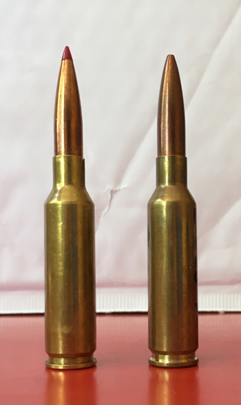

Post by Flyer » 25 Jun 2020, 10:05 pm
Water won't wash moly off bullets once it is applied (bonded) correctly. In fact, the wet coating process is preferred for molybdenum disulfide (MoS2) for this reason. Moly is not water soluable, but a slurry can be used to coat the bullet and if correctly done will not come of easily as it becomes impregnated into the copper after tumbling.
https://en.wikipedia.org/wiki/Molybdenu ... te_note-37
https://bergerbullets.com/official-moly ... g-process/
http://forum.accurateshooter.com/thread ... d.3922894/
Etc.
I haven't tried the 140 ELD-Ms in my 6.5CM, but the 143 ELD-X shoot great. Not as slipery as the ELD-Ms, but make a great dual-purpose target/hunting round. They can often be bought quite cheap as well.
First shot was a sighter and the next five went into .350" at 100m
123gr Lapua, four shots at 100m
143gr ELD-X left, 123gr Lapua Scenar right
