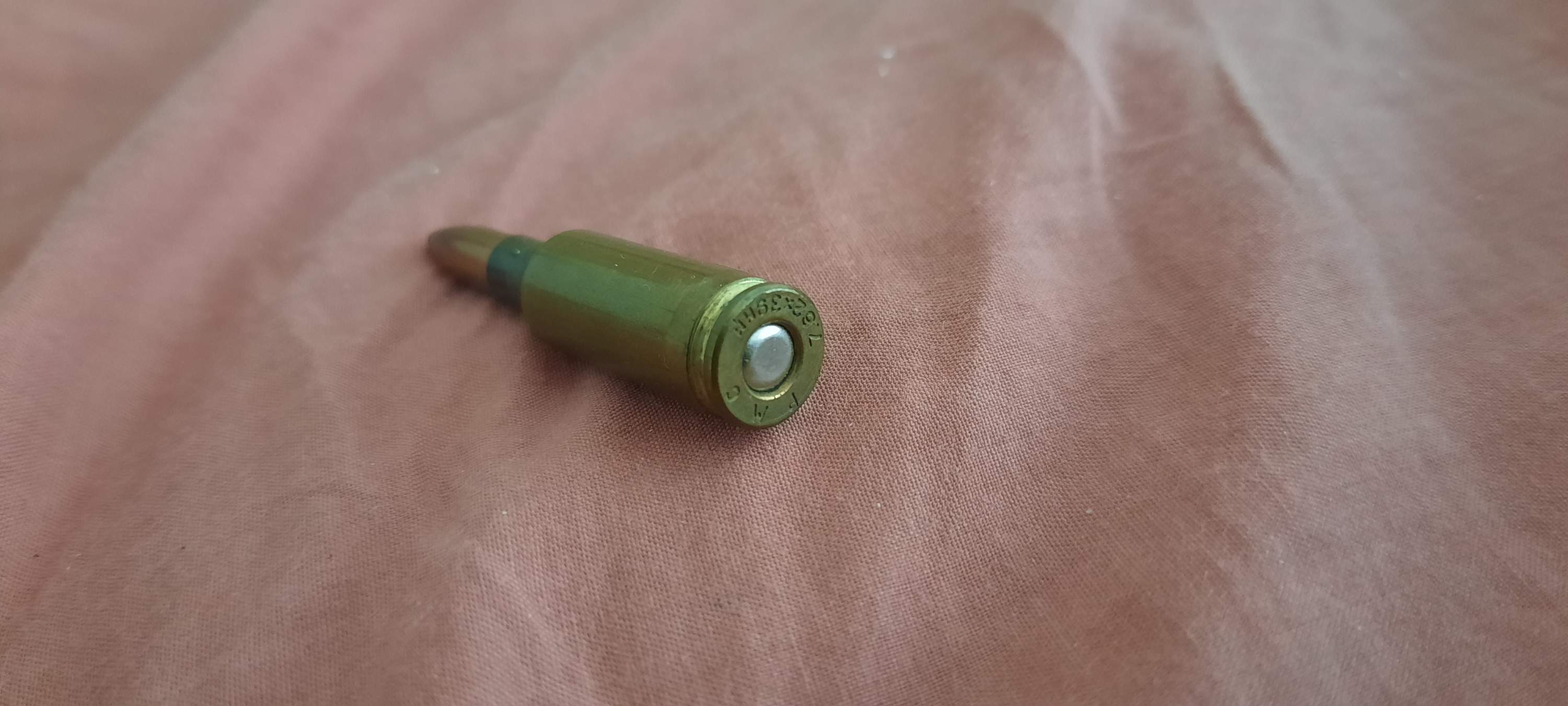

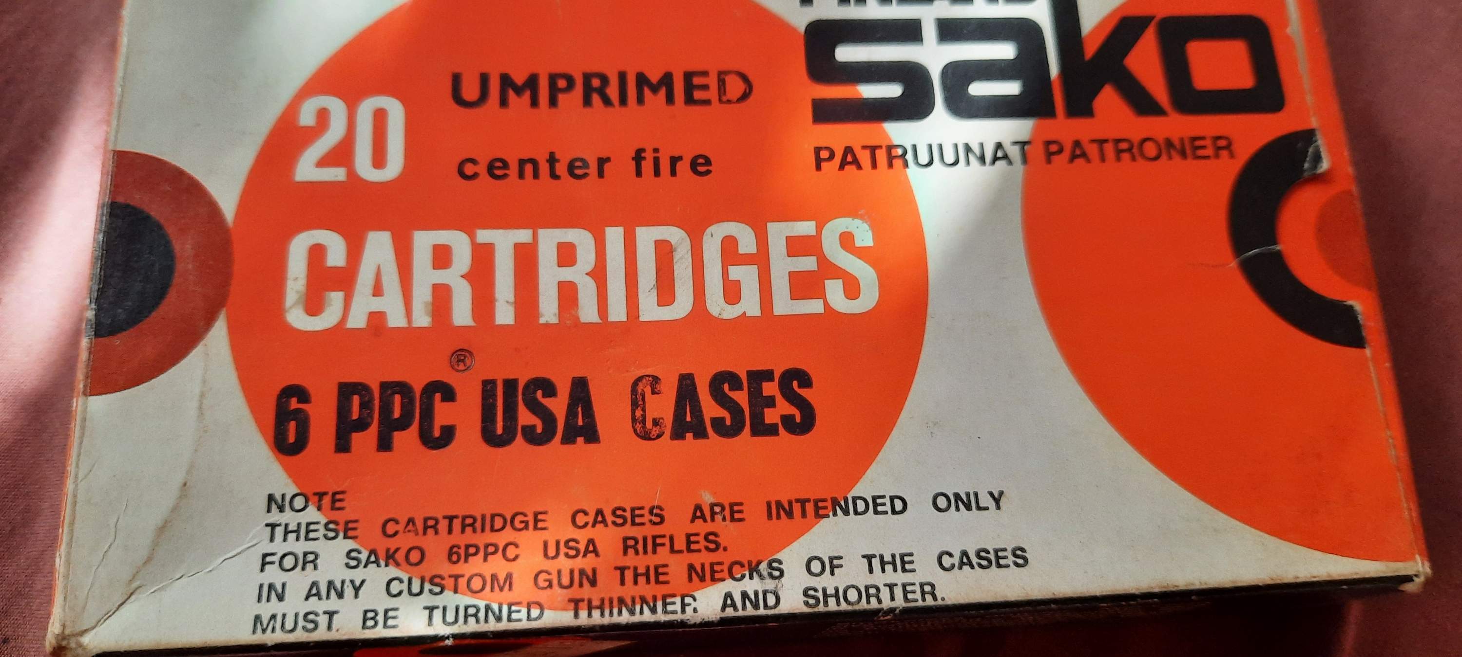

Post by Wyliecoyote » 30 Oct 2023, 9:59 am
The ARC as well as a lot of other cartridges over the last 20 years were hyped up for the primary reason of replacing the 5.56 in the M4 rifles. There are huge amounts of money on offer with US military contracts so there were a hundred or more attempts to formulate cartridges and hype them up to gain favour. Just remember, the 6.5 and 6mm Creedmoor were two such cartridges and for a while were looking to be the chosen ones.
This all came about because of issues in recent desert conflicts where the 5.56 was lacking in range and power. Nothing on the M4 platform came up as suitable and as so many have said, a new rifle was needed. That is happening with the new 6.8 x 51 cartridge in the M5, M7 etc rifles. All the other M4 contenders have or will most likely disappear in time. I still cannot see what the 6.8 SPC is good for but the 30 AAC should hang on for a bit yet. The 22 Nosler may take off if brass becomes more available.
As to the 6mm ARC. That is close to the the 6PPC USA cartridge of 30 plus years ago, along with the 22 cal version that Ruger and Sako produced rifles for and Sako and Norma made cases and ammo for. All are now defunct and collectable, especially the Sako rifles. The Sako cases were rated to 60k psi, the Hornady ARC cases are not. Both hold 34 grains H2O as opposed to a custom Lapua 220 Russian case formed to 6PPC that holds 33 grains H2O.
There was a time when the 6BR was thought to be the lowly second cousin to the PPC where many went out and built 6 PPCs in fast twist barrels with the view that if the BR did well, the PPC will do better. No one today uses a PPC anything for long range other than to be stubborn or not wanting to be part of the 6 BR devotees club. The cases died very quickly when pushed trying to keep up to BR speeds which incedently is the 2830 to 2850 fps accuracy node for 103 to 108 grain bullets. The ARC will never get there safely with powders we see here in Australia. Using Hornady cases against Lapua and Sako brass is a lose lose as the Hornady data rates max loads to 51k psi where at that pressure a 107 grain bullet is below 2700 fps. You simply cannot get enough 2208 or Re15 in the case to get there. The only way you can get there is by faulty chronograph which will get exposed once you try to dial up to 900 metres.
The 6mm ARC is simply a 6mm PPC tweaked to beat litigation which most likely would have still happened if either Pindell or Palmisano were alive. This cartridge has been around since the 70s and it's capabilities and limitations are well known. There is nothing new here except that like new fishing lures, they catch fishermen by claiming that it will exceed all previously known real world data in what most know to be inferior brass.
Now if one was to do this 6mm ARC for some obscure reason, i would suggest never use the Hornady brass. I would use the indestructible Lapua 7.62 x 39 brass formed down. Lasts forever and is way cheaper than 220 Russian brass where the large rifle primer is as good as adding 2 grains of powder. Below is a pic of a 7.62 x 39 PMC large rifle primed case, yes PMC when it was US made and as good as if not better than Lapua, way back when, formed to fit my then 6 PPC USA rifle for factory class Hunter Class benchrest. All now long defunct.
