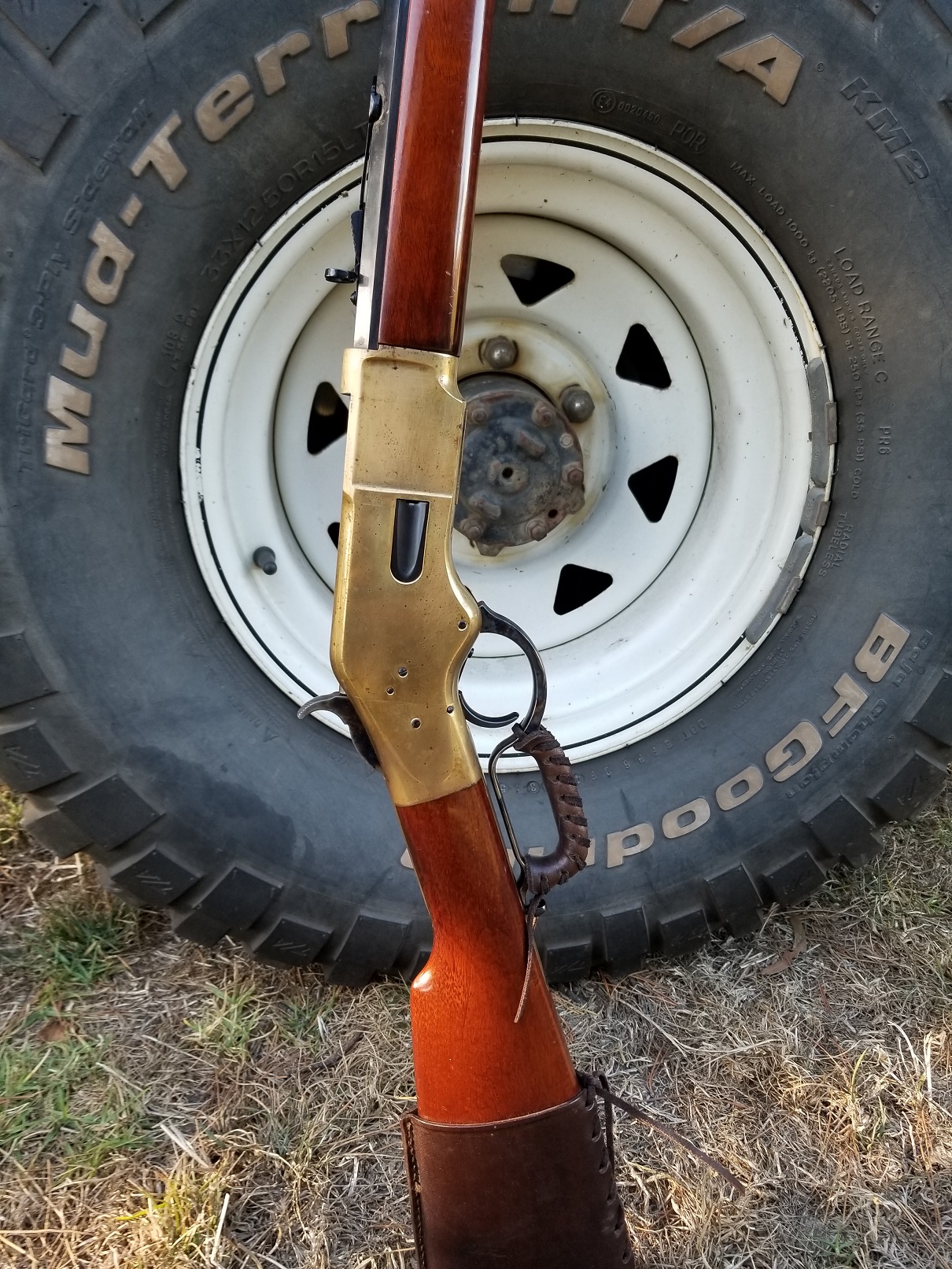

I have the Uberti 66 in .38 Special. I think it's a nice rifle, if you like the old-school toggle-link technology.
But it's also very expensive compared to my Rossi 92 in .357Mag, or my Marlin 94 in .44 Mag.
I think Uberti build them to withstand modern factory ammo though, if not there should be warnings in the manual and on the website.
I have subsonic loads in all three cartridges for every day plinking, they're all pretty easy on the ears, though the boom does get louder and bigger with increasing bullet weight due to the accompanying increase in charge weights.
If you want to hunt subsonic, I would go with heavier bullets rather than lighter. 240gn to 300gn, if it has the twist rate to run them.
