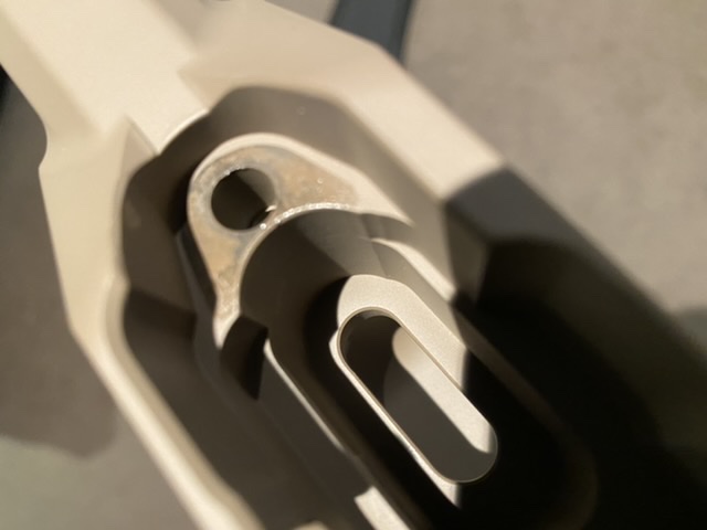

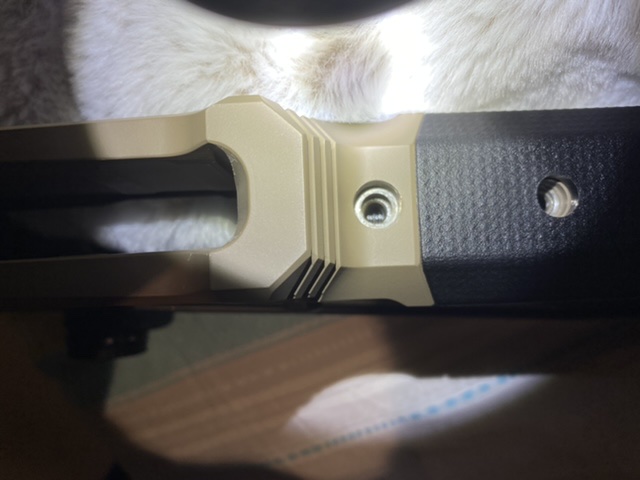

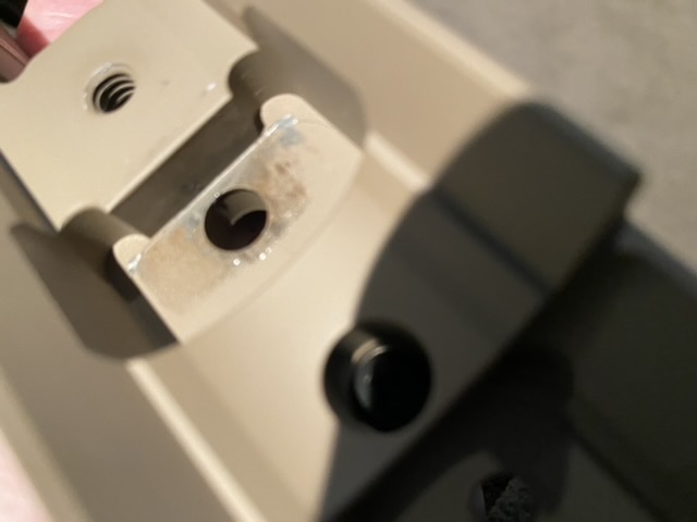

So, not touching on the alignment issues, Bolt holes not lining up, etc - here are two photos that touch on the more serious issue as I understand it.
I’m not a smith and don’t know exactly how big of a deal this is but based on my smiths reaction, a senior member here, as well as MDT - it’s not great...
There are two locations in the chassis where the action is meant to be mated too and the action screws / bolts should pull the recoil lug and rear V - into the chassis for a snug fit...which equals consistency. But as you can see from oil track on the rear section(note also the inconsistent gap each side) and the recoil cross bar - when the action is tightened up, the only thing holding the chassis to the action = screws. There is clearance at both the rear V and the recoil lug...this might be okay for a smaller calibre but a heavy 300 is going to move the bolts over time and Ive already had consistency issues...
As above - an engineer is looking tomorrow, will be interesting to see what they say, maybe the bolts are enough...
Now - initially I thought this might be my howa action, perhaps I got a thin / out of spec unit - but when I checked the same areas on the houge stock - it sits in tight and very snug...I then checked my other rifles and all are hard up against recoil lug....now MDT have effectively advised that this is normal for the howa and weatherby actions, as per their “poor” machining practices leaves a tiny chamfer at the front of the lug that prevents solid mating...I don’t know - you be the judge.
The fix - as offered by senior member on here - is to Remove some material and then bed the chassis, and this might have to do, but - it might pay to check if your in a similar boat regardless.

No good to hear you're still having issues mate, has your action been assessed at all? Little hard to tell from photos and not peeping at the set-up directly, but is your rear action screw drilled offset, not on the chassis, but the action itself?
I actually just went and had a look at the 300PRC Howa barrelled action sitting in my safe, my rear action screw is drilled slightly offset on the rear mounting tag, so that oil imprint as shown on yours, will be the same on mine. Providing it doesn't project the barrel on an angle I can't see an issue with that, that rear point of the action shouldn't be butting into the chassis, that's what the recoil lug is for and the bolts are simply there to hold the action into the chassis in a vertical fashion.
It appears there is more contact imprint on one side of the recoil lug in your photo, I do wonder if this is caused by the rear action screw skewing the action slightly. I find it hard to believe MDT have machined anything out of square, especially since I've just noted at least one manufacturing inconsistency in my own Howa. Kind of makes me want to remove my other Howa action from my ESS chassis and see what's been going on with that one. My missus punched a just under half inch group at 100m the last time we took it out, so can't be too much of an issue.
You noted that the recoil lug isn't butting into the lug receiver on the chassis, but I don't see any sign of the front action bolt contacting the interior of the fixing hole, if anything there appears to be marks on the face of the recoil lug block (Which I would expect to see). I have to admit I'm a little confused at what the exact issues are as everything I've seen with my understanding, looks fine, outside of the rear action screw hole being skewed on the action itself?
I've re-read your above post with pictures more times than I can count, the only thing I can think of is the lateral clearance either side of the recoil lug, while it isn't 100% ideal, I don't see that as an issue, providing your action recoils rearwards and not at a 90 degree angle. The upper section directly behind the recoil lug receiver centralises the action when it is inserted.
I must have completely missed something major going on with your particular chassis/action set-up as everything I'm seeing seems ok. Please let me know if I've missed something, could possibly save my ass in the future with my own Howa's and MDT chassis' if there is problem there that I'm just not seeing.

There are a couple issues and I get your comments - it’s hard to explain in words.
If you undo your action screws so they are loose - not fall out loose but just slightly loose, with the rifle on its tail - can you slide your action back and forth at all ? Theoretically - allowing for screw/bolt head movement, you shouldn’t be able to slide it backwards because it should already be hard against the recoil lug - mine is not - it will slide back and forth A few mm - meaning the only thing holding the chassis / action is 2 small bolts. The recoil lug is not engaged when action is tightened up.
Further - if you look at the bottom photo closely (above on chassis recoil lug), you’ll See the the recoil lug, literally cannot touch the chassis face due to a tiny chamfer on the leading edge. Yes - there are marks on the chassis - trust me though - this has been fitted on / off 200 times By countless ppl now, those marks are not from the action when in use - when both bolts are done up, U can get cardboard in between the two surfaces.
Also, That oil mark In the rear (was a test for mating by local gunsmith) - physically seeing it, means that it crept under the gap in the rear, so it shouldn’t really be there if there was good mating contact between the two surfaces...
Now the question about my action vs MDT is a good one and the answer is, I don’t really know. MDT sent me specs from their test actions and they aligned with mine but that doesn’t mean mine is straight as you say or measurements are correct.

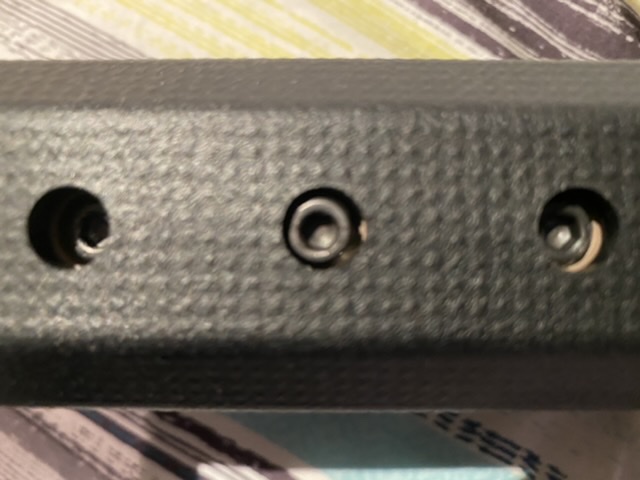

This was an additional calamity on previous chassis -
The last chassis that came to me from MDT - in the foreend - I could do up holes 1 and 3 but not 2, if I did up 2, I couldn’t do 1 and 3 - see pics.
