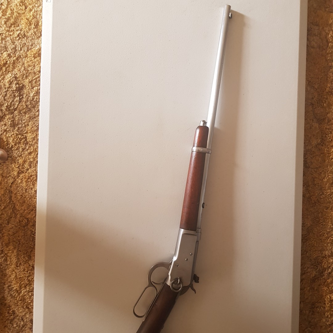

Hi guys, I've bought a couple of old Winchesters from a bloke, and he has offered me a 3rd. Not usually something I would buy, but he has caught my interest with this one
So it is an old 1892 half mag carbine that has had a 218bee barrel put on it. I asked if it was nickel finish and he just said not sure. This is the only photo I currently have, obviously looks too good to be original nickel finish on the action and mag tube.
What would this finish be? Can you replate an action with nickel?

I'm not going to say, outright, what you might have, But.
Some time ago, and after seeing on-line pics and description, I purchased what appeared to be a lovely old (circa 1908) Winchester Low Wall in 22LR. What I received appeared, somewhat like yours, to be "in the white".
After disassembling for a closer inspection and to understand why, I discovered that somebody with too much time on their hands had polished every last vestage of bluing off every surface that they could get a buffing wheel to make contact with. Yes, it was "in the white", but not in the true sense.
Had to get the barrel sleeved because the rifling was almost non-existent, and turned it into a nice shooter.
My suggestion for you: take it apart and have a very close look at all surfaces, especially what's "hiding" under the stock.

Probably wrong but It doesn’t seem to have the lustre of nickel - it looks a bit like highly polished steel - like the type of polishing thst can only be achieved with bench wheels, wax, a lot of hours and such.

So hard to say, but I'd venture that it's plated.
First, the barrel band looks like it's worn-through in a couple of spots, and whiter there, as steel would be, versus nickel. It also appears tarnished/stained, as does the receiver, back in the vicinity of the saddle ring. I think that if it were plain steel it would look worse, unless polished, in which case I'd expect to see more uniform color.
I'm as likely wrong as not!

Nickel plated.
Matt finish in nickel is not unusual with guns, reduces glare.
I’m no expert but i would think given the manufacture date ,probably a popular option for those with a bit more gold to spend, better than bluing.

The seller got back to me last night and said- I don't know about nickel it doesn't look like it, I think it is just bare rubbed steel.
He's an older gent who bought it the way it is. Can't say I've seen anything like that in person.
