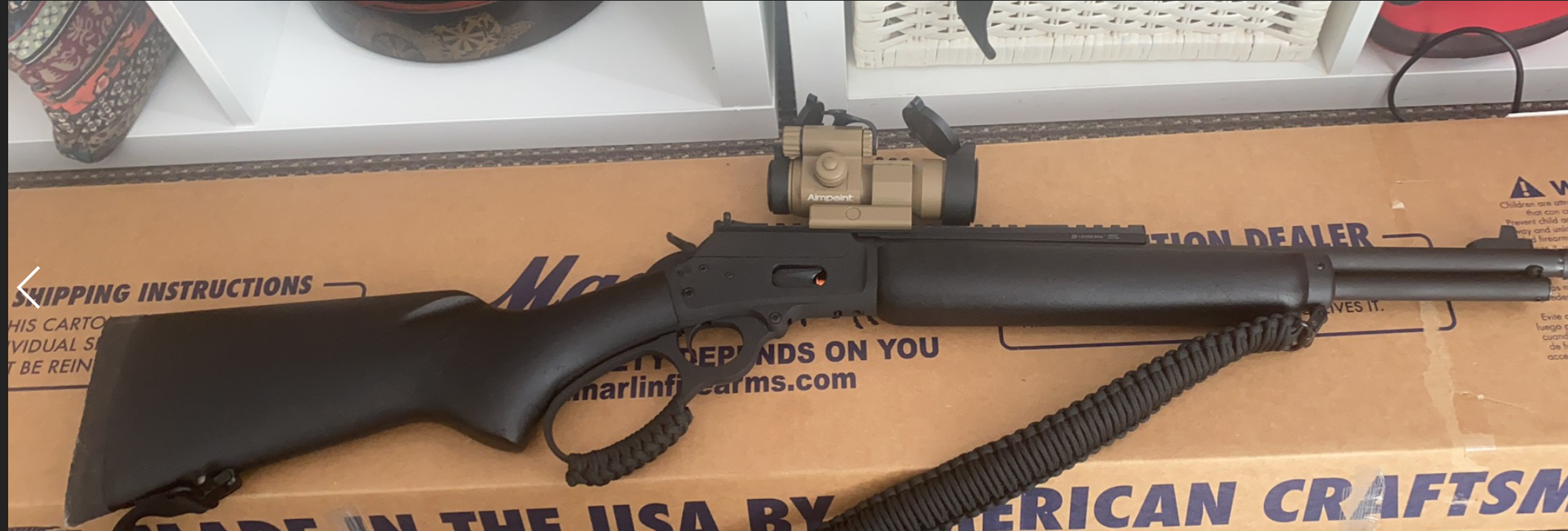

Got my first centerfire rifle, Marlin dark series 357, just love it.
I just notice some uneven surface under the stock, would this be an issue?

Are you referring to how the stock is proud of the bottom tang on both sides as well as the gap behind the rear of the tang?
I can't be sure but the rifle's pistol grip might be uncomfortable to hang on to during recoil. At best it is dodgy inletting and could be called cosmetically unattractive. If either of those ideas bothers you then try taking it up with the retailer.

The bottom tang can't be flush at the rear - else it'll drive a split in the stock. That's by design. With respect to the generally poor, fit and finish - that's a Remlin for yu :unknown: You roll the dice with em, some are better than others.
Posts: 3107
Re: Marlin Dark series 357 stock- Issue?
Post by Oldbloke » 02 Aug 2020, 4:55 pm
Bloody shame. Marlin were very good for many years.
I think u get 3 options
Return for rectification
Put up with it.
File and sand.

Just remove the stock by myself and reinstall, much better now. No issue with the firing for now after 100 rounds. Hope it can keep this way, bit disappointed for a $2000 range rifle.

What are those stocks made of? Maybe they know it is going to shrink over time

So, was it just not installed/fitted right?
