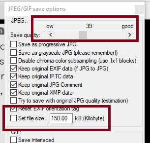

Of the slew of freeware image viewing software available on the net I have found Irfanview useful - it has an image save option that allows one to specify the saved image file size either via a slider (trial and error) or manually nominate a file size.
irfanview save as.JPG (44.67 KiB) Viewed 10936 times
