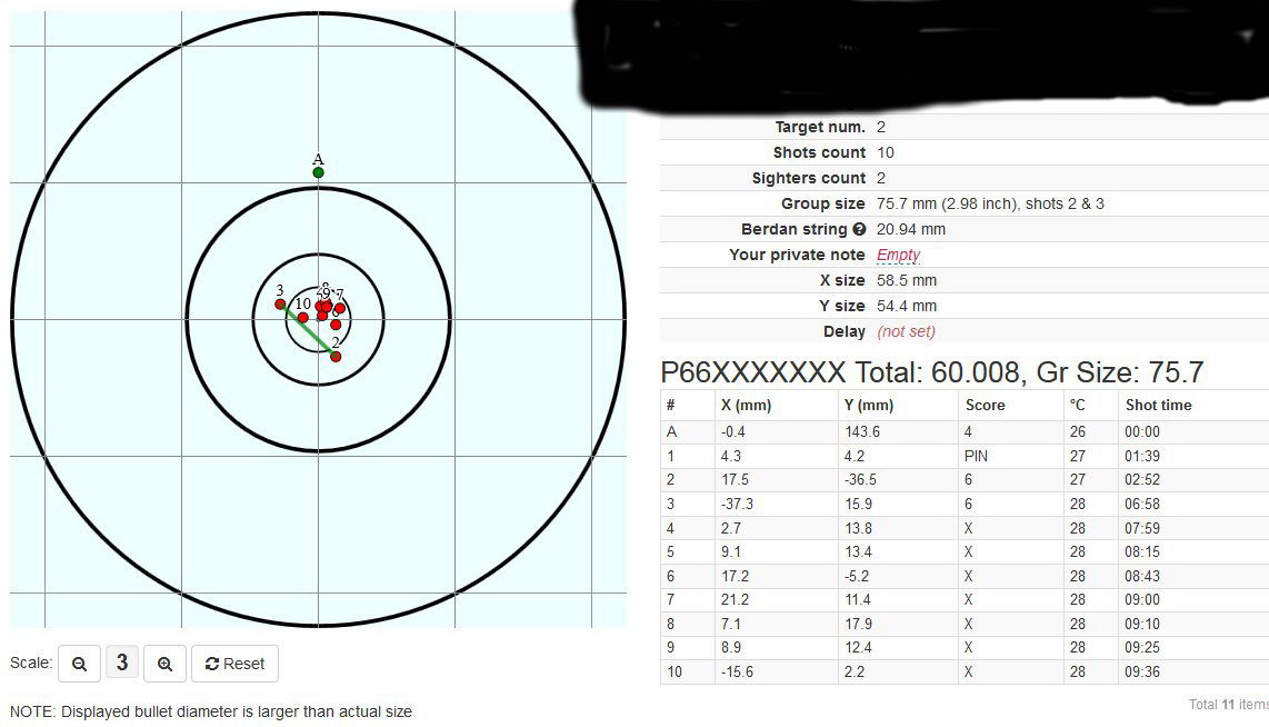

Yes the X ring at the 500 yrd target is 65mm or 1/2 MOA 0.5118 and the 6 ring is 130 mm or 1.02 MOA.
So a gun that only gives you a 1 MOA consistent grouping is really making things hard as there are so many other variables in getting a shot down range. Just the way you place your hand on the stock will influence the position of the shots.
This is one of my better targets shot at 500 yrds
Posts: 939

Post by Bugman » 11 Mar 2021, 4:27 pm
Just off the subject a bit. These are terrific targets. I see them in use at my local range.

Post by in2anity » 12 Mar 2021, 9:21 am
Bugman wrote:Just off the subject a bit. These are terrific targets. I see them in use at my local range.
As in the digital system? What is that Larry - Hexta? Nice shootin btw - so close my friend, sooo close...

Post by Larry » 12 Mar 2021, 12:19 pm
Yes the target system is a Hexta. We are fortunate in Australia that a lot of the clubs have gone with these systems. They are the best in the electronic target systems out there. Expensive though again fortunately despite what a lot of people think about our government and there stance on Gun policy they do give a lot of grants to sporting clubs making these competition grade targets obtainable.
