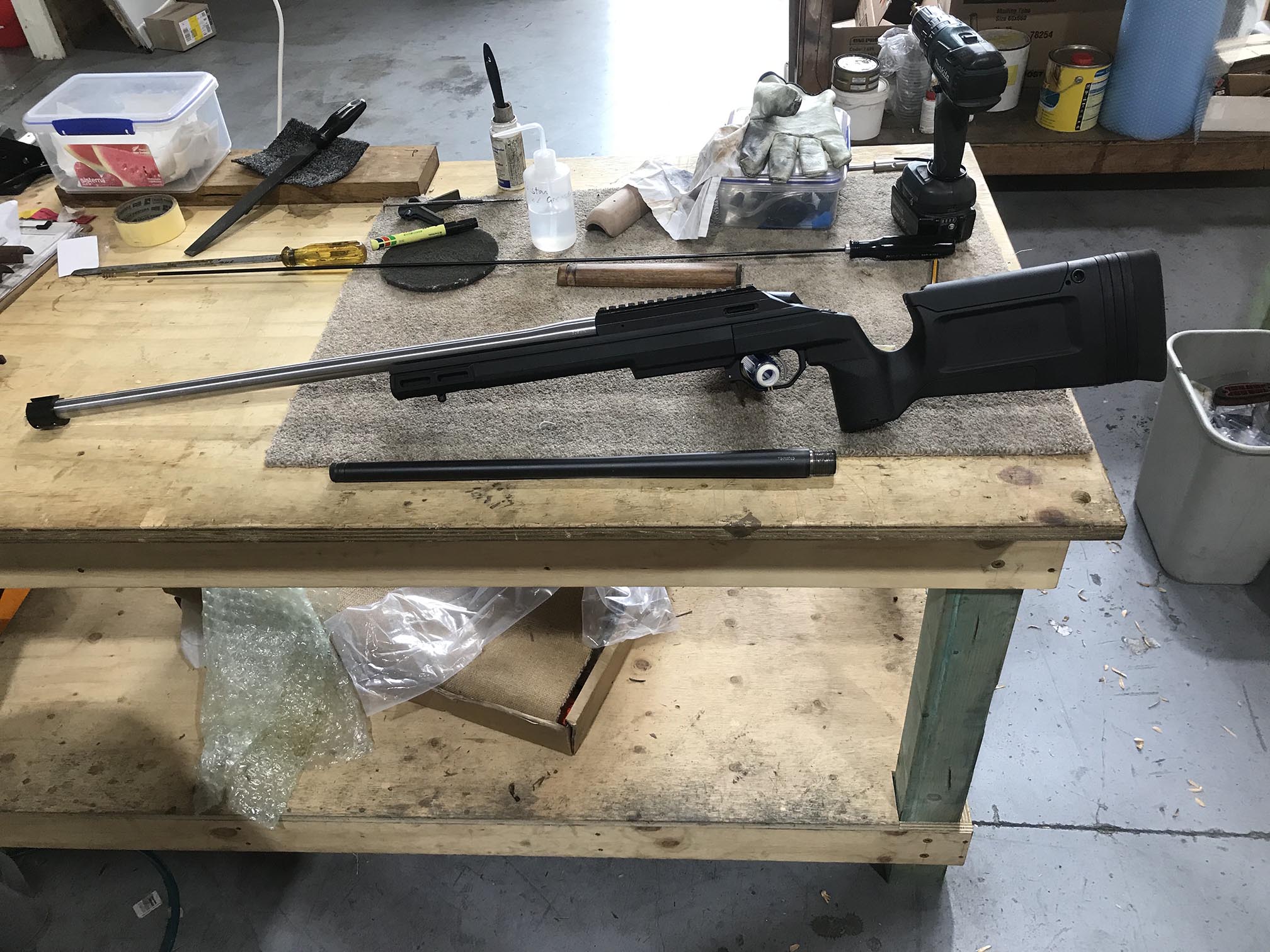

Personally, I'd be looking at a custom build off the bat. You can have a custom built rifle made on a moderate donar for less than the cost of those fancy tactical things, that will likely shoot better.
I've just had a custom crossover TR/light-F built myself which was a KRG BRAVO stock + tikka t3 donar action + 30cal Krieger Palma, for less than $3000. It runs a 10-shot mag and it'll shoot Xs out to 800m, if you're doing your bit.
I've also built a 223 on an old HOWA donar, with a Lothar-Walther 1:9 - that thing's also a god-damned laser, but more a 500m gun.

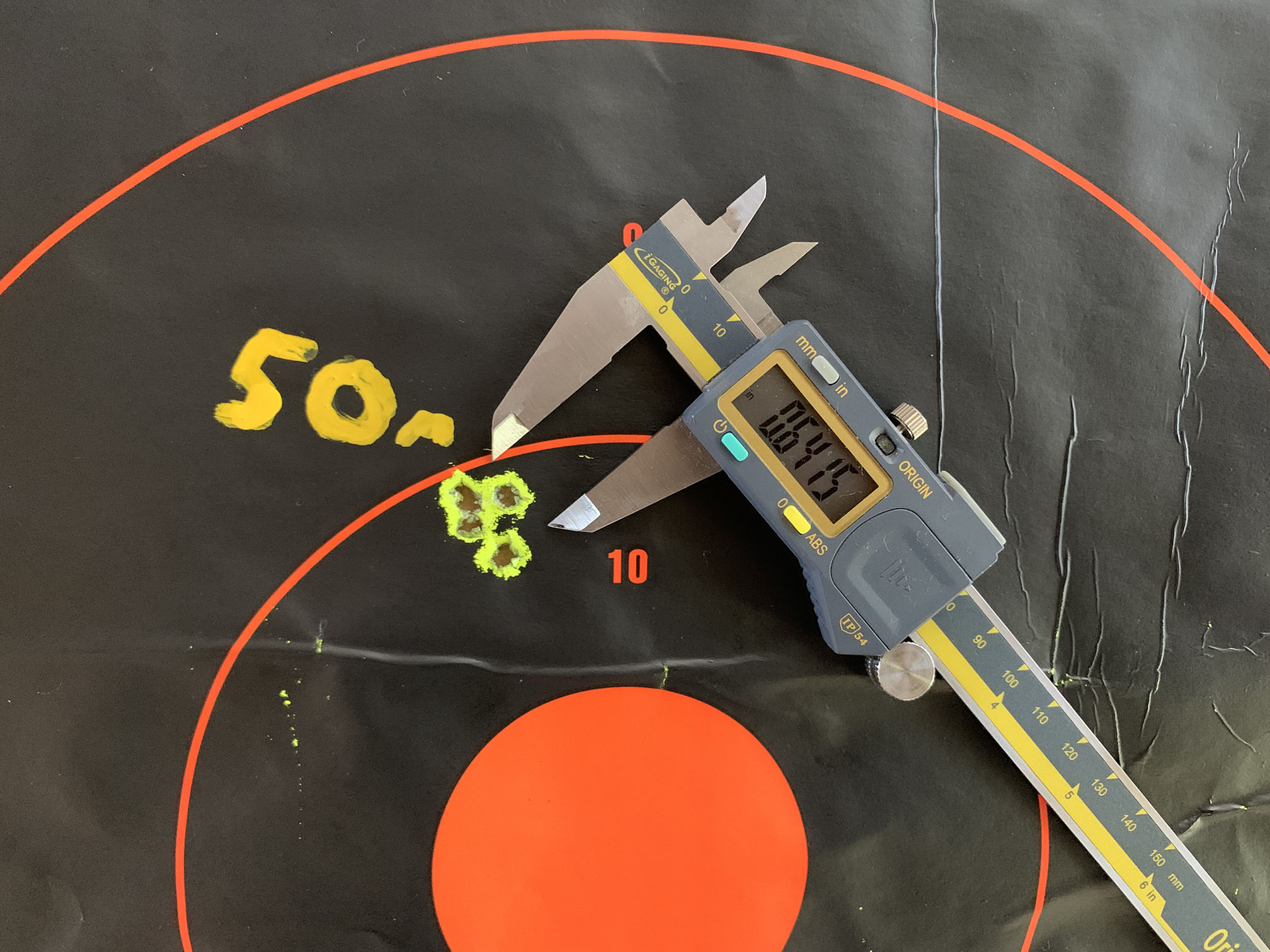

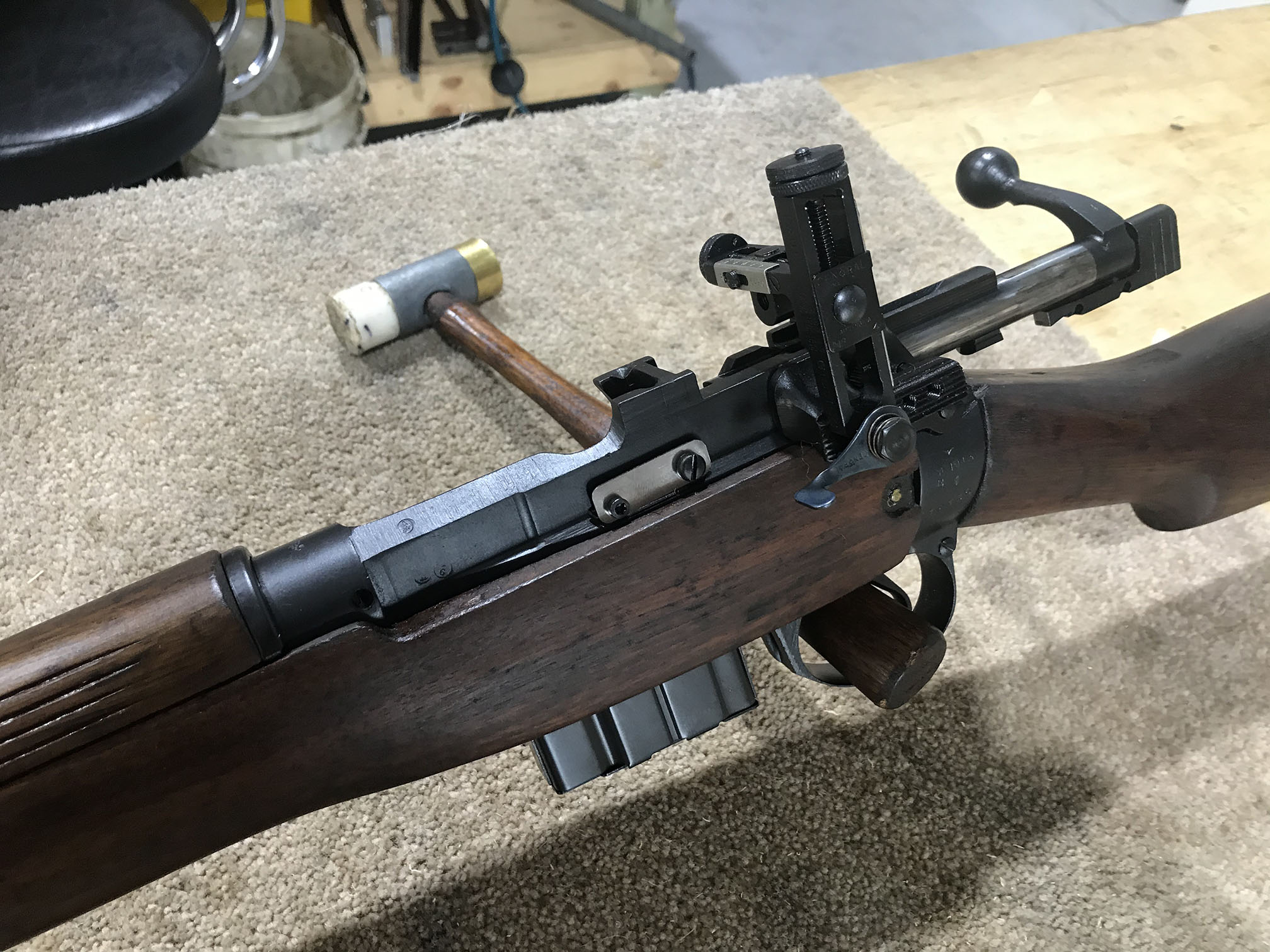

I've only done a little bit of long work with the 223 TBH - mostly stuck to the 155gr performer out of the 30cal TR. It's in my agenda though - I have a 1:8" 223 that's punching WAY above its weight. I'm keen to give more of a look-in, on the fullbore side, mainly for fun, but it should hit the 5s, if I'm doing my part. I will do what you say, and batch my 77s SCJ - thanks. BTW check this out:
No4-223 conversion
Typical groups:
shot w. central + front blade service sights!!
Sorry, don't mean to hijack - it's just that's a little mind bending, to me, considering it's the rear-locking, SMLE design... :o

Post by SCJ429 » 22 Mar 2021, 12:59 pm
Great work, much better than anything I can do with open sights.
