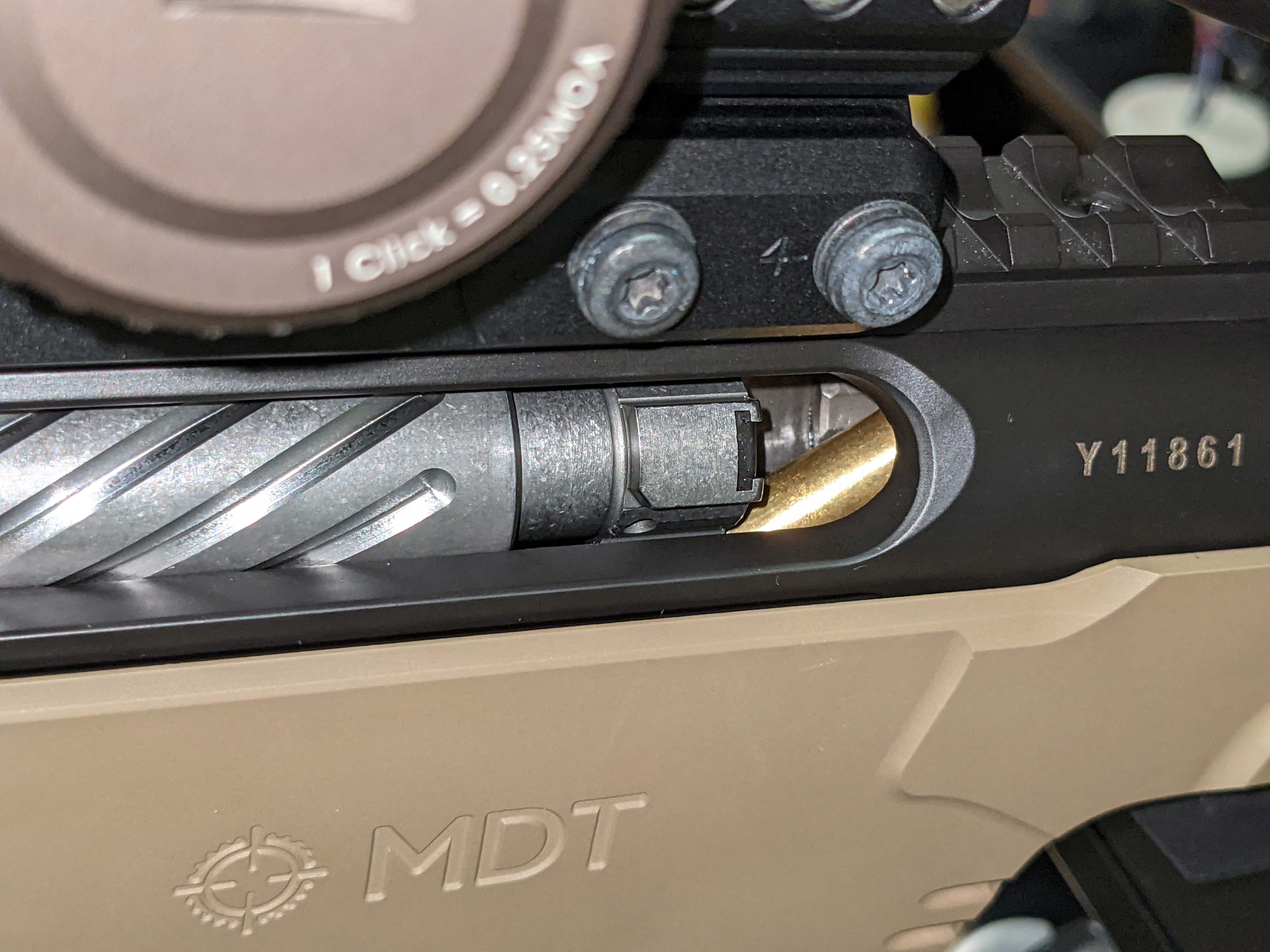

Post by Medb » 31 Jul 2021, 6:03 pm
Thanks for the various suggestions and ideas.
I have sent a message off to lithgow with all the info, so I will see what they say. Otherwise my preliminary plan is to put some better quality ADI or OSA rounds through it next week and see if the same issue occurs, and stop at the first sign of any trouble.
My only other thought was that the cases on those rounds may have possibly been slightly dented or damaged due to being used for some earlier testing when I was having feeding issues with a certain magazine. The rifle has been installed into a MDT ESS chassis, and one of my magazines was not feeding correctly and I was trying to diagnose it. See the picture below as an example.
However it's not like it's a semi auto where the rounds would be subject to significant force, I was being quite gentle with the action and once they became stuck like that I did not try to forcefully jam them in any further. But those same 5 rounds that I was using for testing which went through the action a bunch of times and sometimes became stuck like that were definitely included in the batch of rounds I was firing.

Post by Blr243 » 31 Jul 2021, 7:20 pm
I might be jumping the gun but now I see that pic I think mystery solved

Post by Wm.Traynor » 31 Jul 2021, 7:22 pm
Medb wrote: I was being quite gentle with the action and once they became stuck like that I did not try to forcefully jam them in any further. But those same 5 rounds that I was using for testing which went through the action a bunch of times and sometimes became stuck like that were definitely included in the batch of rounds I was firing.
In support of that, there are no serious scratches on the ruptured cases above,
