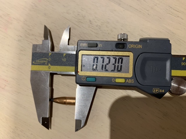

Post by in2anity » 11 Aug 2021, 9:50 pm
Traditionalist, reaching deep into my rotting memory, I had a dig around and actually found a 55gr Sako Gamehead factory round:
55gr sako gamehead projectile
As it turns out, they are shorter than anticipated at 0.723”, which means indeed a 1:12” would be close to ideal.
Nevertheless my point still stands, a faster twist gives you more options without too much of a hit on accuracy. I have both a 1:9” and a 1:8” comp gun and they both shoot a lot of pills very well, including the 55grs.
Btw those Sako rounds are dear af. Would you really buy a gun to run only those?

Post by bladeracer » 12 Aug 2021, 2:59 pm
SCJ429 wrote:The old 222 benchrest guys would shoot 52 grain bullets from their 1:14 twist barrels. I would be surprised if a 1:14 223 barrel could not stabilise this 55 grain bullet.
My 14"-twist .222 loved the 52gn and 53gn HP, and I did get it to shoot a 55gn FMJ.
At .723" I would expect the Sako bullet to shoot okay in a 14"-twist, but it might be marginal.
In an 8"-twist it'll be fine.
