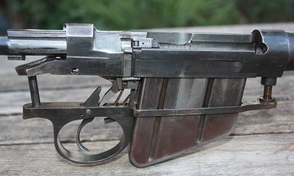

I've seen plenty of "sporterised" .303's that mainly involve cutting back some of the wood, replacing the sights, and maybe cutting a bit off the muzzle, or even rebarrelled to something different entirely.
But I've seen some where the socket has been milled away to allow the action to drop into a conventional one-piece stock. Is that common in Oz or perhaps too specialised for most of the farmers that did this to their old bangers after the war?

I briefly looked into this before, a quick google search yielded this:
I wondered if there was some thought that it wouldn’t be conducive to accuracy, because it’s straying from the og design so heavily. But I have a feeling it would be accurate, provided it was close tolerances + headspace well and using a quality, heavy-ish match barrel.
I wonder about recoil bearing surface however.

Yes, that's them. A more in-depth conversion from just being a military rifle adapted to sporting to use to actually turning it into a sporting rifle. The next step would be making an integral magazine to do away with the 10rd box. I suspect it would make a very nice rifle, but I've never come across one in the flesh. I can't see any issue with lacking accuracy as it has to be more rigid than the socket setup.

What about recoil abutment Blade? Where does it go? I can see the stock splitting…

It looks stronger than the socket to me, though you'd likely want to weld in something to replace the socket, or put a forward cross-lug through like Mauser did. The socket setup separates the recoil into the sides of the front stock and the butt stock itself. A conventional stock transmits all recoil straight back to the buttplate. The socket has the advantage in fabricating the wood, I don't think the design is of any recoil management benefit. Two-piece stocks went out of favour before the Lee Enfield was invented, it really only stuck around in levers and single-shot designs I think, for ease of manufacture and aesthetics. Inletting the stock around the action is a pain, much simpler to butt both ends up to the action, but it's not as strong.

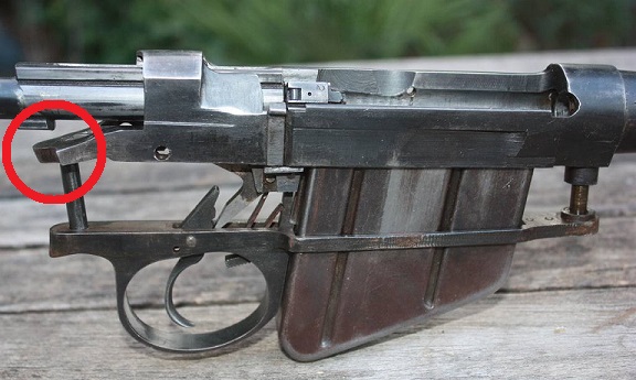

IMHO: I think the socket is there due to the Lee Enfield's rear bolt lugs. Because of the rear bolt lugs, the force (recoil) of the round being fired is transmitted down the bolt and into the action quite far back compared to modern bolt guns. Recoil goes from the rear of the action through the socket and straight into the butt stock, and I think the the stock and action forward of the charging bridge probably has a surprisingly low amount of load put through it.
If you remove the socket, then you're going be relying on the the action screws and the small area at the back of the action (see below) to transmit the recoil to the stock. You could install some kind of larger front recoil lug, but then you're probably going to be loading up the action in ways it wasn't designed for, and may not see any benefit anyway.
