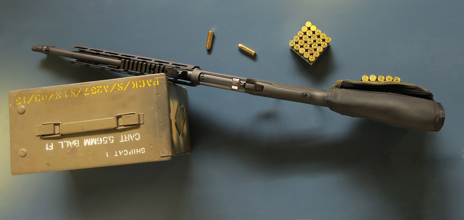

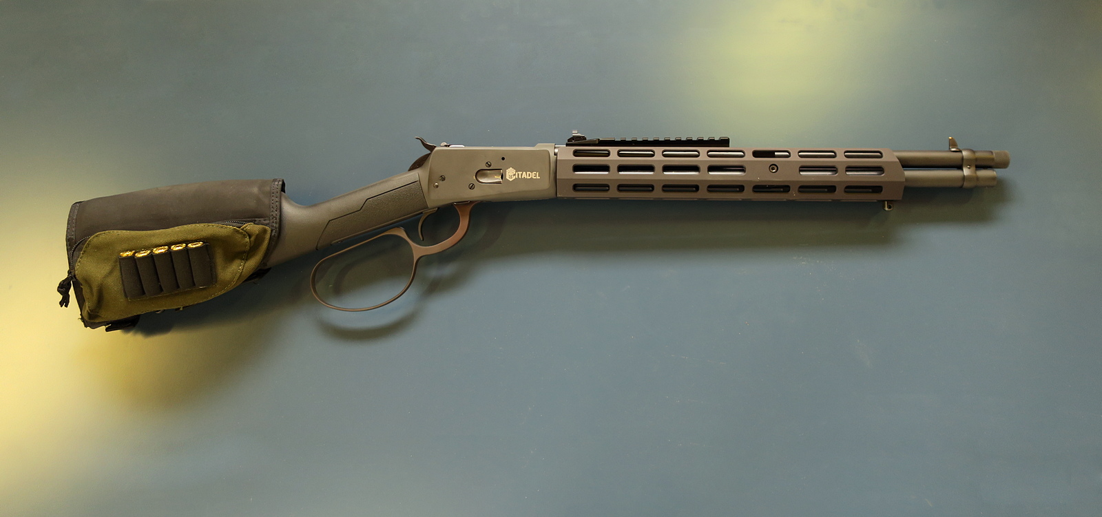

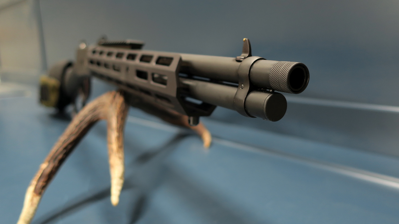

Post by SHV » 26 Mar 2022, 10:38 am
love this rifle although need repair straight away after I got it brand new

Post by Fionn » 26 Mar 2022, 1:10 pm
SHV wrote:love this rifle although need repair straight away after I got it brand new
What did it need repaired?
Fionn
Posts: 622
Re: Ross citadel Levtac 44mag
Post by SHV » 26 Mar 2022, 1:25 pm
small problem
last round can not load
the follower jammed so stopped early than it should be, so the last round still 1/3 in the tube when the follower stopped
I used the fine sand paper polished the follower slightly few times now it works fine
Post by Pighunter » 29 Mar 2022, 11:03 am
How do you find the recoil on it with the light stock? I'm looking at these should my gun license ever make it off the "team leaders" desk.
Is the follower metal or plastic?
Post by SHV » 29 Mar 2022, 2:47 pm
haven't find a chance to shoot it yet
the follower is green colour plastic, the material and quality seems good although it was a little too big for the tube
Post by Pighunter » 27 Aug 2022, 5:44 pm
Well mine broke today after a week shy of 2 months of ownership and very light use.
Got home after a night of hunting (walking around and never shooting) and was giving it a clean cause it was covered in dust, noticed a screw was sitting out slightly, went to tighten it up and realised it was completely loose, popped open the lever and turned the gun upside down only to discover a part had broken after half of my right cartridge guide fell out onto the floor. So now I'm in the process of seeing what the dealer can do to fix it.
It's not a common part to break on Rossi/Citadel and I can't even find an instance of someone elses cartridge guide breaking.
Pighunter
Posts: 101
Post by Fionn » 27 Aug 2022, 7:16 pm
I have never heard of the right side breaking, I can't even think how it could as the left does the work.
Must have been a faulty part.
