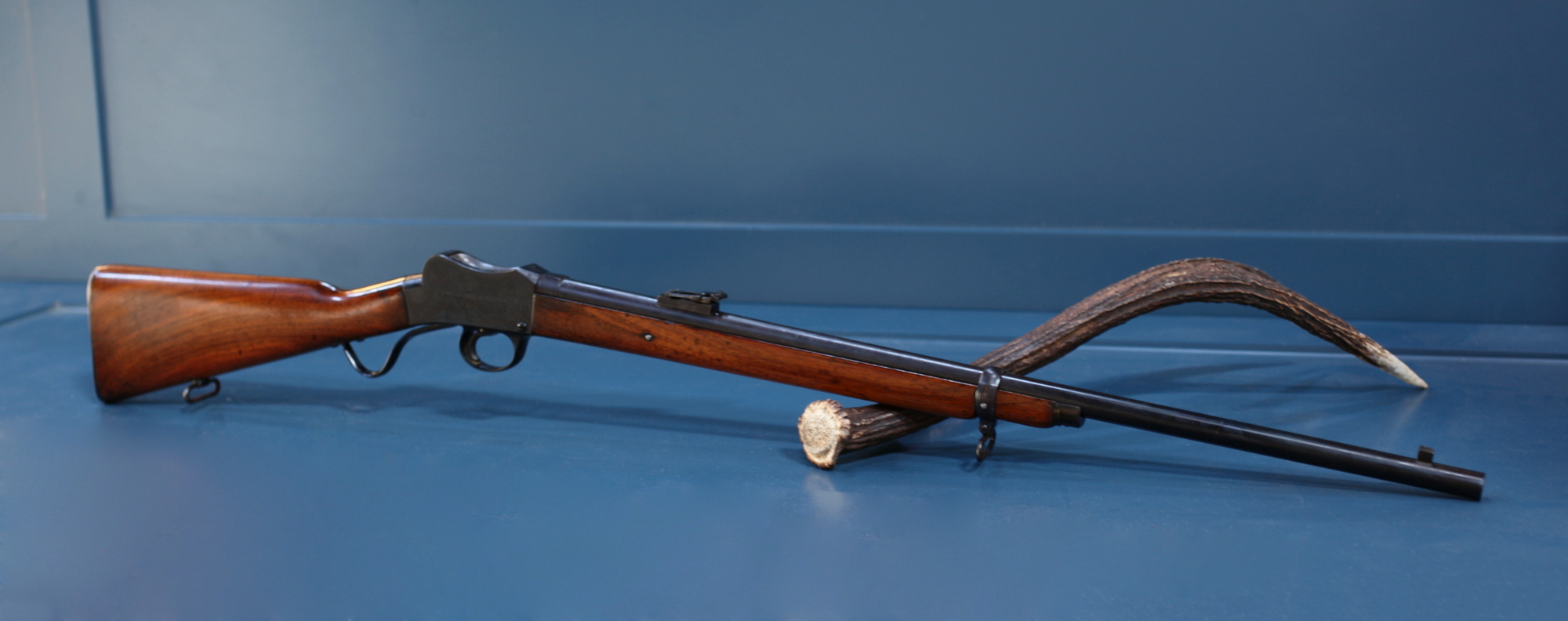

Post by SHV » 13 May 2022, 12:56 pm
Could some one please tell me the difference between:
.310 Cadet 128gn Round Nose Heeled Flat Base .323
and
.310 Cadet 122gn Round Nose Flat Point Flat Base .316
just bought the rifle, die and case ready to reload but don't know which projectile I should buy
thanks
SHV

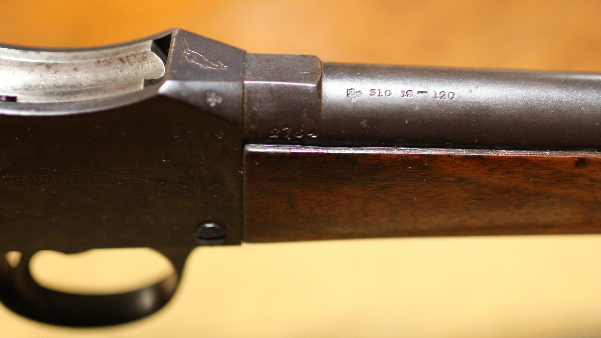

what does 12-120 mean?

Post by bladeracer » 13 May 2022, 1:09 pm
SHV wrote:Could some one please tell me the difference between:
and
thanks
Push a lump of soft lead through your bore to determine the bullet diameter you need. You might also want a chamber cast to see if you have enough room in the chamber to not have to use heeled bullets. The heeled bullet has a narrower tail that fits into the case mouth, the driving band of the bullet is larger so won't fit into the case. The non-heeled bullet is designed to push into the case mouth like we normally load. This will also determine what you need to neck-size the case down to. If you have unsized brass see if it will chamber.
Re: need help 310 CADET
Post by bladeracer » 13 May 2022, 1:10 pm

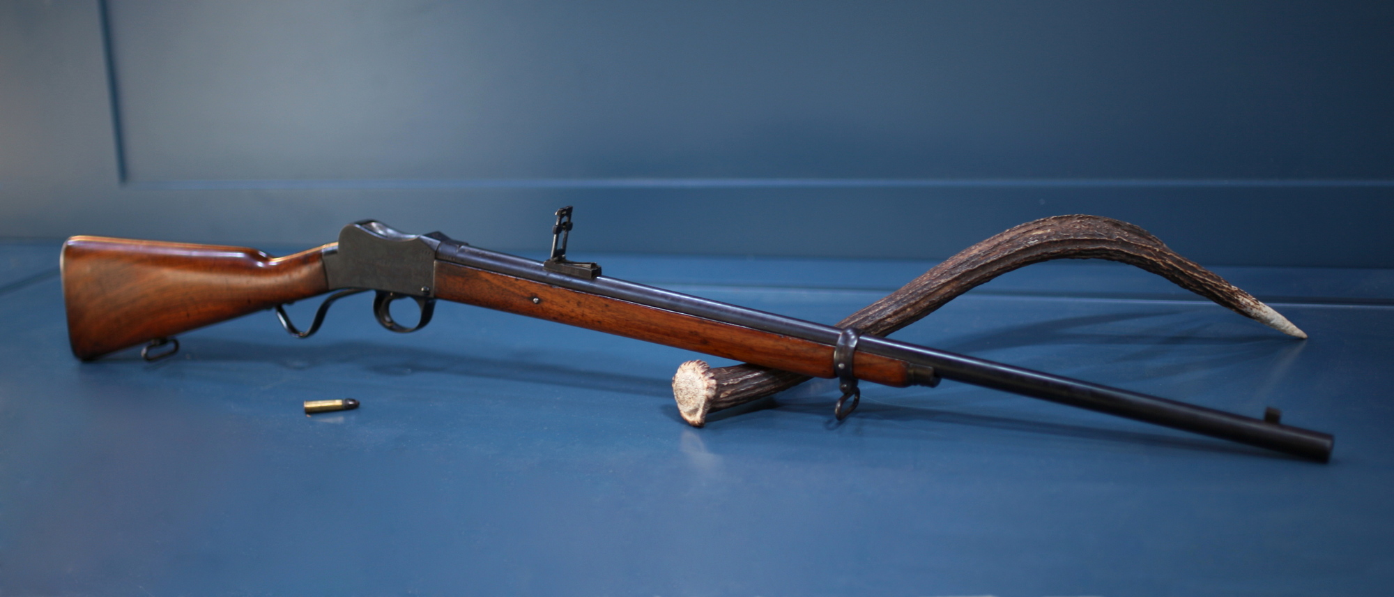

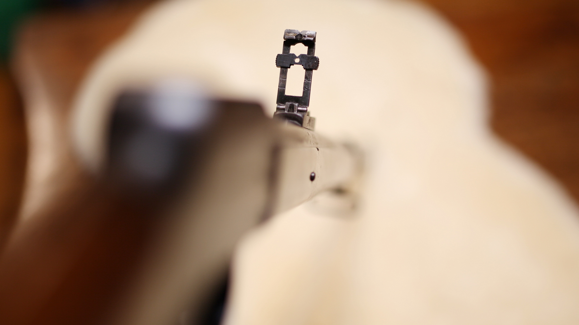

Gorgeous rifle!
But is the rear sight on backwards?

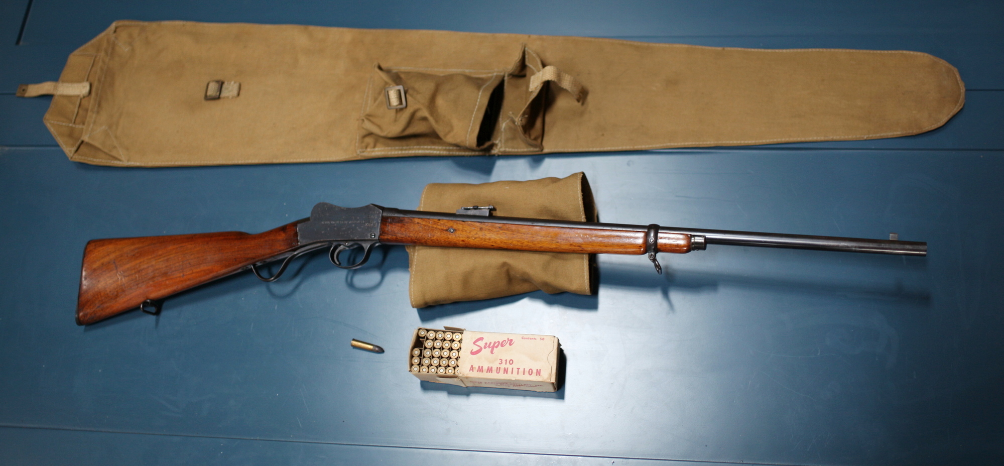

thanks for the reply, new case fit in no problem
SHV
Posts: 1780

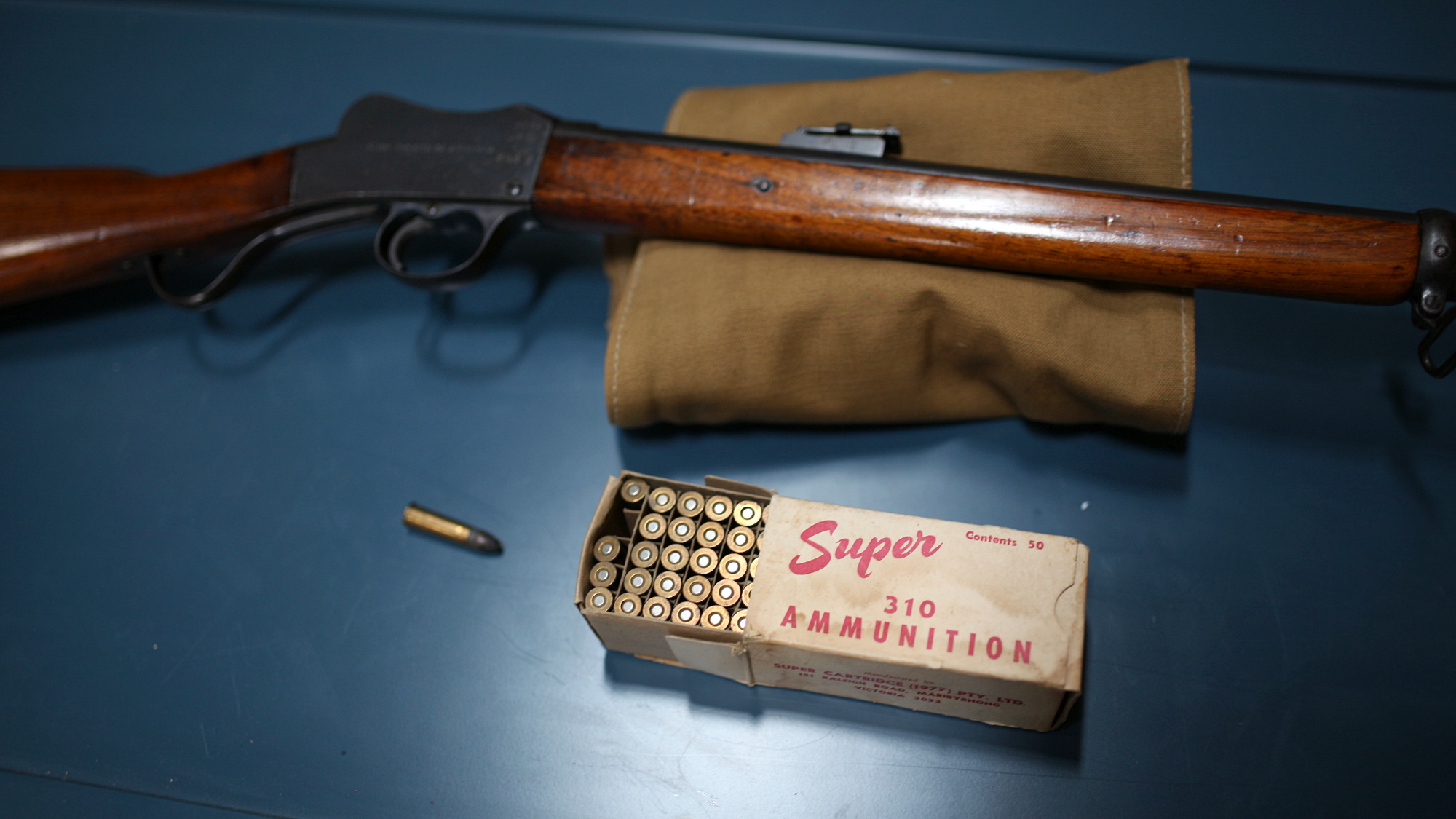

Post by bladeracer » 13 May 2022, 1:22 pm
SHV wrote:thanks for the reply, new case fit in no problem
I see you have ammo there, does it shoot accurately in the rifle?
Is it loaded with a heeled bullet or a conventional bullet?
Is the bullet .316" or .323"?
Post by SHV » 13 May 2022, 1:51 pm
haven't got chance to shot it yet also I got the only one (last one) box of ammo it looks cool as well so I don't want to shoot them
I can push a 311 projectile into the barrel from muzzle easily ( tight fit but smoothly with a little push) does that mean it needs to be 323?
SHV

Post by bladeracer » 13 May 2022, 2:18 pm
Yes, I would be saving that stuff as well:-)
Probably but not necessarily. The .311" bullet should be engraved with rifling in a .316" barrel, but that assumes the muzzle rifling is not worn. A .323" barrel would probably not engrave the rifling into a .311" bullet at all as you would expect bore diameter to be around .008" under or .315". 8x57mm Mauser uses .323" bullets. If you can get some .316" bullets from somebody try them. Buying a mould without actually determining the diameter you require would be silly, unless you go over-size and size down to what you need. Any soft bullet will do to push through the bore. I bought 10rds of 00 Buckshot rounds when I wanted to slug the bore of an 8x57mm rifle years ago. But I've also used soft lead sheet rolled up to slug bores.
I'm guessing the ammo you have has the bullet seated into the case, not just the heel?

Post by bladeracer » 13 May 2022, 3:41 pm
SHV wrote:Doesn’t look like heeled to me
Yep, that's a heeled bullet, the bullet is narrower where it fits inside the case mouth, like .22LR.
If you know that the rifle shoots well with those then order the heeled mould.

Post by LawrenceA » 13 May 2022, 5:13 pm
SHV wrote:what does 12-120 mean?
The 12 means 12 grains of powder and the 120 means a 120 grain bullet.

bladeracer wrote:Gorgeous rifle!
rear sight, the hinge on the back
