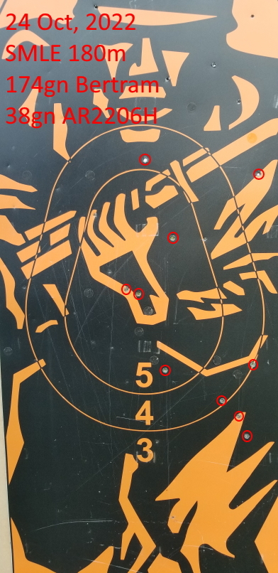

Post by bladeracer » 24 Oct 2022, 11:21 pm
Been a while :-)
I had a hernia repair surgery two weeks ago, then two days later ended up getting an ambulance back to hospital for an indirectly-related issue but all good now. Wasn't up to shooting at all for seven days then started getting back into it slowly practicing offhand with the Henry .22LR. We've been calving for a few weeks, going up to check on the cows every three hours, including through the night. Each check is a 600m to a thousand meter walk for the round trip and great exercise for recovering from the surgery. In daylight I've been taking the Henry and shooting some steel on the way up and back.
Went out to a mate's place today, did a lot of walking and found a spot where I can shoot out to 1000m. Only issue it's across a heavily-treed valley so walking out to check the targets doubles the distance, quite a bit of hiking :-)
Also shot another round with my case life test brass in the SMLE at 180m on the Figure 11. At least the zero is pretty close, though I might try coming up a notch on the rear sight next time.
I practiced a bit with the .22LR first to get a feel for the wind was it was weird, no wind at all for the first 45m because of a shearing shed I was shooting alongside, then a gap of 50m with an 8mph to 10mph crosswind coming through a gap, then the line of fire ducks behind a ridgeline where there was no perceptible wind again. The .22LR gave me about 4.5MoA of wind at 180m which I didn't think would mean much to the .303 so I held dead centre. The group is only about 1.5MoA off centre. The group is 190mm wide and 420mm tall. I called one of the high shots but the rest felt like they were on when I fired them. I shot this just kneeling behind the ute tray, very informally. Pretty happy with the result but I want to see if I can improve it.
My eyesight has not improved so the front sight is still virtually invisible. I have to find a background of contrast to find the front sight, get the sight picture, then move the sights over the target, it does work but it's not ideal :-)
I have been playing with the EyePal aperture but it really is a painful way to shoot. It does make a remarkable difference in defining the sights almost perfectly, but it's _very_ difficult to actually see anything else through the hole, it's difficult to find the target, and I have not been able to use it with both eyes open at all. It pretty much takes all the fun out of shooting. But I want to try to make it work for me so I'll persevere with it a bit more. I want to find the position for it on the glasses, then drill a 6mm hole through them so there is nothing between my eye and the sights, I'm hoping that will be a big help.
My mate did manage to find the jacket in one of the holes drilled in the mud. I'm sure the Bertram bullet would make a nice hunting bullet.

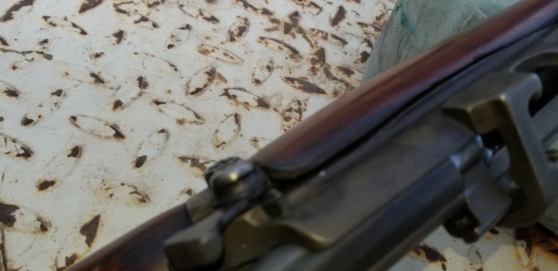

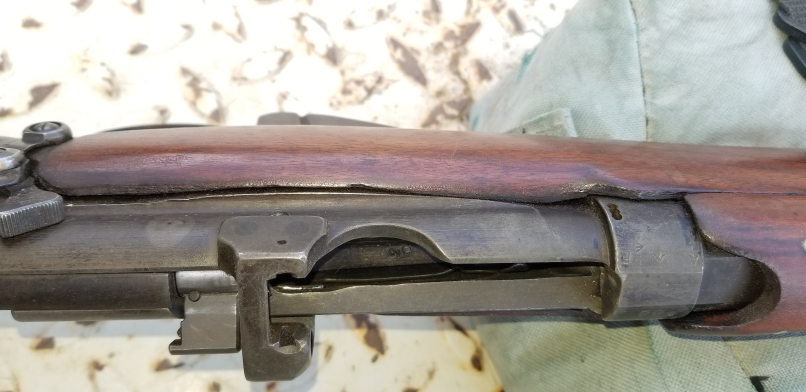

But I also found what might be an issue with the old Lithgow. Looks like the standard SMLE failure of the draws but I'll have to strip it and see what's happening inside. If it's not something I can fix very quickly I may have to take the PH aperture off the other SMLE and switch to that one.
Posts: 12693

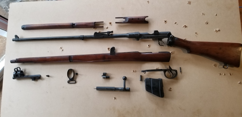

Post by bladeracer » 25 Oct 2022, 4:39 pm

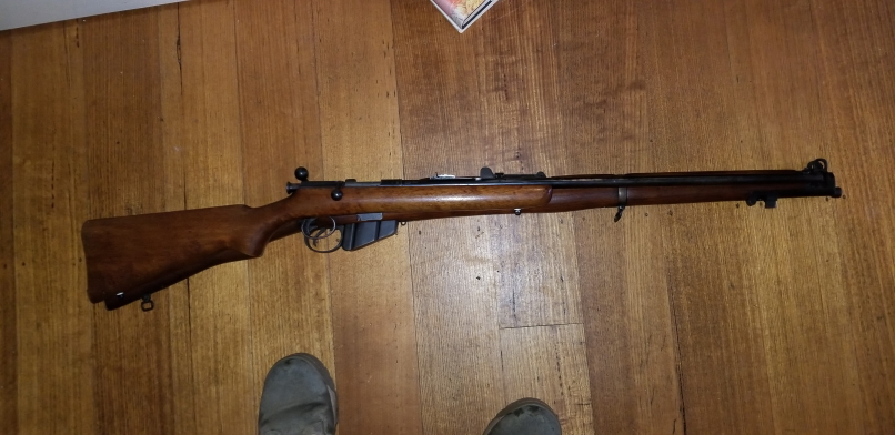

I stripped the rifle and had a close look at everything. She's been very well looked after, any screws that were munted since 1943 have been replaced at some point, and nothing was very tight, just tight enough, as they should be. The barrel channel is tight and shows no signs of somebody trying to relieve it anywhere.
Very pleased, especially as the front handguard was "glued" fairly well to the barrel with old oil - I was dreading finding rust under there when it showed signs of stubbornness. A nice coating of Ballistol should prevent any more of that.
I can't find anything in the inlet that indicates cracking or movement or looseness and the wood is a fairly tight fit around the action. I think it's just been a little over-relieved along the left side, leaving a heavy shadow line that caught my eye yesterday.
I've got photos now so I'll carry on shooting and just keep an eye on it.

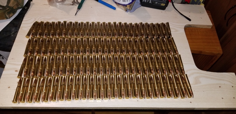

I made up fifteen dummies this week to practice dry-fire rapid and reloads, which have been running just fine. Except that every single time (no exceptions) I strip the rounds into the magazine the top round gets rim-locked, whether I strip in one charger or two. I also discovered the mag holds, and feeds perfectly, eleven rounds - maybe it's not entirely "as issued"? I tried loading the chargers sloped rather than staggered and so far they load just fine, zero rim locks. I used Federal brass for the dummies as I only have about 50 pieces. It's possible it's just this brass as the PPU seems to work fine, or it might be a nasty result of stripping the rifle last week. I've been videoing myself running the dummies. Just running 10rds through the action in my lap without pulling the trigger takes about seven seconds. From prone, running the mag through the rifle, including getting a rough sight picture (on a tree at 50m) and dry-firing each time is about 28 seconds. It then takes about five seconds to grab another round, toss it in, close the bolt, get a sight picture, fire, and open the bolt ready for the next round. From prone this is significantly quicker than trying to strip a charger into the magazine and reacquiring the target. I'm sure it's quicker to run five singles than to strip a charger in, then fire five rounds - from prone it's fairly awkward stripping a charger into the magazine and requires some positional changes. Grabbing loose rounds from the ground and tossing them in is smooth and very easy with no change of position - five singles loaded, aimed, and fired is only 25 seconds. From offhand and kneeling a charger is quicker.

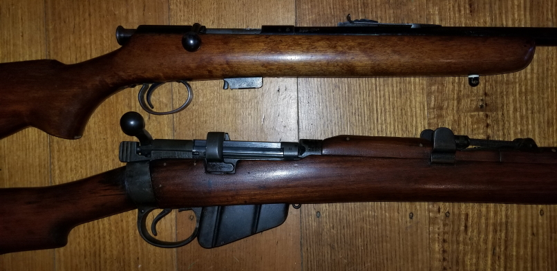

It occurred to me the other day that my 1951 BSA Sportsman 5 might make a decent .22LR analogue for practicing with, so I pulled it out.
Length of pull, bolt position and overall length and sight radius are pretty close :-)
Going to do a lot more practice with the old girl I think.

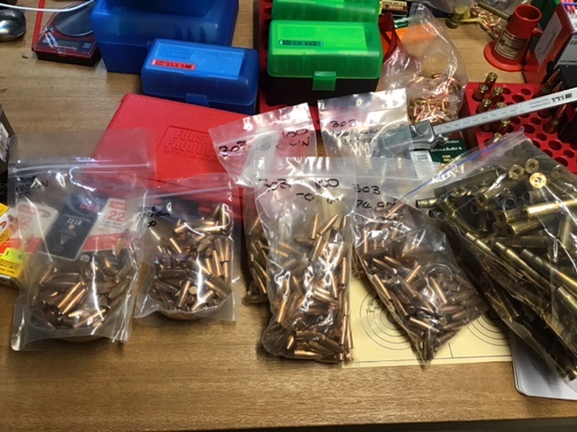

December was a mess and I don't think I took the .303's out at all. The past couple weeks I've been laid up with an infection in my arm so haven't done any .303 practice this year either.
But I was able to load up a large batch of ammo that should be enough to last me most of the year if I do decide to shoot all the LERAA shoots, as well as plenty of practice here at home. The Bertram and Driver 174gn bullets shoot fine for practice, I reckon it's at least as good as military ammo. But if I decide to get serious I can load more up with Hornady's 174gn FMJ which does shoot a little better.
