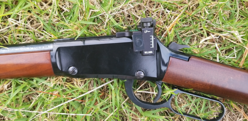

I only have the basic H001 .22LR.
I'd rate it middle shelf.
Nicely finished, poorly assembled.
Hate the pot metal receiver cover.
Lots of little pieces to lose during disassembly.
Pretty reliable though and reasonably accurate.
Good price.

The frame of the receiver is aluminium, the cover is not - it's a pot metal based on zinc (so is the "brass" cover). Not a bad product in itself, in the right circumstances, but tightening up scope mounts crushes the dovetail very easily. Would've helped if they'd put a recoil lug in the top to prevent the scope creeping forward under recoil, wouldn't need to rely on clamping force then. The Williams aperture sight is so much lighter than a scope it's not an issue. A minor issue when I installed the aperture is that the front sight was too short, and is a single pot metal casting. But it is held in place by a screw so I made a new post out of a screw and put that in instead.
My front wood moves back and forth 1-2mm, more annoying than a real issue. The butt stock has a couple millimetres pivot to it, which is very annoying but doesn't cause any issues. It "clicks" as you transfer the weight from the wrist to the butt plate. I drop the rifle from the shoulder every shot so I can catch the empties, so I feel it every time. You can see the angle of the butt stock and generally poor fit in this pic. You can also see where the dovetail has been chewed up by the scope.
As you say though, it is built down to a good price so these minor issues can be tolerated.
My next project for this one is to make up a tube to put onto the muzzle to move the sight post further out so I can actually focus on it. Figuring to start with a 300mm tube and find out where I need the sight, then cut it to length. As I can use the front sight screw to hold it in place I'm hoping I can do it as a removable piece without losing zero between fitments. The issue is leaving enough clearance to remove the magazine follower for loading

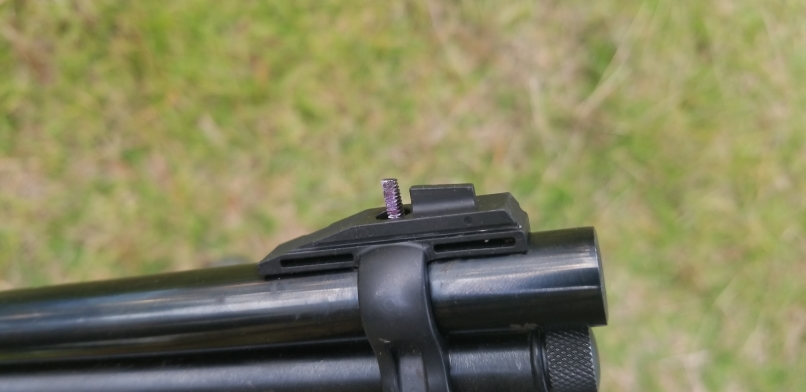

bladeracer wrote: A minor issue when I installed the aperture is that the front sight was too short, and is a single pot metal casting. But it is held in place by a screw so I made a new post out of a screw and put that in instead.
Some bogan gunsmithing right there :lol:
Henry do make taller front sights for them, they send them out for free to new owners in the US, so wouldn't cost much to get them to Australia.
bladeracer wrote:My front wood moves back and forth 1-2mm, more annoying than a real issue. The butt stock has a couple millimetres pivot to it, which is very annoying but doesn't cause any issues. It "clicks" as you transfer the weight from the wrist to the butt plate. I drop the rifle from the shoulder every shot so I can catch the empties, so I feel it every time. You can see the angle of the butt stock and generally poor fit in this pic. You can also see where the dovetail has been chewed up by the scope.
My Henry doesn't have any of these issue, the fit of stock is near perfect.
I prefer to think of it as "expedient engineering" :-)
Replacing the sight is an option as well, as was simply building it up with epoxy - the screw was simpler and keeps everything original.
I'm glad you got a good one, I'm sure most of them are. Mine isn't so good and I can only base my opinion on my experience. As I said, for a fairly cheap rifle it's pretty good overall. Their centrefire models are priced in a much higher bracket, and I would expect the quality of those to be higher, but I don't own one so haven't commented on them. Henry is a relatively new company, and have built themselves an excellent reputation in that short time. My only contact directly with them as a customer was excellent - I asked them for the screw pitch for the front sight and they got back to me with the correct info within an hour or two.

Agreed. I have issues with mine. I have never bad-mouthed Henry over it, but I don't sugar-coat it either - it is what it is. It happened to me, it could happen to somebody else. Better to be aware of it than never mention it. Even if I had gotten mine repaired or replaced under warranty, it still happened, it's still reality. I love Ruger but I got a dud magazine with one rifle, and it was replaced under warranty, it happens.
