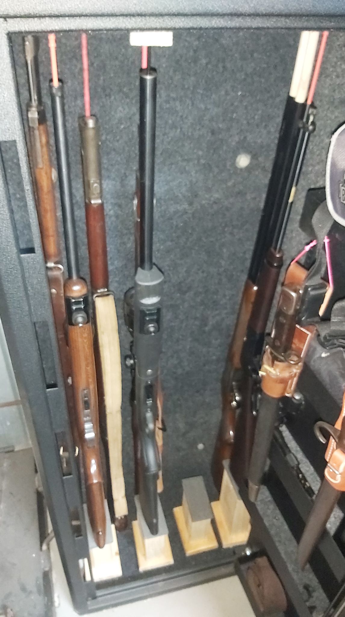

Sorry if this isnt the right place for this but i was wondering if anyone knows if there is anything particularly nasty in heat shrink tubing that would do the bore of my rifles any harm. i tried making some rifle rods to get more usable space in my safe. basically i just have brass rods that i put a bit of heat shrink over that velcro to my roof of the safe. Worked pretty well, went from struggling to fit 8 with the wall spacer to looking like i could fit 10 pretty easily now.

and a tikka t3x .204 at the gunsmith being fitted and pillared to a boyds stock

Its only plastic...

If the rods are brass you don't need anything. Use "as is".

Not keen on that idea . It could have unforeseen affects on the lubrication inside the bore . I can't say I have had any experience in this matter or point to any specific problem but I just don't like it .

Oldbloke wrote:If the rods are brass you don't need anything. Use "as is".
True. the heat shrink is more to make up a little more space in the bore as the rods a little undersized. plus even though I know brass wont hurt the rifling, just the though of metal scraping in and out makes me cringe a little

Here's some thoughts for you.
Brass is a relatively soft metal compared to the steel of the barrel. Unlikely to cause any problem.
A copper projectile will get the hurry up and whistle down the bore at a couple of thousand feet per second. No problem.
A brass cartridge case will be inserted into, and extracted from, the rifle chamber. Not usually a problem.
A brass rod can easily be wiped clean prior to insertion into the bore. Shouldn't be a problem.
But consider this. The heat-shrink plastic is much softer than the brass. Hard/gritty particles could become embedded in the plastic and might then abrade the crown or bore.
If it were me, I'd be inclined to use naked brass.

Also, depending on the quality of the heat-shrink, it can be affected by oils and solvents. I've seen some of it it turn into a sticky goo on the underground machinery I used to work on.
Certainly wouldn't want that down the bore.

No1_49er wrote:Here's some thoughts for you.
very goo points, i might remove the heat shrink and get thicker brass rods when i cant get around to it

Gamerancher wrote:Also, depending on the quality of the heat-shrink, it can be affected by oils and solvents. I've seen some of it it turn into a sticky goo on the underground machinery I used to work on.
honestly didnt even think of that. i was more worried about something leeching out of the heat shrink. cleaning out a rubber sticky goo would be a massive pain in the arse
