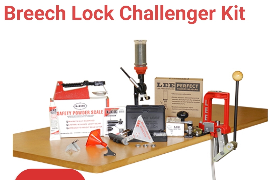

Post by Oldbloke » 05 Aug 2022, 6:31 pm
This is the best ammo you can buy. :thumbsup:
