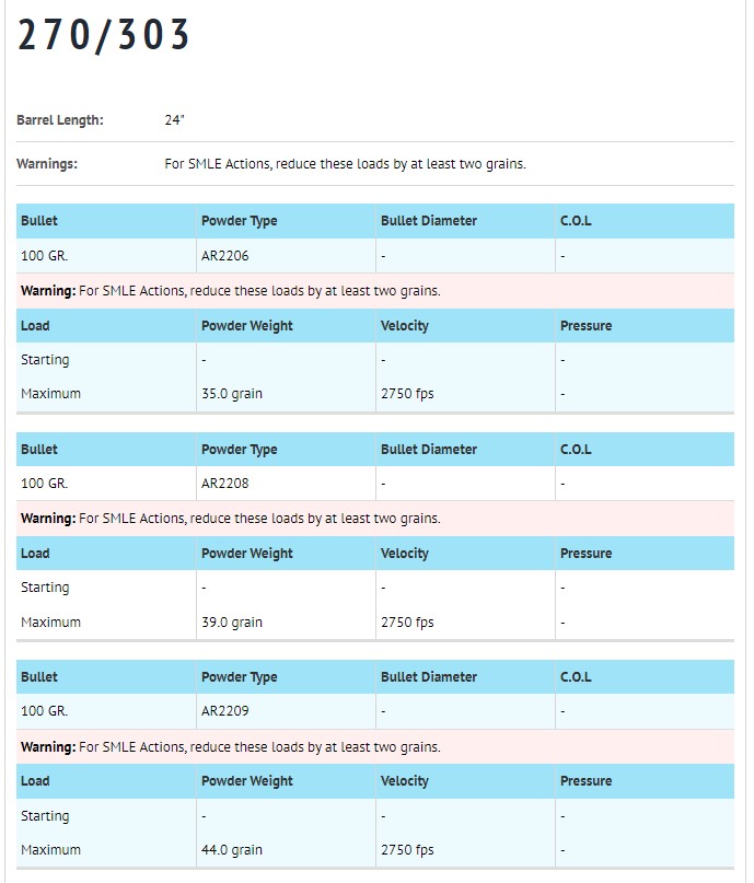

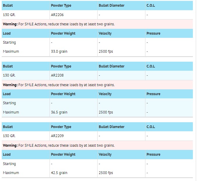

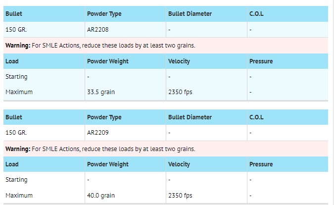

ADI do list some of their old data still, but not with AR2206H. ADI state that you can use AR2206H for any AR2206 load data though.
Note the warning to knock 2gn off these numbers in an SMLE. So 33gn with a 100gn bullet, or 31gn with a 130gn bullet. They don't list data for the 150gn but I would start with 29gn or 30gn.
ADI 303-270 100gn.jpg (97.2 KiB) Viewed 1561 times
ADI 303-270 130gn.jpg (78.64 KiB) Viewed 1561 times
ADI 303-270 150gn.jpg (52.54 KiB) Viewed 1561 times
