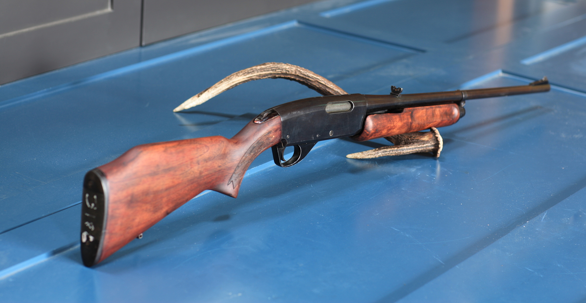

Post by SHV » 30 Nov 2022, 1:03 pm
another recent restoration project

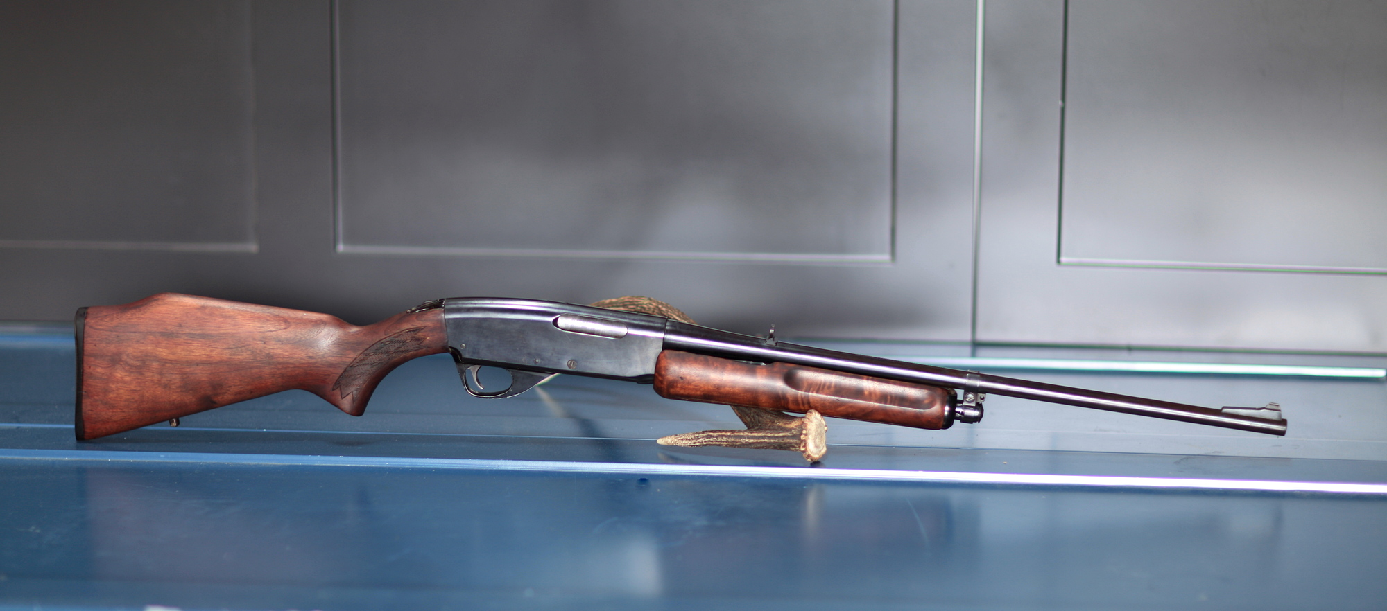

don't know why there is a 4 digital number on the butt plate

Post by Wm.Traynor » 30 Nov 2022, 2:12 pm
Nice looking rifle, SHV :) :thumbsup:

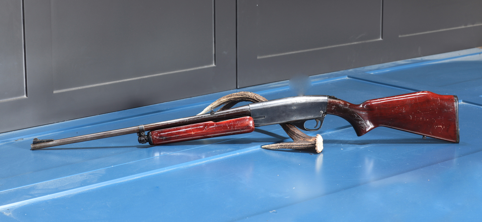

Did you blue the barrel?

yes, when I got it, the bluing on the receiver and barrel worn a lot, lucky the cold blue gel works good on this steel

I believe there a couple of ways of applying the cold blue. What was yours?

nothing special, just clean, apply and oil, some metal's really good, some not

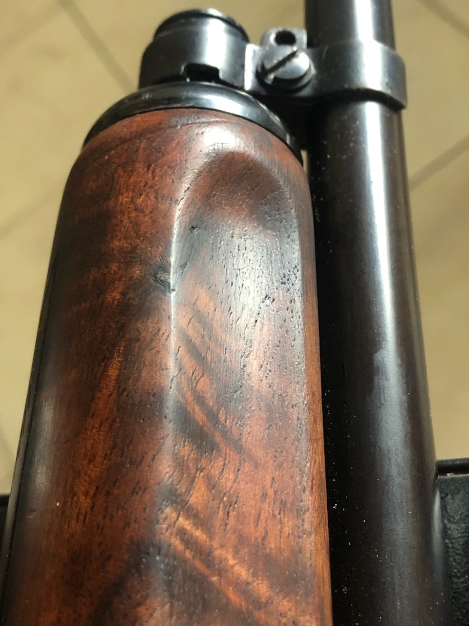

I did find a way to fix the stock imperfection using super glue and sawdust

Post by Oldbloke » 02 Dec 2022, 8:56 am
That's an interesting idea.
I have repaired a few stock dings using brown sealing wax. Come up ok.
I've heard that applying cold blue to a "hottish" barrel works really well.

Yes sometimes I use the heat gun to heat up the metal it helps
