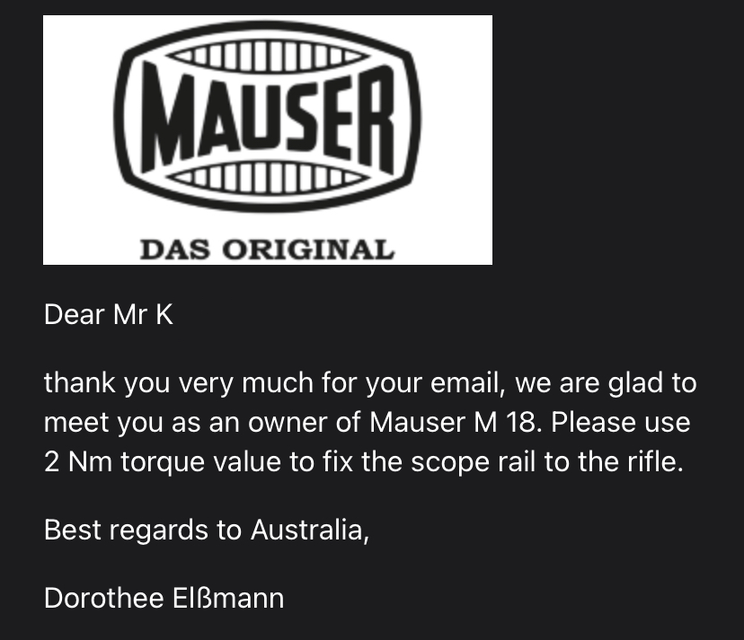

G’day everyone
Just putting this here for future reference for people. Recently bought an M18 in .308. Nothing in the manual about torque specs for anything, so I emailed Mauser direct.
Looks like it’s rated to 2nm of torque, which is roughly 17.7in/lb. This applies to all calibres of the rifle which I asked in a follow up email.
Cheers!

No worries, long time lurker, figured I should give back where I can! And yeah it sucks they don’t give out technical specs in the box, but their customer service is ace. I got another reply today regarding action screw torque.
If anyone stumbles across this, 5nm is the action screw torque for all models now.

The correct torque to use is governed by the size and type of screws used to mount the rail so you get it tight without exceeding the breaking strength of the screws and threads .

Talley mounts say they have a 6 x 48 screw for the mounts that fit a Mauser M18 . Torque for a 6 x 48 scope base screw is around 15 inch pounds (1.7 Nm ) if they have oil on them . Loctite 243 also acts like oil initially . 18 inch pound ( 2 Nm ) if they are dead dry which they should not be as they can rust in and seize . I knew a farmer once that put battery acid on his scope mounting screws to make them rust up and " NEVER " move again . Trouble was he asked me if I could put a new scope on his rifle and no way could I undo the screws . Then I found out about the battery acid trick . Ended up a new scope and new mounts and had to drill the heads off the base screw and then remove them with vice grips . Only use oil or Loctite 243 on the base screws . I never put Loctite on the ring cap screws or the dovetail claw screw .
