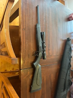

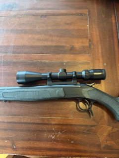

Post by Shootermick » 24 Mar 2023, 6:59 pm
Picked up my BA13 223 this week. Durasight one piece mount with a Vixen 3-12x40. Sighted it in this afternoon, 1” at 100. Extremely happy with the whole set up. Just what I was after.
Shootermick
Posts: 841
Re: Bergara BA 13
Post by Billo » 24 Mar 2023, 7:43 pm
Mick looks like a good result, not too low so you cant get your thumb under the ocular and onto the hammer :drinks:
Billo
Posts: 961
Re: Bergara BA 13
Post by Fionn » 24 Mar 2023, 7:52 pm
Billo wrote:Mick looks like a good result, not too low so you cant get your thumb under the ocular and onto the hammer :drinks:
They have side hammer extensions anyway.
Fionn
Posts: 622
