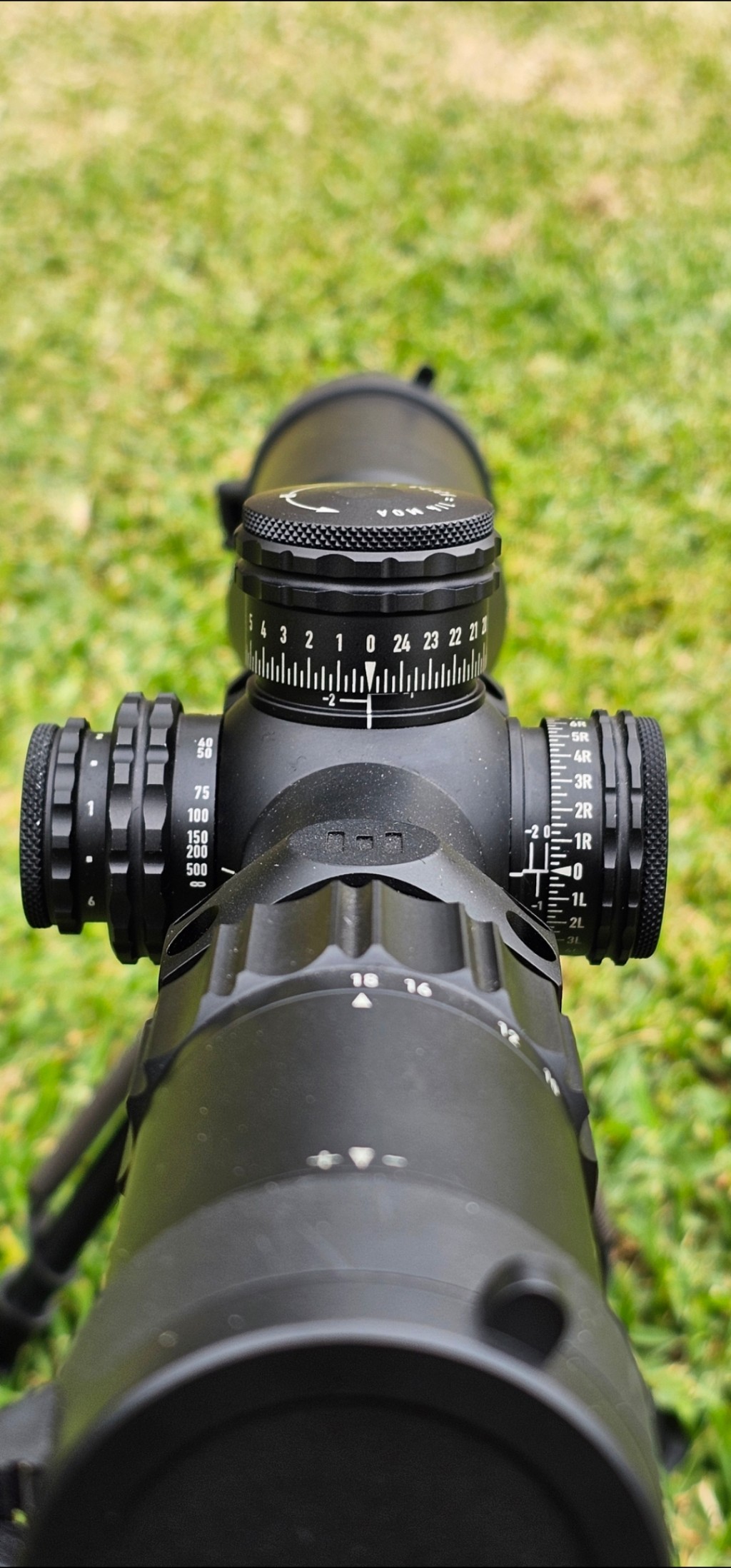

This is my pov pack 223 and I regularly use it out to 760y and it does a great job
It's a howa 1500 .
MDT oryx cheap at cleavers .
And an element titan 3-18x50 .
If you look around you should get it for around $2300 .
My experience with the titan and a bloke I know with 3 of them and shoots prs rimfire and center fire they are tough as nails and tracks as good as my nightforce.
