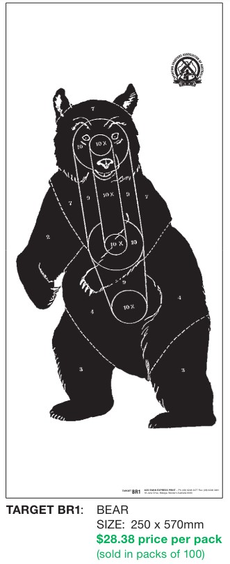

I found targets from https://www.acsswan.com.au/wp-content/uploads/2021/12/ACS-Target-Catalogue-2021-email.pdf which might be what they refer to - I didn't find the 13M slow fire pistol target or the centrefire field rifle target.
Screenshot 2024-05-14 151255.jpg (48.91 KiB) Viewed 18561 times
If this is the "small bear" then it's 250mm wide, and scaling it makes the 10X an oval 25mm wide and 140mm tall, as well as another 10X circle about 40mm diameter. So you would indeed want a sub-MoA rifle to put them all into the oval, or about 1.3MoA to go for the larger circle, that's tough for a lever I think. The two ten-zones though are about 65mm circles which seems challenging but achievable.

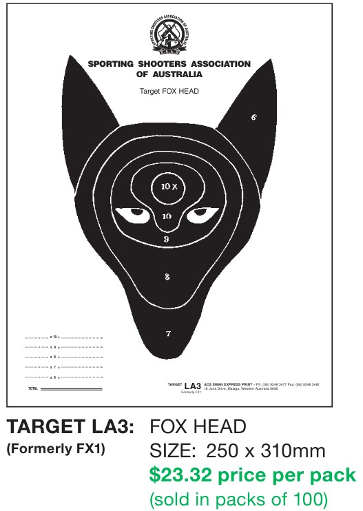

Screenshot 2024-05-14 152054.jpg (64.16 KiB) Viewed 18561 times
If this is the "fox head" then the X is about 30mm diameter and the 10-zone about 60mm wide, similarly challenging offhand at half the distance.
