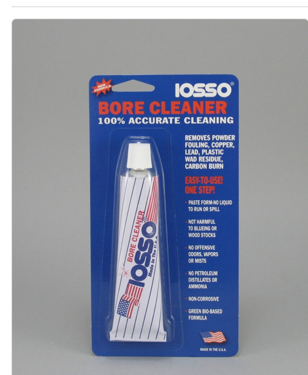

Post by Oldbloke » 17 Aug 2024, 12:38 pm
I use AR2208 exclusively in my rifles. Its hard work cleaning them. Carby cleaner seems best for carbon.
But just wondering if anyone uses this stuff. Comments on Web says it's very good.
Screenshot_20240812-230240_Samsung Internet.jpg (217.75 KiB) Viewed 15687 times
Not looking for suggestion. Just this cleaner.

Looks like it's got great reviews on the interwebs, you can't go wrong.

I use the other bore paste "J-B" not for any real reason other than the recommendations I got from other shooters at the time. I think it is a bit less abrasive than the Iosso. Great stuff for when you really want to get your gun clean back to a "Standard condition"

I have seen that cleaner getting about it seems quiet popular in the states, I have also thought about some of the heavy duty automotive sprays they use for intake manifolds to remove carbon build up, might try it out on a older .22 first, cant imagine it doing any damage really.

Solvents can't harm a barrel.
But this stuff is abrasive, so I'm a bit hesitant.
