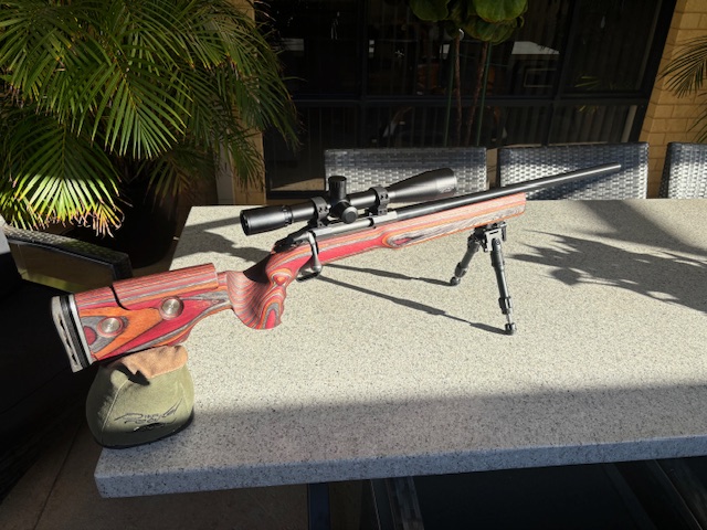

Post by Over The Hill » 01 Oct 2024, 9:18 pm
My T3X Varmint 223 has a GRS Hybrid stock that I use for bench shooting. It has a wide flat forend that sits firmly on the front rest bag and a long flat rear stock that slides level on the rear bag.. Adjustable LOP & Cheek Riser. This is a heavy stock and definitely not something you want to be carrying around in the field. It needed to be bedded to get the correct fit and is not a cheap option. Does it make the rifle shoot better, NO, but it does help me to shoot it better. Definitely improved my scores going from the std Tikka varmint stock. Pic shows fitted with bipod, need to remove the rail when using a front rest

Thanks, this reaffirms my line of thought. I doubt this rifle could shoot much better, but it'll be a lot more comfortable to shoot off a more stable and level platform.
The GRS is out of my price range but the field and xrs have a lot of the same features with relatively flat buttstocks, adjustable cheek risers and adjustable length of pull.

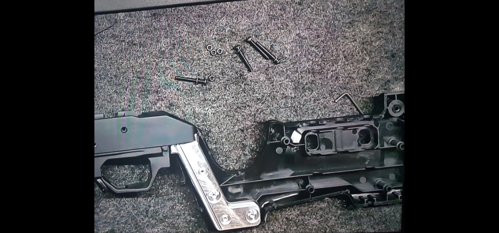

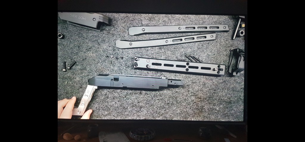

Post by deye243 » 02 Oct 2024, 4:48 pm
The problem with the chassis you're talking about is the actual lack of weight these pics are for a XRS and as you can tell mostly plastic
if you are looking to add weight and stability to your Target Rifle I would be grabbing one of the aluminium type chassis and unfortunately there is no such thing as a cheap one.
