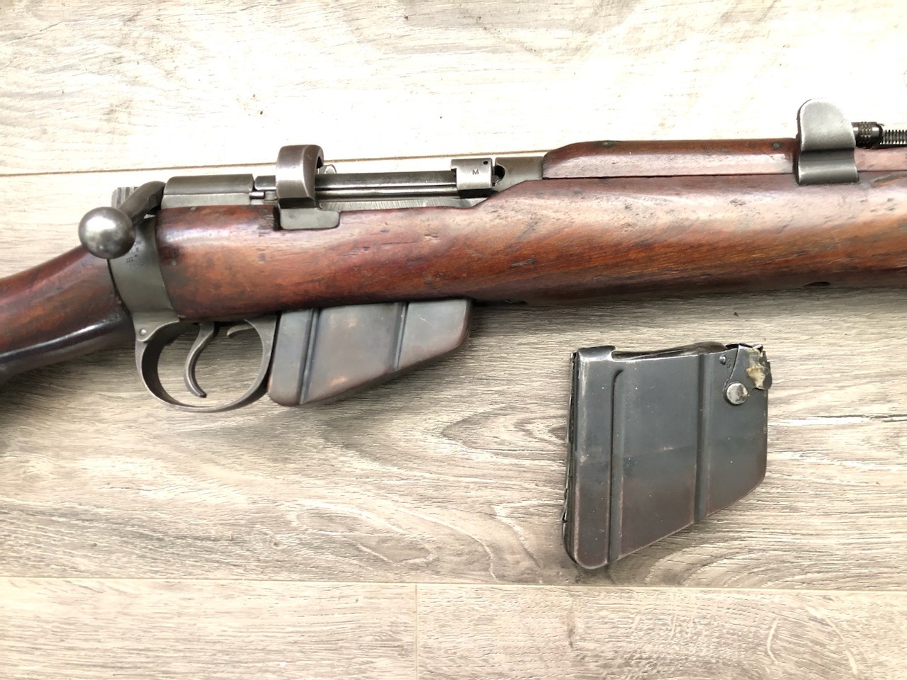

Post by SHV » 08 Nov 2024, 9:51 am
Got a rifle and find out the mag there is something special

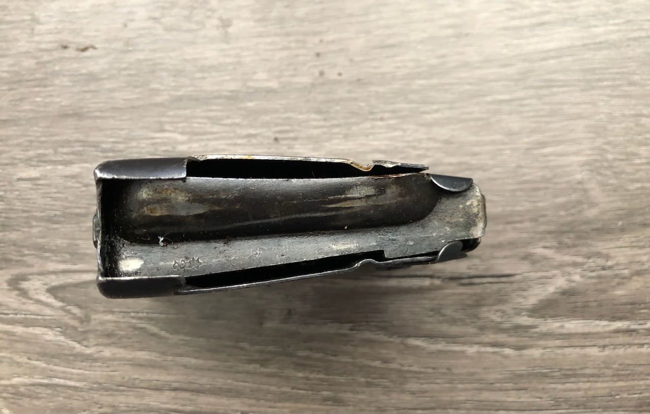

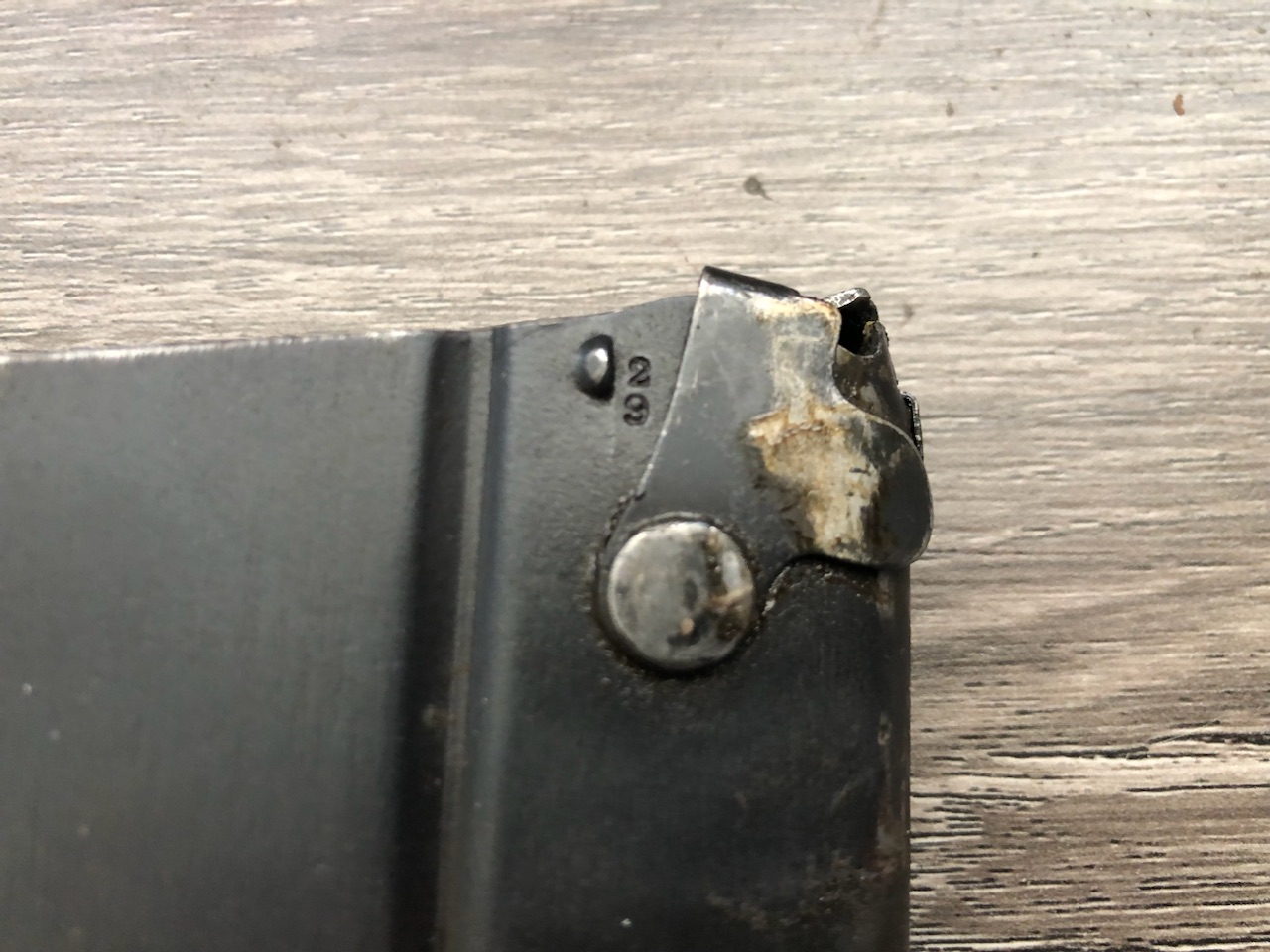

Re: A weird mag or a weird fix? Lee Enfield No.1 MKIII
Post by SHV » 08 Nov 2024, 9:55 am
Some interesting details other mag does not have besides the weird fix

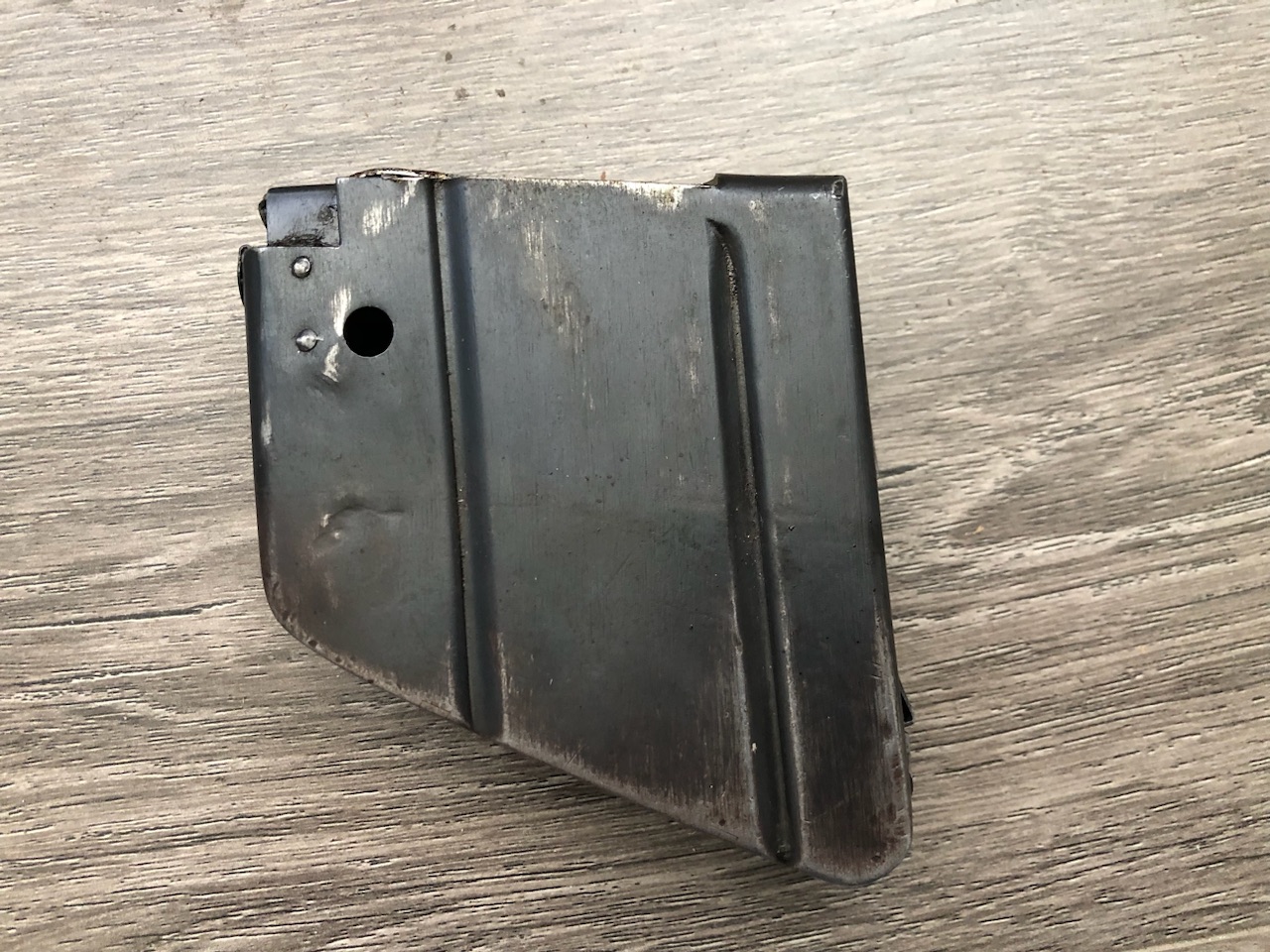

Post by SHV » 08 Nov 2024, 9:58 am
Both (normal and weird one)fit the rifle nice and tight

Post by bladeracer » 08 Nov 2024, 12:54 pm
I am no expert but I think that was the modification from when they switched to the MarkVII bullet from the old round-nose bullet. As it doesn't have the lanyard loop I think that makes it a Type 3 magazine.
Post by No1Mk3 » 08 Nov 2024, 1:54 pm
What's wierd? Looks to be a normal post-1905 Magazine No 3 for the SMLE Mk1*, movable lip on the right and should have had the fixed lip on the left which has been removed.
Post by No1Mk3 » 08 Nov 2024, 1:59 pm
2 bloody edits to my post for F;s sake! need to get better sleep, post 1905 with the retaining loop removed and case modified Case No 2 with the rivetted spring retainer to Case No 3 specs as bladeracer pointed out..
Post by No1Mk3 » 08 Nov 2024, 2:01 pm
Have a look on the rear of the case under the spring to see if it is still numbered 2 or has been re-stamped as 3, most converted cases were not changed but I have 1 that was.
Post by No1Mk3 » 08 Nov 2024, 2:13 pm
Has Platform No 2 which is std for Case No 3,
