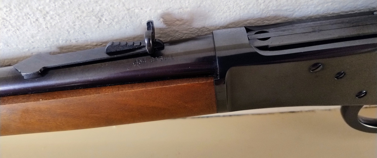

Post by mickb » 04 Feb 2025, 5:26 pm
Fairly random luck, was mulling over a new gun and found one going for private sale for at or around what they came in for. I recall around 2015 or so some were being advertised by Cleavers and a few other shops, which is the vintage of this gun - some old bloke bought it to match a 454 revolver he had, about 40 rounds of the rossi is all he fired.
Its the later generation offering I think with the beefed up magazine tube, second load gate on the tube, and I believe these were also threaded into the reciever for more strength. Is it just me or does the stock look thicker and more reinforced than a regular rossi 92 too? . Sellers photos, still waiting for it to arrive.
Grain doesnt look to bad, the old brazilian rubberwood tree can be a bit hit and miss for appearances. :)

Post by Billo » 04 Feb 2025, 7:39 pm
I do love a bit of Brazilian Walnut, yes the timber looks a little thicker than normal, good find mickb, seems reasonably priced considering new they are $1144 new from Safari when in stock.

Post by mickb » 04 Feb 2025, 8:14 pm
Thanks Billo. Seems to be enough components around to have a play.

Post by Obie73 » 04 Feb 2025, 9:43 pm
Looks beautiful! I'm sure it will be a lot of fun to shoot.

Post by mickb » 14 Feb 2025, 10:34 pm
Blr243 wrote:Sounds like u have decided on a 454 casul. Lever ? What model and make ?
Hi mate its the one in the top pic. Rossi 92, 2015 era, the latest generation.
