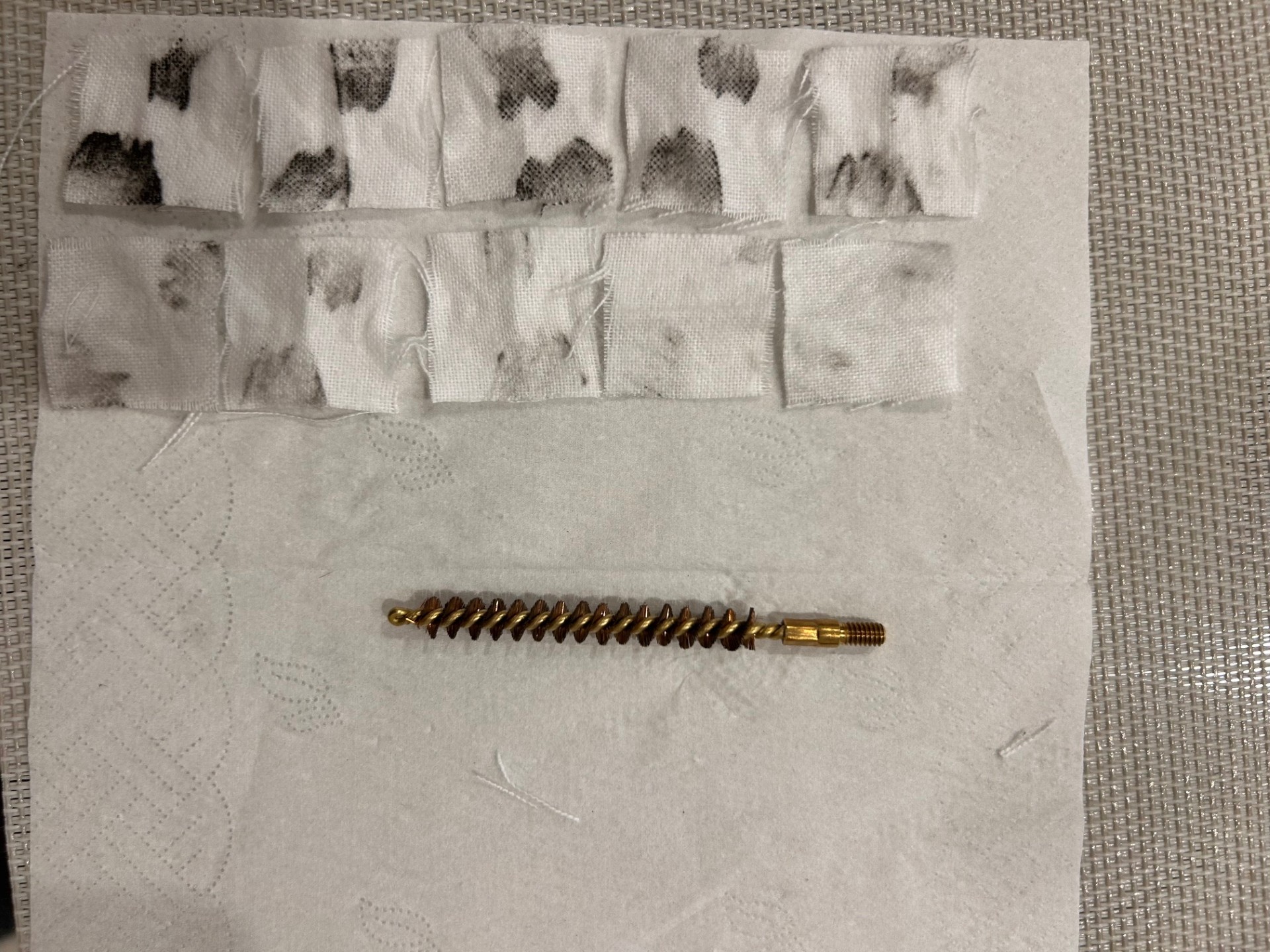

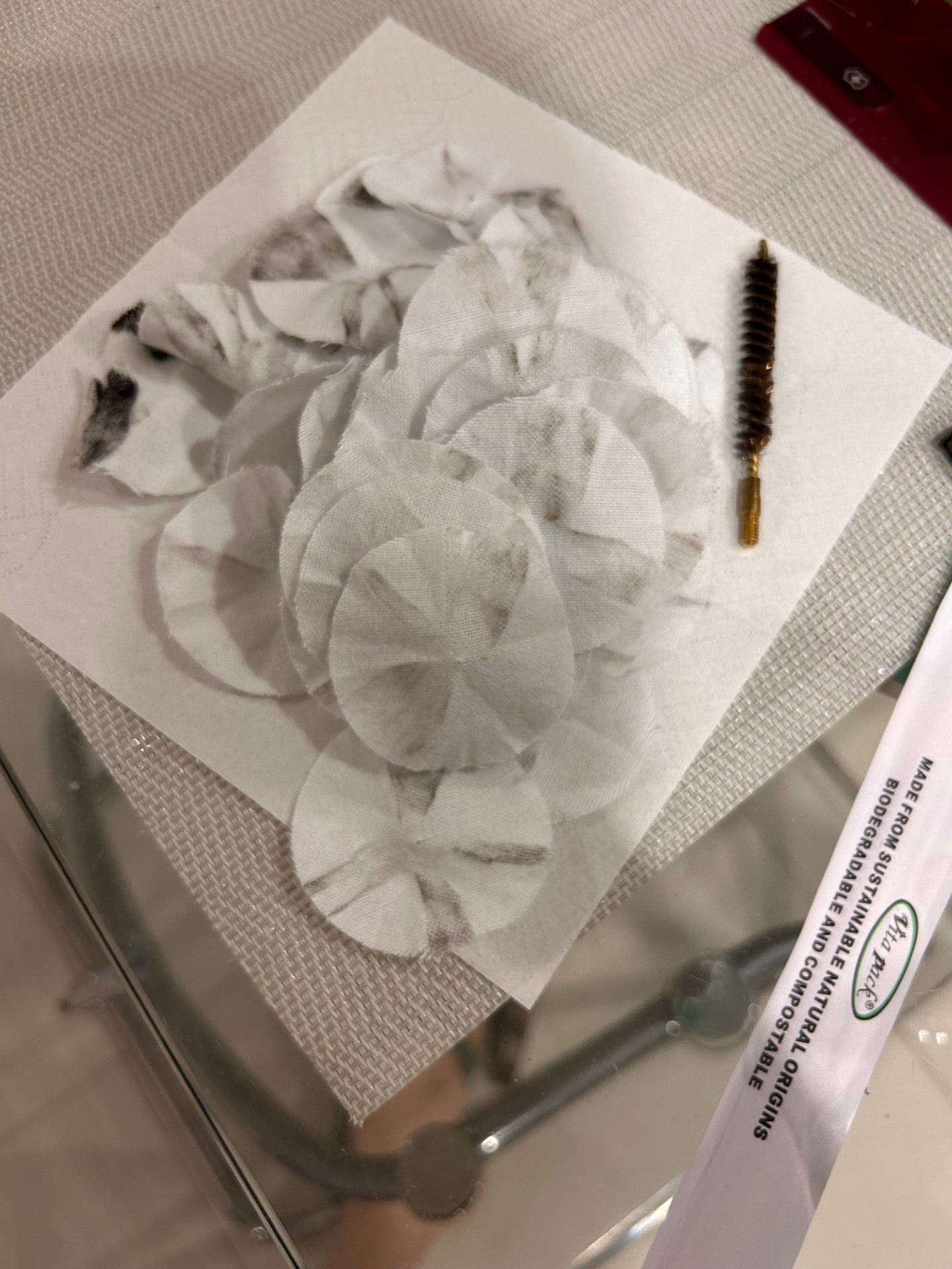

For reference, after firing 15 rounds through my Swedish Mauser, it took about 10 dry patches before they stopped coming out noticeably dirty.
I used 40+ dry patches on my Lee-Enfield…no idea why, as I only fired about 20 rounds. should not be so dirty!

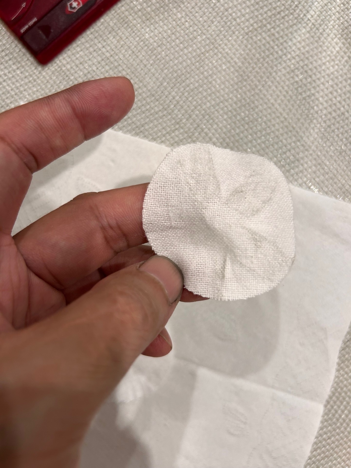

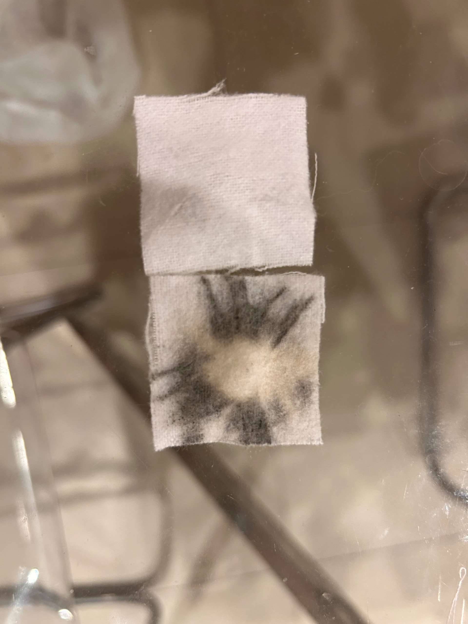

After normal solvent cleaning and dry patching, the bore appeared clean. A subsequent light oil patch came out noticeably dark.
I’m assuming this is oil lifting remaining staining or embedded fouling rather than loose carbon. Would most of you just finish with a final dry patch and leave it at that?
