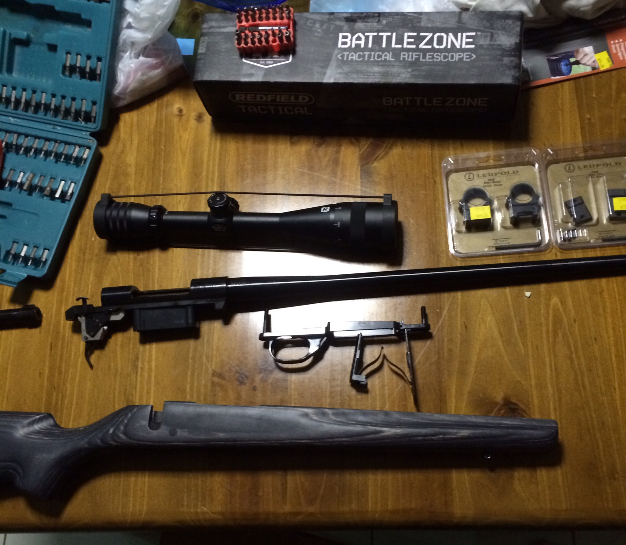

So all the bits and pieces for my new feral cat smasher have come in and got assembled last night. Ended up getting a sporter barrel because there was a 3 month wait for the varmint barrels.
The boyds stock fitter in nicely with the exception of having to shave the barrel channel out 2mm to properly free float it. Also had to take 2-3mm off the front side of the groove that the bolt handle slots into when closed. Nothing too serious for a $100 stock and from what I hear is pretty common.
I put a 6-18 redfield battle zone on it and can't complain at all.

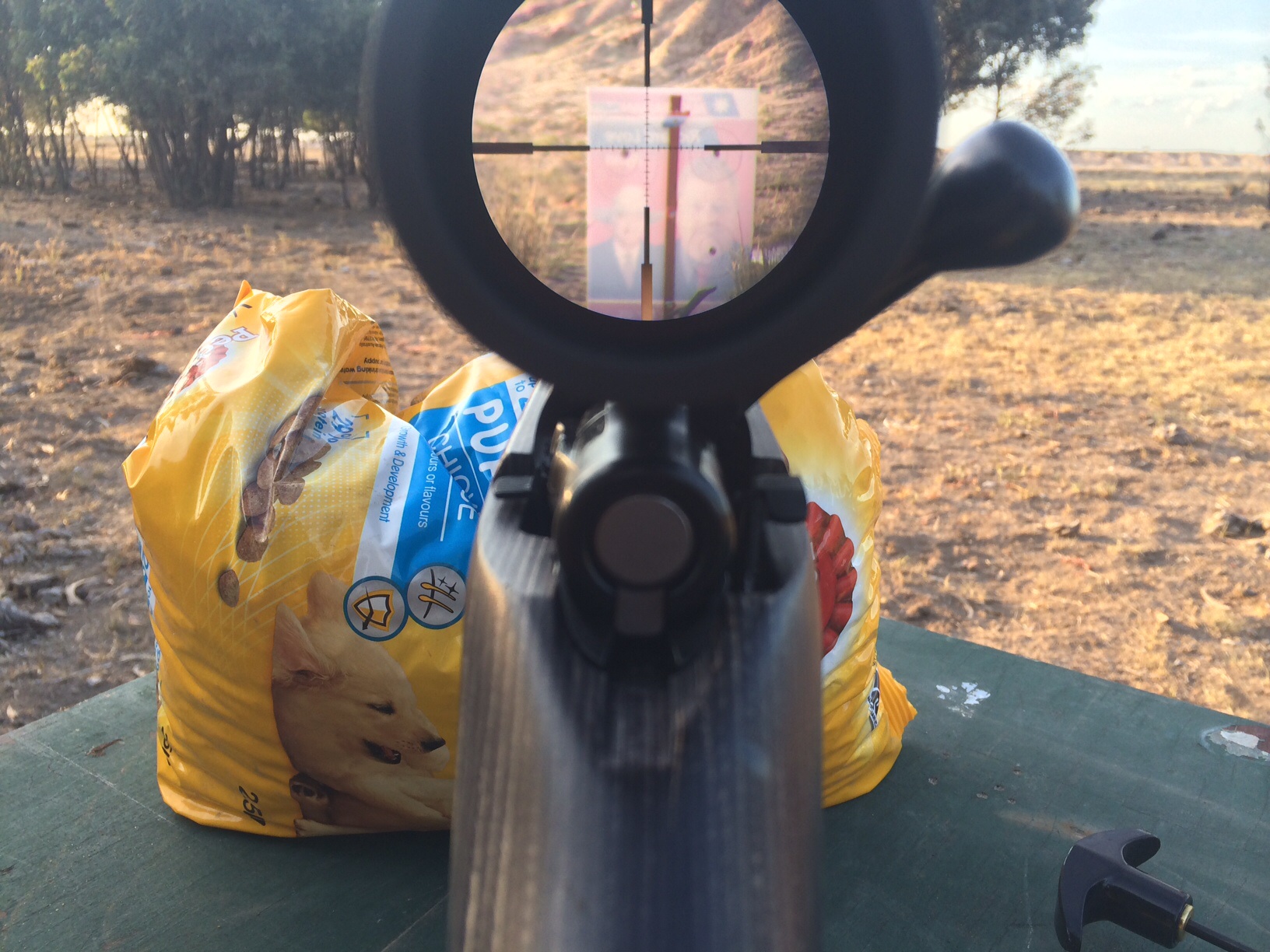

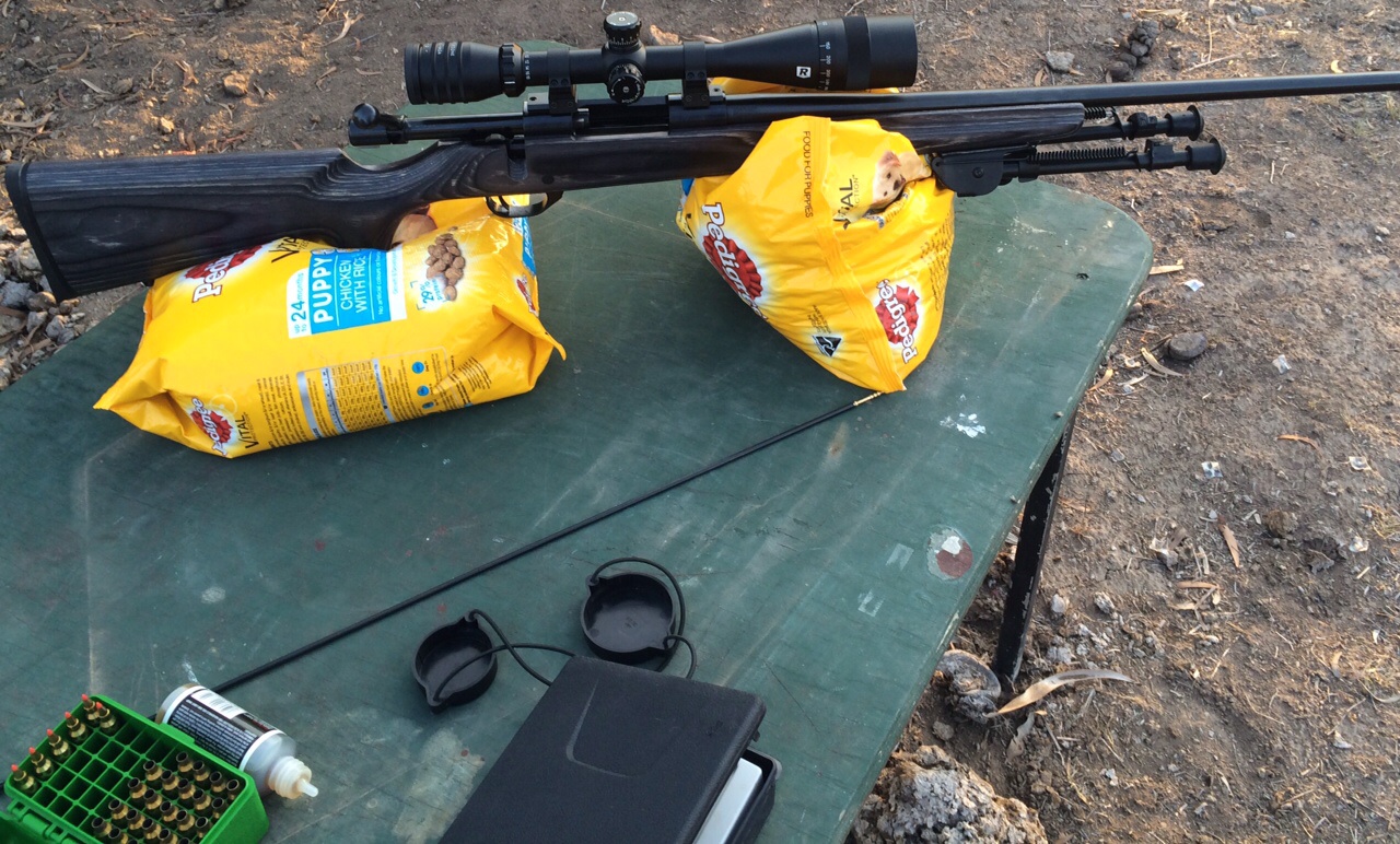

Took it out to the farm to sight it in and managed to improvise things pretty well with what I had.
Made up the targets with a nicko on old election campaign posters that I use for the .22
Bipod wasn't stable enough so I used two bags of dog food as a rest
And in the excitement wasn't waiting long enough between shots for the barrel to cool
Despite all that I managed to get it shooting 3 rounds in a 50 cent piece and when it finally cooled down just a bit wider then a 10cent with two holes touching!
Not complaint at all considering they were only 32gn hornady factory loads.

Post by Combat_Wombat » 08 Nov 2014, 9:39 pm
Pedigree shooting rest "the best a mutt can get"

Post by Combat_Wombat » 08 Nov 2014, 9:41 pm
If you look closely you will see old mate Bob Katter

Post by Combat_Wombat » 12 Nov 2014, 3:03 pm
Joom wrote:Never thought of the kibble bags.... Going to try it.
I was supprised by how well it worked actually much steadier then the bipod
