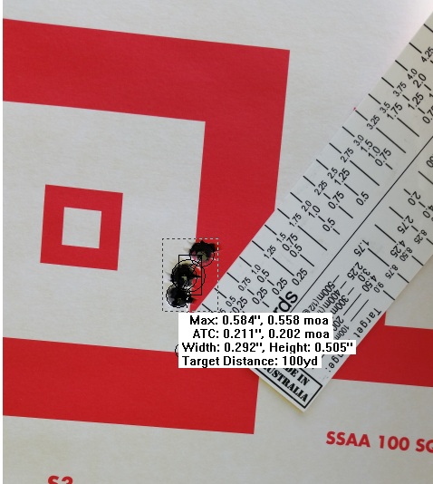

Post by 6mmdasher » 26 Apr 2015, 8:20 pm
I bought a savage axis in 30/06 just for the action to make a 257 ackerly imp. I decided to shoot a couple of rounds through the 30/06 barrel to get a couple of cases to use to headspace the 30/06 barrel incase I decided to put it back into the action. i was very surprised to find that they all went into a very small group @ 50 yds using the package 3-9 bushnell scope supplied ! With the Maddco 257 ack barrel they all go throuh the same hole @ 100yds. I did free float the barrel in the poxy plastic stock in the Mil and work the trigger a bit!
