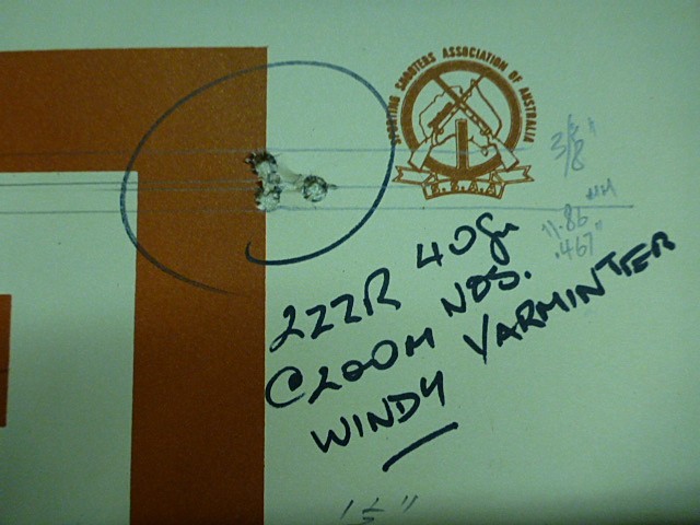

I took my little 222R out to the range on Wed with a load of 22.5gn 2207 and 40gn Nosler Ballistic Tip bullets. I fired a group at 100m and though it was pretty good then fired another at 200m at impressed myself. It was pretty windy but the group stayed consistent. We had previously chrony'd that load at a bit over 3,400fps. Anyhow I was pretty happy with that from :clap: a 20inch barrel not much bigger than a bloody drinking straw.

Yeah I love my 222's too, it really is one of those cartridges that is just a pleasure to shoot, they are usually accurate, SFA recoil, noise is tolerable and it can kill very well when used correctly. My first CF rifle was a 222 and I still own it.

Nice one mate, what sort of scope were you using and how much prep work on the cases etc?
Re: 222Rem rides again
Post by headspace » 21 May 2015, 9:37 pm
G'day Scott, I just neck size the cases with a Lee Collet, clean the primer pockets and chamfer the neck once only. I also run a drill through the flash holes to make sure there are no burrs the scope is a 4-12x43 Vortex Crossfire11. I use mainly all Winchester brass, but I've also got some Hornady which I keep separate. I noticed the Hornady cases weighed out a couple of grains heavier than the Winchester.
