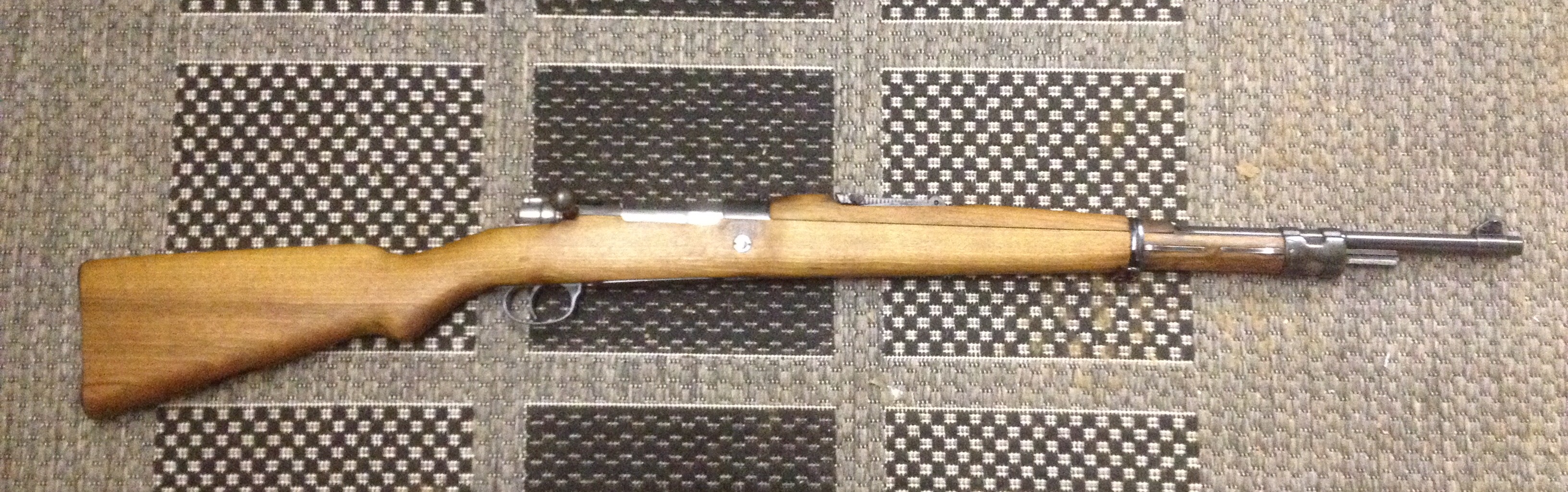

Here is a pic of the fn 1950 Belgian Mauser I own, factory barrelled in 30-06 and fairly rare

Supaduke wrote:Here is a pic of the fn 1950 Belgian Mauser I own, factory barrelled in 30-06 and fairly rare
Nice :D
Yelp
Posts: 223
Re: A question about columbian mausers
Post by OODAH » 19 Jan 2016, 12:07 pm
Great looking old Rifle, I feel it needs a rustic looking leather strap as a sling.
Post by ebr love » 19 Jan 2016, 3:14 pm
Yeah that's nice.

Post by No1Mk3 » 19 Jan 2016, 4:16 pm
G'day Supaduke,
Is your rifle "L" crest or "B" crest? I have the same rifle in a Congolese "FP" crest, Cheers.
