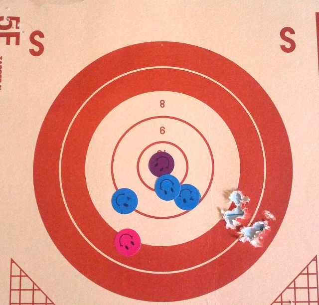

1st 5 shots with PPU 243w at 100yds. 90g SP (it's the group at 4 o'clock..) :clap:
