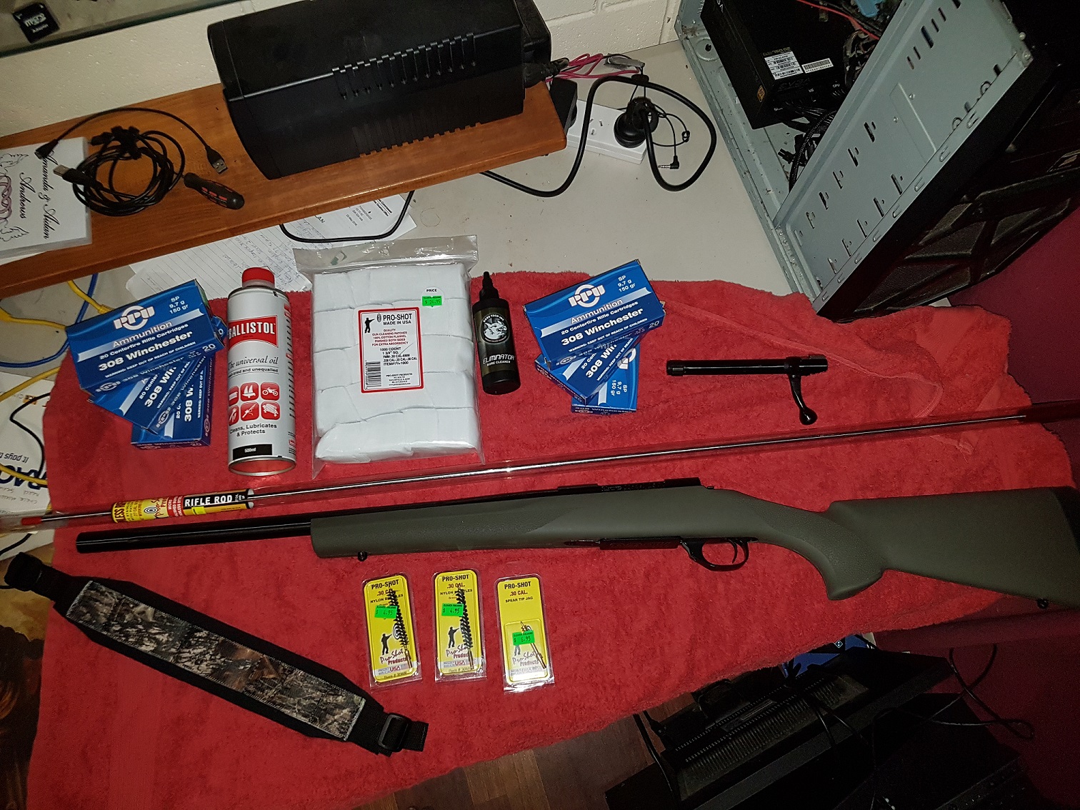

Well finally got my new toy and some cleaning accessories to start me off
Howa
range time yet lol
start of obsession.jpg (694.82 KiB) Viewed 7269 times
Thanks to everyone for helping out with decision, gonna watch some youtube on how to clean to rifle and hopefully shoot it this weekend :)
only issue i can think of though is they didnt have any bronze brushes in stock...will i need to use one before firing or cleaning with patches ok?
Happy mongrel :drinks:

It's a HOWA mate, so I'd go so far as to say no.
Just a quick wipe thru with a patch and solvent to get rid of any oil etc.
Then mop till dry and clear.
You won't regret getting a Howa. :thumbsup:

Cheers Die, by solvent do u mean boretech "Eliminator" bore cleaner? coz thats all i got besides Ballistol?
Also do i need to clean out the action, bolt and exterior before use aswel?

I wouldn't stress about the exterior or the bolt as long as you clean out the chamber and bore main reason is if there is exess oil from storage and you don't clean and swab it out you could end up with at best nothing wrong but at worst a bulged bore or even a catastrophic failure depending on how much oil/grease is in the bore. Bolt and exterior small issue. Ensure the chamber is clean and free of an oil at all as oil in the chamber puts excess stress on the bolt as the casings can't grip the chamber walls during firing. Happy Shooting..
