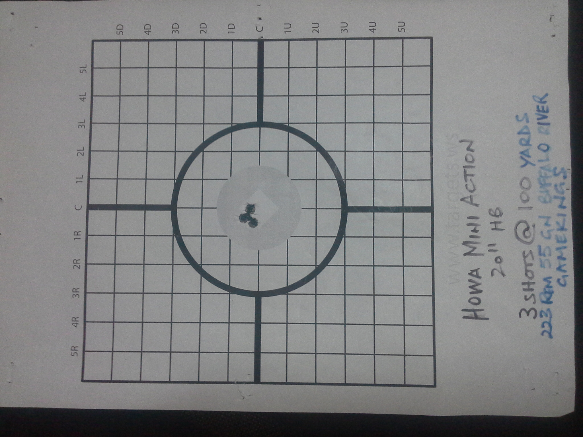

Post by southwest shooter » 02 Jul 2016, 9:30 am
Never broke this barrel in imagine how it would shoot if I did ! :sarcasm:
