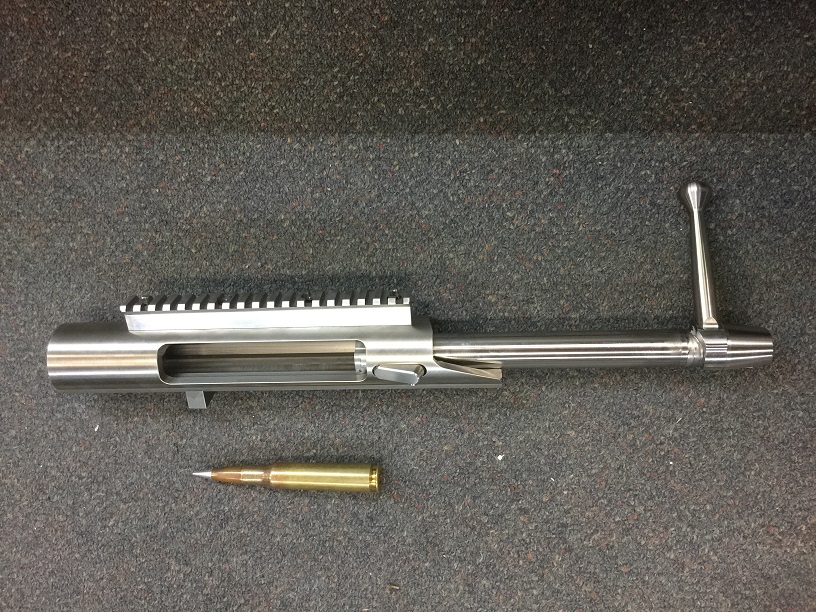

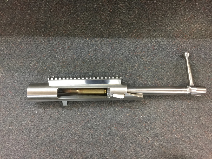

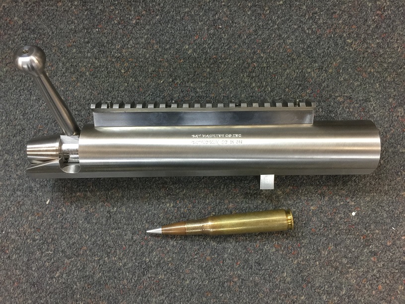

Like any thread making claims, it's all BS without pictures :)
That's a 50BMG round I used to show scale :)

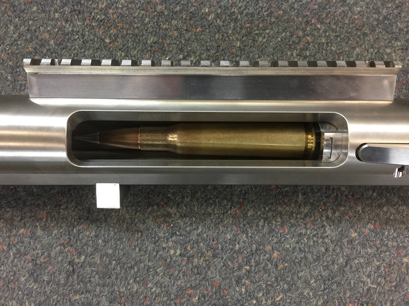

Action 1
Action 2
10.5" of bolt
Action 3
Action 4
This is a monster and just on 15kg on its own.

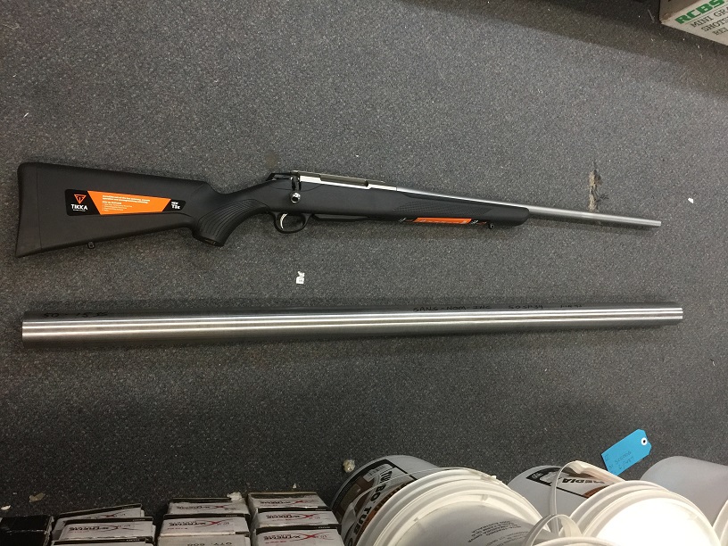

Barrel next to Tikka T3 for scale

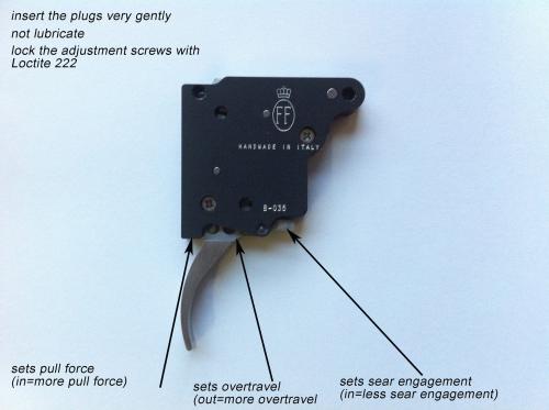

Difficult to locate much detail on the trigger other then it has 5 bearings and is considered the Ferrari of triggers.
Best pic I could find of the trigger
1Flavio Fare Trigger adj.jpg (18.86 KiB) Viewed 10635 times

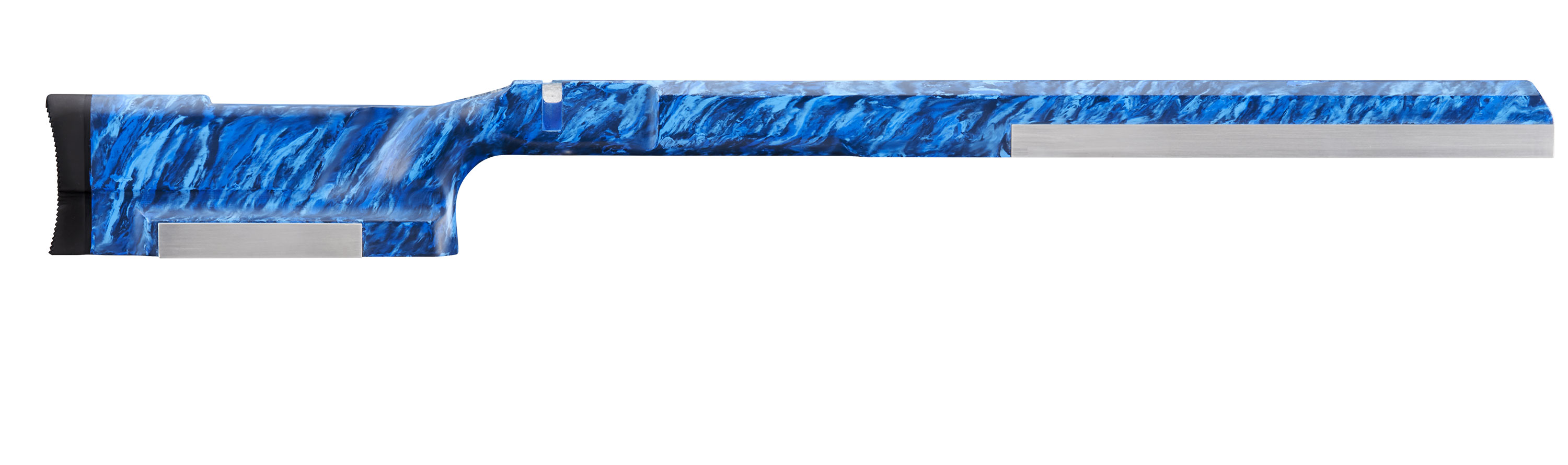

My colour choice was Urban Spectre, not the blue in the picture.I'm not sure if I'll Cerakote the barrel or action light grey to match yet.
Photo from McMillan site

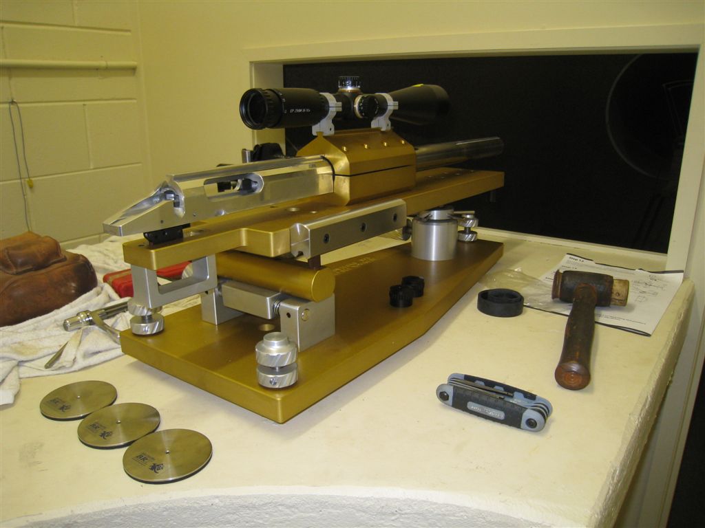

Same idea but this is a Rail Gun, take away the frame and sub a stock. The barrel block isn't quite as big, like half this used in a benchrest stock.
Picture 848.jpg (90.43 KiB) Viewed 10381 times

Post by Apollo » 21 Sep 2016, 10:37 pm
Another version but still not what I have in mind, I'll find a typical Benchrest Rifle with Barrel Block at some stage. This one I believe was used at a 500m Fly Shoot, Heavy Gun at Canberra.

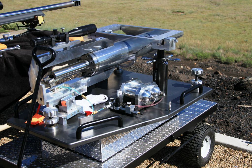

Check this high tech rig out....hydraulically actuated trigger and built on its own trailer...Not sure about the rest of it but it certainly looks impressive.
