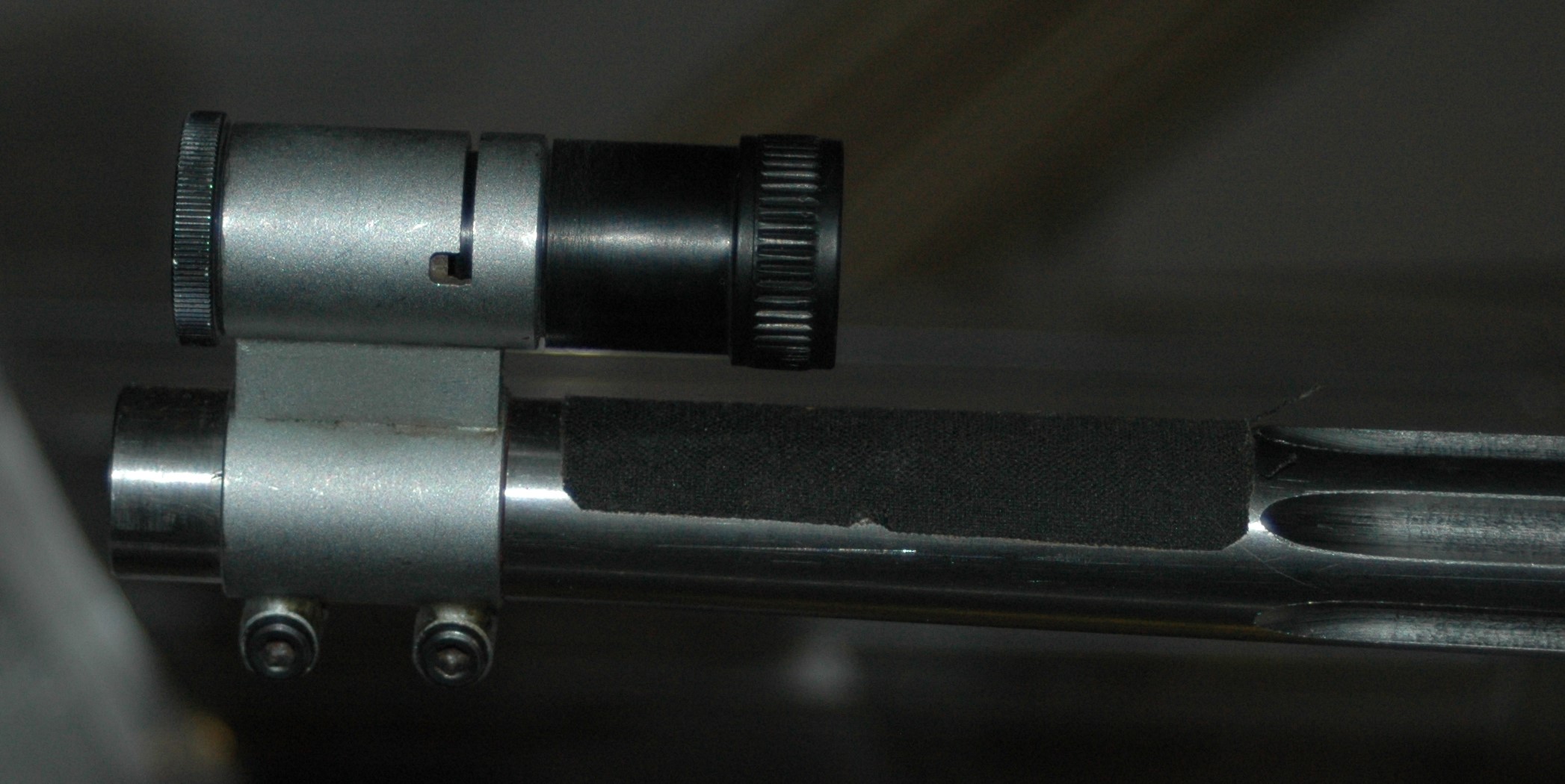

Whose front sight does it have?
Are inserts available?
Whose stock does it have?

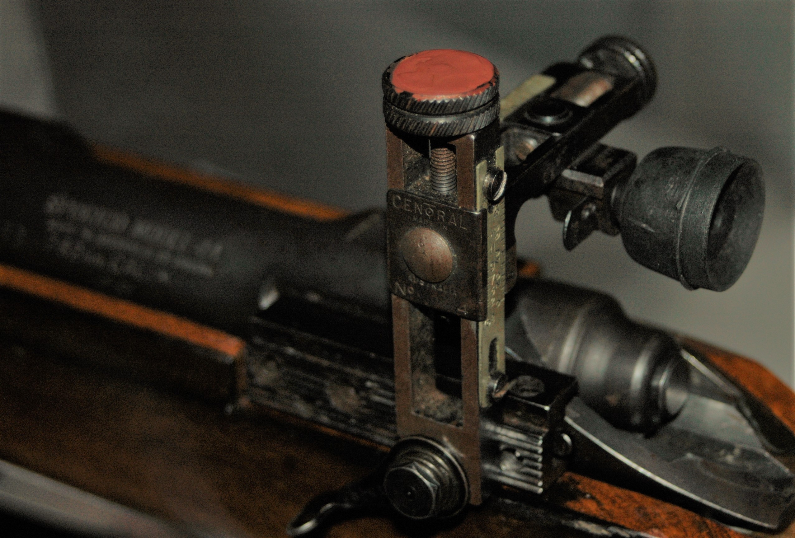

It has a Central Rear Sight, not sure of its Providence.

Back to the front sight. Both ends unscrew. The front piece has a lens, the rear piece locks the insert. Any idea if that type was made for the Sportco or an aftermarket type. Where would I measure for the insert size?

Your poor Central is in bad nick. I have never seen rust like that. There should be experts here who can tell you how to proceed but above all, don't wind the knobs in case the rust enters the elevation and windage nuts. In the meantime, hose it with G96 and just let it soak.
Fore sight tunnel
I am wondering how good the tunnel looks through the peep. Does the "knurled edge" of the tube that is screwed in to the tunnel-mount, look precise enough through the peep? In some cases it might be sharp, depending on your eyesight. Mine had a "plain" circumference and was a bit fuzzy but speaking for myself only, I think yours might give me a problem with centreing it in the peep. I keep wondering if the front and rear tubes should be exchanged, one for the other: swapped around, that is :)
If you are not experienced, choosing a fore sight element will be a Herculean task, especially if you need an Eagle Eye and a corrective lens, like I did but Good Luck and let us know how you go.

Front sight looks like an Anshutz 18mm. It will be easy to get elements or a modern variable iris to fit.

Measured the Front sight. The dia of the piece that holds the insert in place is .590" or 15mm which appears to be Parker Hale dimensions. Have ordered a set of inserts.
Does Shooting Industries Australia still repair Central Sights ?
I found another # 4 sight that I had bought some time back. It is in pretty good shape.

One other item of interest. There is a small lens screwed into the Central sight. Combined with the lens in the Front sight it appears to magnify the target.

re S I A http://www.shootingindustriesautralia.c ... epairs.php According to that page they fix Centrals.
The tunnel. Never heard of a Commercial lens in a P-H tunnel but I am no expert, so there could be an Eagle Eye in there somewhere. You say that "Combined" with the lens in the rear sight, that the target is magnified. Therefore you tried it Without the rear lens. Is that right? If so, you have a simple telescope. Someone has been Very, Very, Naughty :shock:

I will be sending the # 4 sight to Shooting Industries for refurb. I have a spare # 4 that I acquired a year ago that I will use till I get the one that came with the rifle back. Yes someone has been a naughty person, building a telescope into the sights. It will be interesting to test with and without the lenses in various configurations. But at my age, with my eyes, I need every advantage I can get.

I am guessing what you have there in your aperture sights is an 'Eagle Eye' enhancer. You can buy these add-ons and many (older?) shooters use them. Legitimate in competition these days? Worth a Google...
