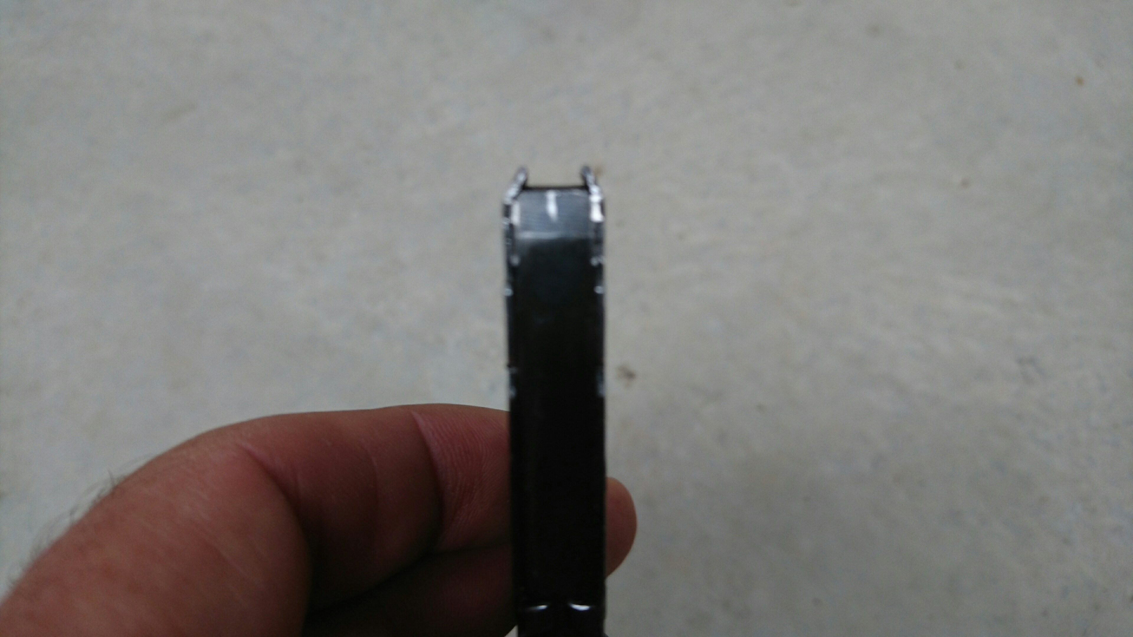

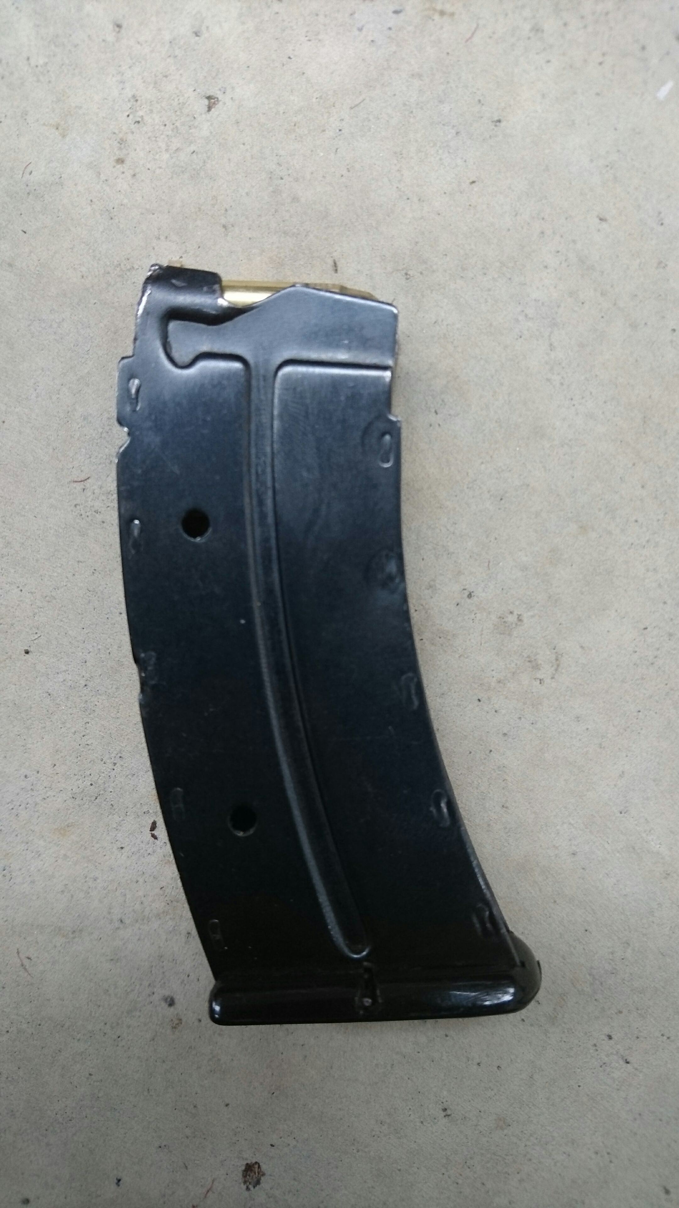

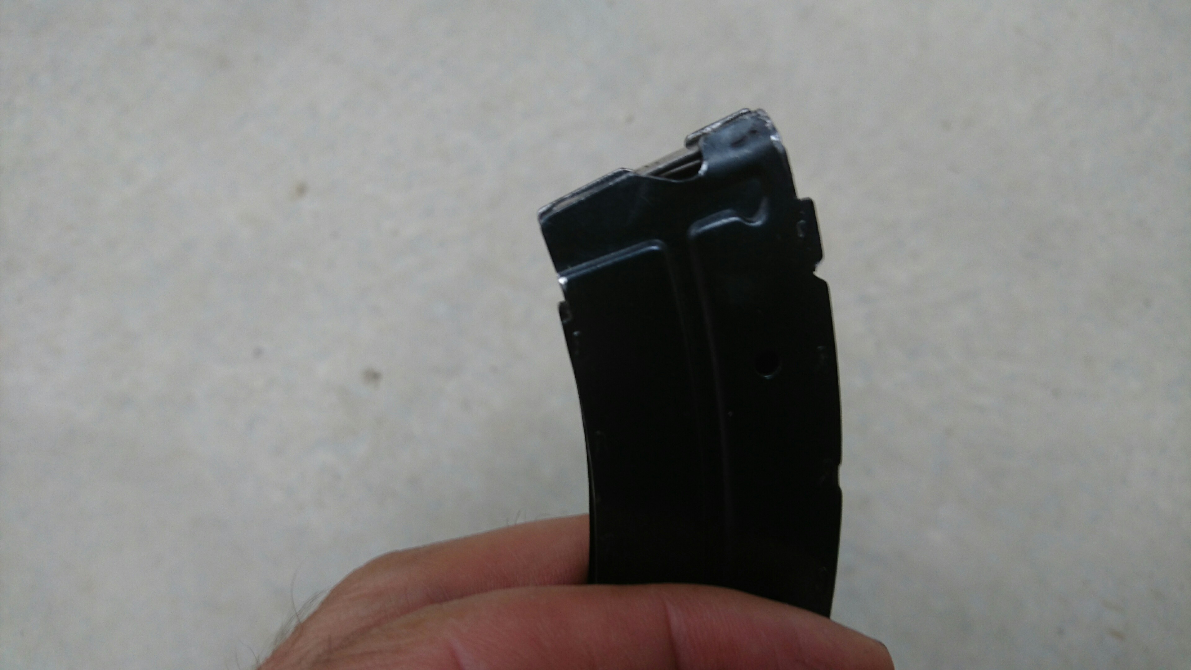

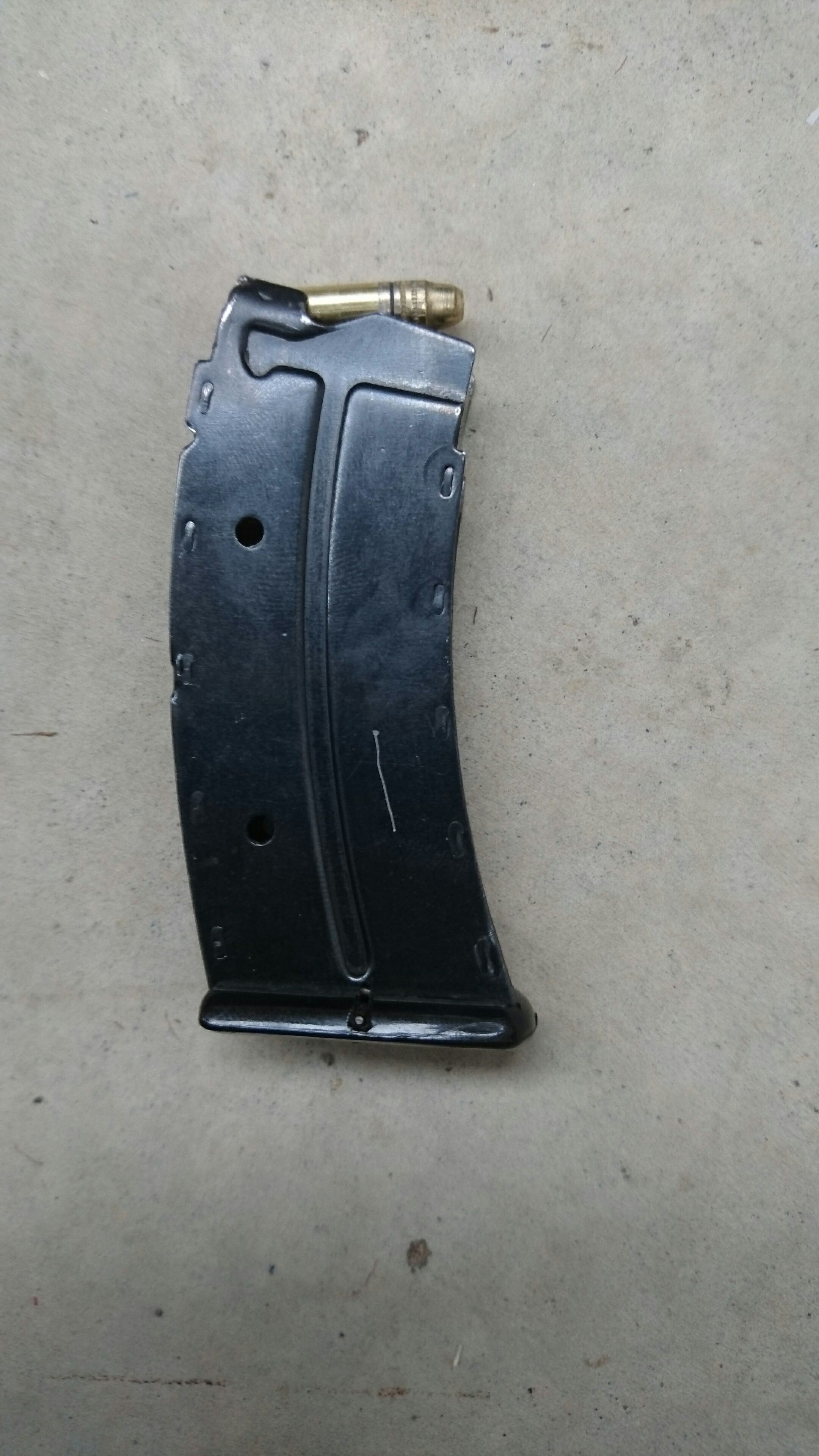

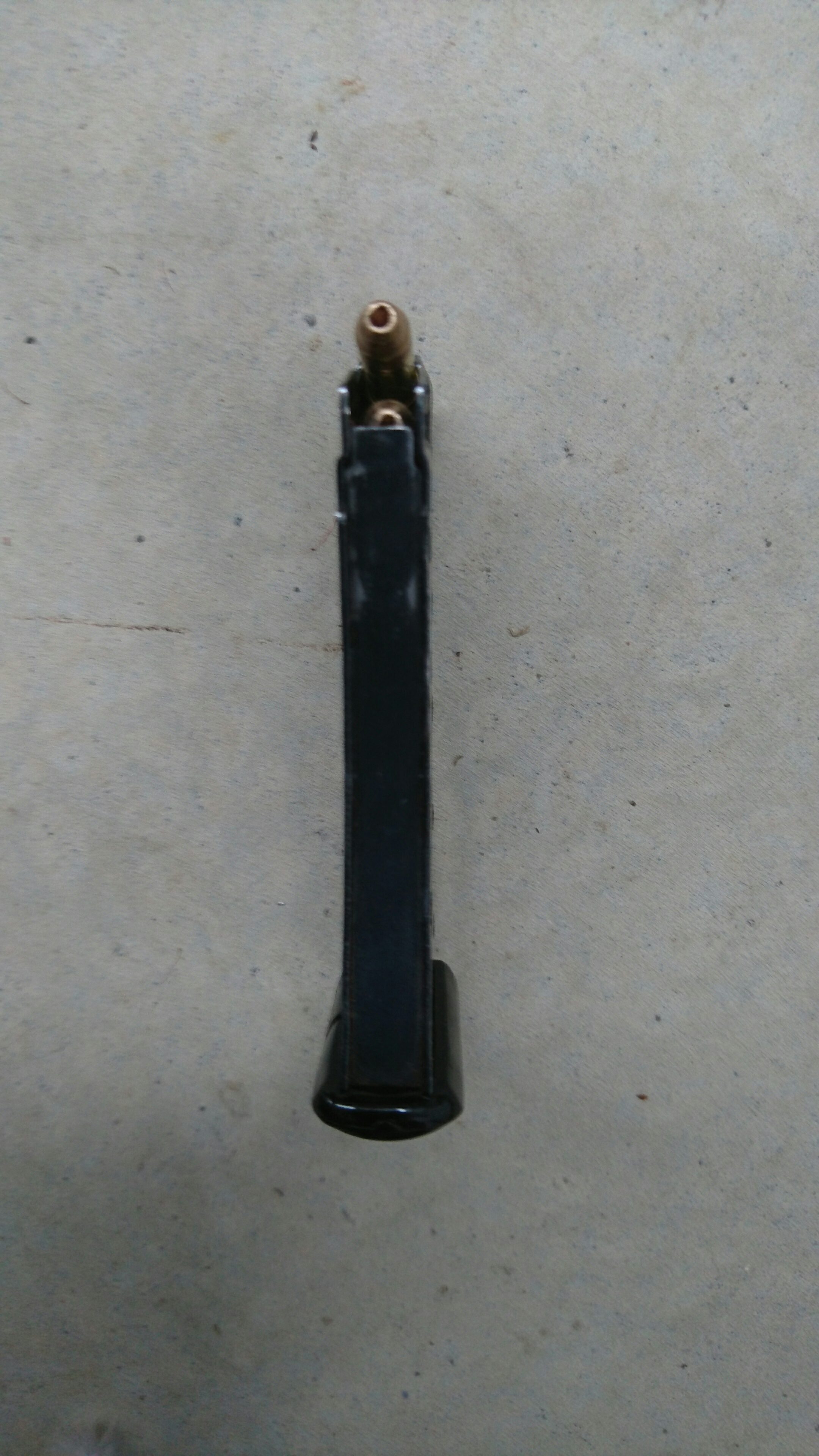

Just picked up another addition, a much loved and slightly abused anschutz model 1450 in 22lr. This girl has had a few boxes pushed down her throat but still shows plenty of potential. It's in desperate need of a new magazine due to feeding issues that would be intolerable if not fixed. For the time being at least I am intending to stay with the open sights. The first sequenced step on the rear sight is pretty much dead on at 35, but the front bead covers a lot of the target beyond that. Maybe I need to go to a hold under sight picture? I haven't shot with open sights for years........

It's a feed problem. Eject is fine. There are two problems occurring. 1) projectile end of the round tends to sit high in the magazine and then catches on the throat of the chamber, (2) with the magazine in, if it's not sitting right, sometimes the bolt face hangs up at the rear edge of the mag, this doesn't happen as much as the first fault. With the mag out the bolt cycles flawlessly.
There are some tool marks on the lips of the magazine which tells me someone fiddled with it before.......

A few pics, you can see in the first couple that the mag has been fiddled with. The second d to last photo shows the top round sitting flush in the magazine. The other photos show the top round sitting high.

Thoroughly recommend this - I do a bit of rimfire silhouette myself and it's SO much fun! The targets are bloody small though - I think the chickens are about 2.5" across at 40m, and they're among the easiest. So much more exciting than the olde ISSF style prone. Outside of the scoped rifles, we use a BSA 12/15 with Parker Hales and we are very grateful of that front globe.
Getting back to your feed issue, so the rounds hit above the chamber? Have you tried bending the magazine follower slightly to get em to point down a bit? Had a similar problem my Lithy.

Post by Bent Arrow » 21 Apr 2017, 12:17 am
Yes, when the round is sticking up it gets pushed forward too high and connects above the chamber. I haven't tried to fix it just yet. I'm hoping the LGS where I bought the rifle will come to the party.

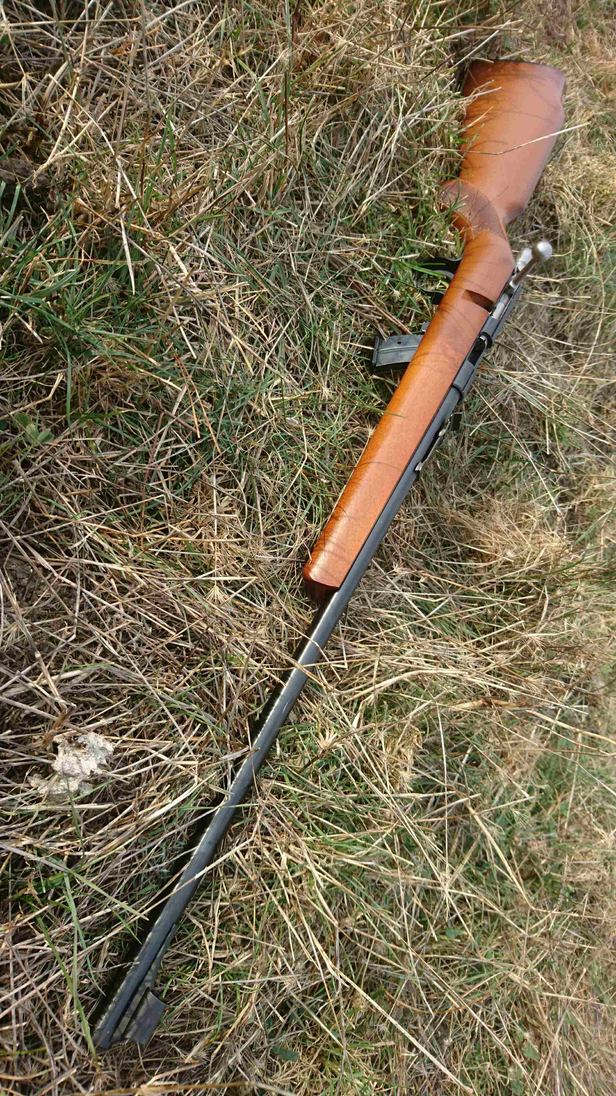

Post by Bent Arrow » 24 Jun 2017, 5:00 pm
Went into the LGS yesterday and grabbed some rings and put a 4x32 Nikon on the old girl. Went for a play. She seems to like federal high velocity solids. Reasonably tight groups for 50m off of a bipod....a few clicks to bring it down and bang on..
