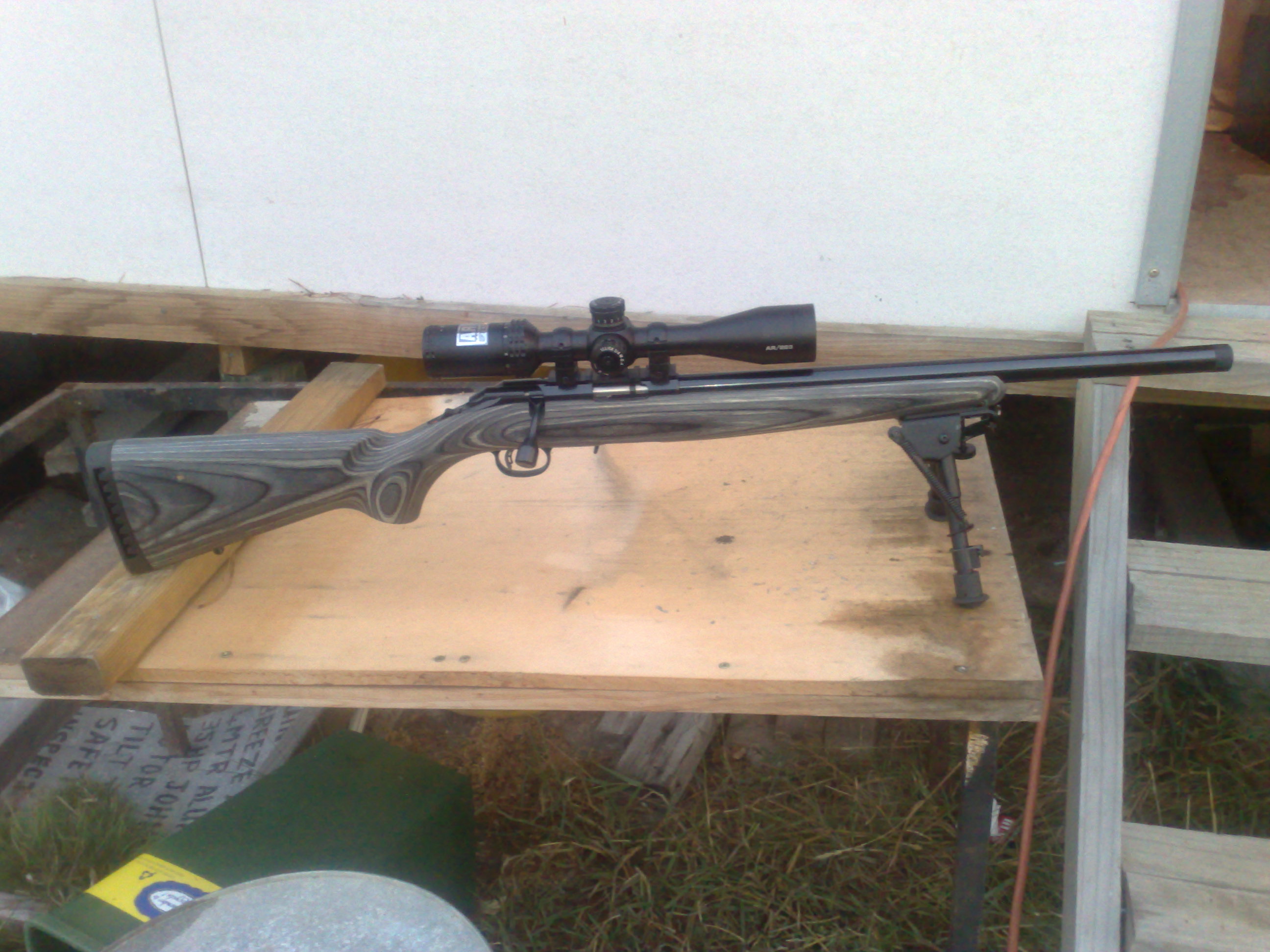

Post by bladeracer » 23 May 2017, 6:06 pm

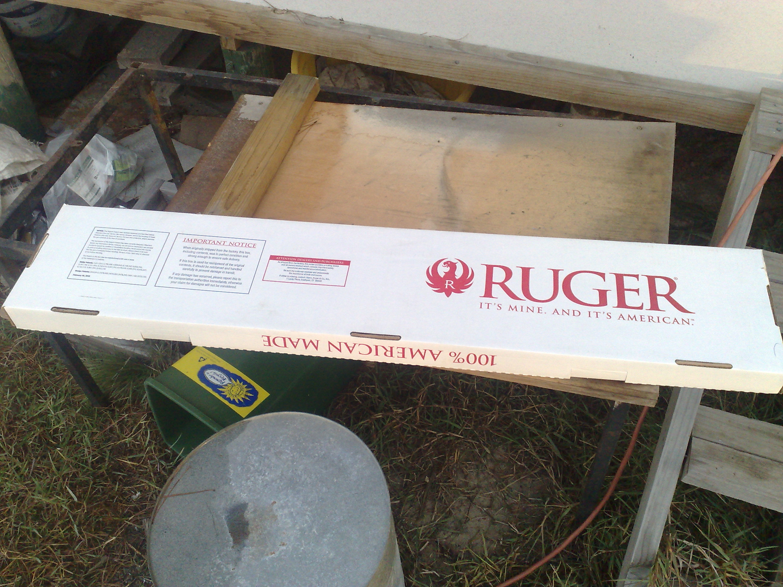

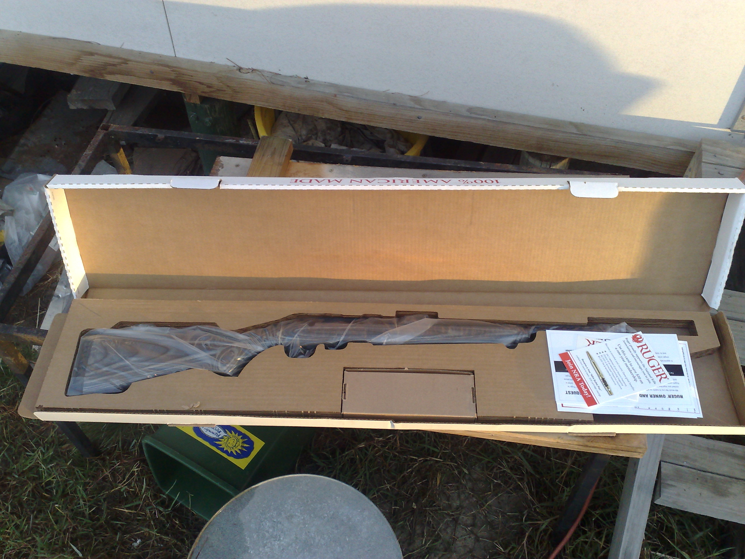

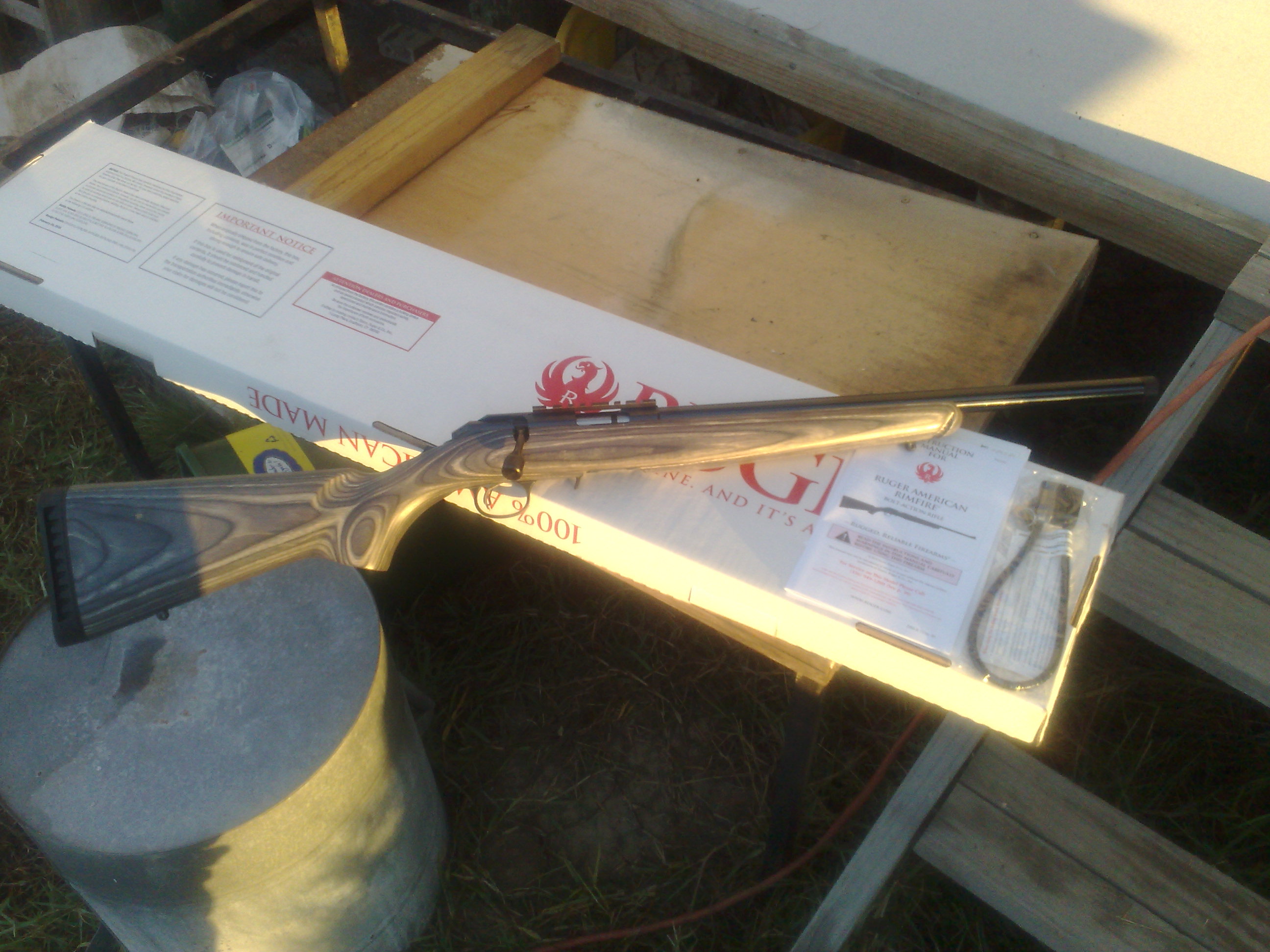

My rifle finally arrived this arvo after a month in Customs.
Way too pretty for my liking, but once the MDT chassis goes on I won't mind taking it bush.
The barrel is so heavy (0.86") I was convinced it must be sixteen inches long, but measurement confirms it is 18". It might've been a better rifle with a 16" as it is very front heavy.
The second patch through the bore came out spotless, so I put a Bushnell AR Optics 4.5-18x40 on it, grabbed some Remington Cyclones, and ran up to the dam before it got too dark.

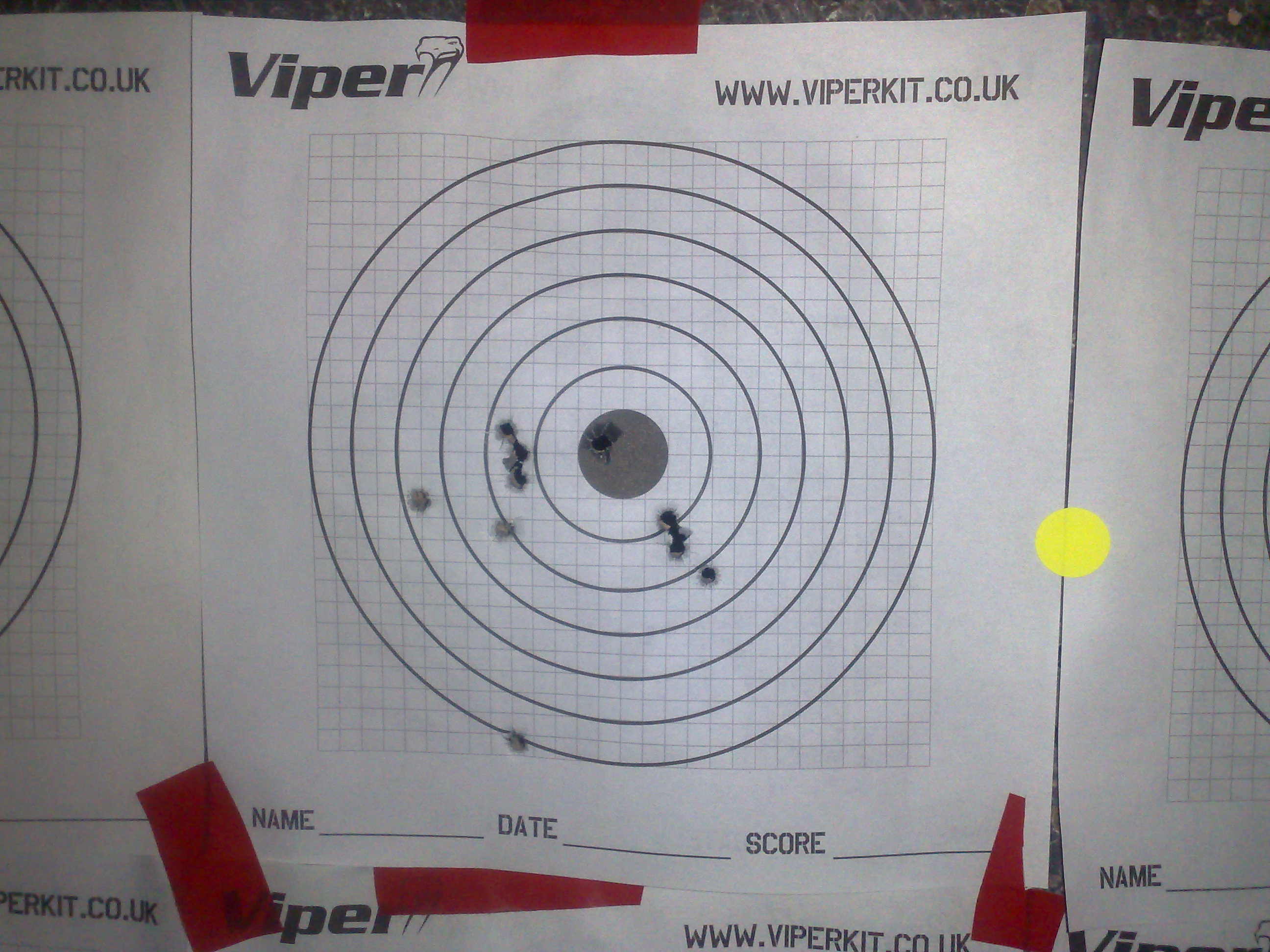

Fired two sighters to zero it at 50m, then put 20 onto a target to foul the bore - with a few clicks up and right in the midst to fine the zero. Shows some promise I think.
Then I put ten rounds onto another target to record her first ever group for future reference.

A very beautiful rifle indeed! Im usually not a fan of laminate stocks, but it does look really nice on the ruger. If my experience with my standard rimfire is anything to go by, that target should serve you well.

Post by Supaduke » 23 May 2017, 8:15 pm
Handsome looking rifle. Is that a Boyd stock or an OEM Ruger?
I have a Boyd stock in pepper, looks exactly the same. Be a great little plinker I reckon.

Supaduke wrote:Handsome looking rifle. Is that a Boyd stock or an OEM Ruger?
It's OEM but it wouldn't surprise me if Ruger hadn't contracted Boyd to make them.

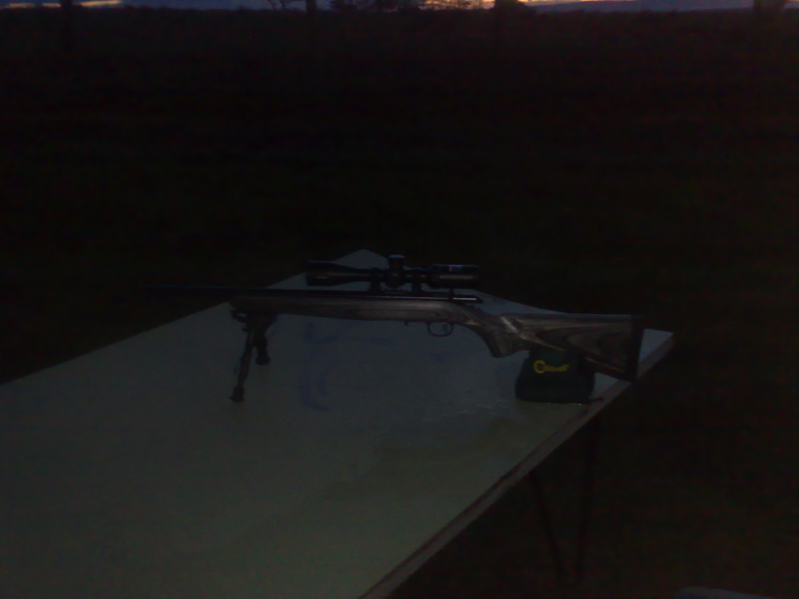

bladeracer wrote:...and ran up to the dam before it got too dark. Then I put ten rounds onto another target to record her first ever group for future reference.
This is how dark it was immediately after I shot the final ten-round target, didn't even close the bolt yet :-)
You can just see the skyline over the crest of the hill.
And yes, the bench was nice and wet from the rain!

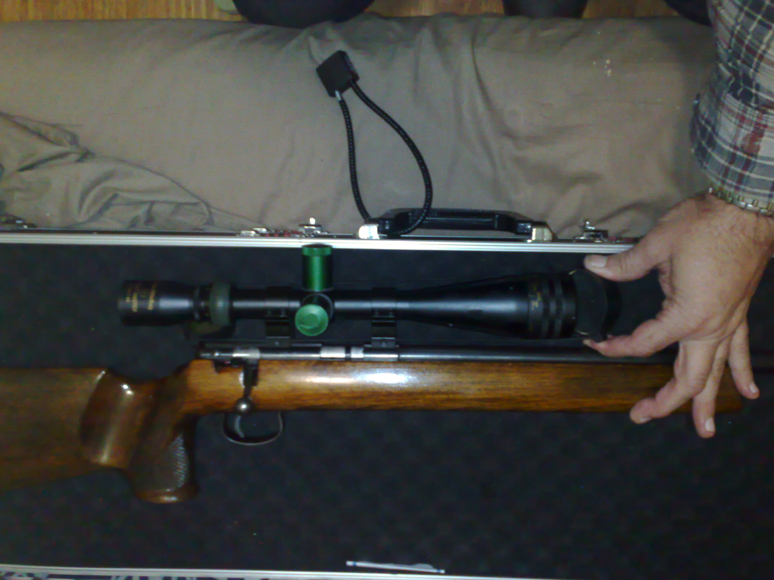

Post by bladeracer » 24 May 2017, 6:22 pm
sungazer wrote:Anschutz are often hard to determine exactly what they are as they often make quite a few different models of the same model if that makes sense. You always refer to it as a 64 which lends me to believe it is more the sporter version than target, although still very nicely made to exacting tolerances and quality. The 54 action is a little heavier and used in their target line and also in some of the varmint and sporter models.
I agree, I have no idea how to work out what Anschutz models are.
It's a Model 64 single-shot, and I believe from the eighties.
The only rifle I've found that looks similar is the 64 MSR so I'm assuming that's what it is.
Re: Ruger American Rimfire Target
Post by allan » 24 May 2017, 6:57 pm
From what I can see in the pic., it does look like a 64MS - If you have a look in this link, there is a download for the 64MS manual listed:
http://jga.anschuetz-sport.com/index.ph ... &sprache=1

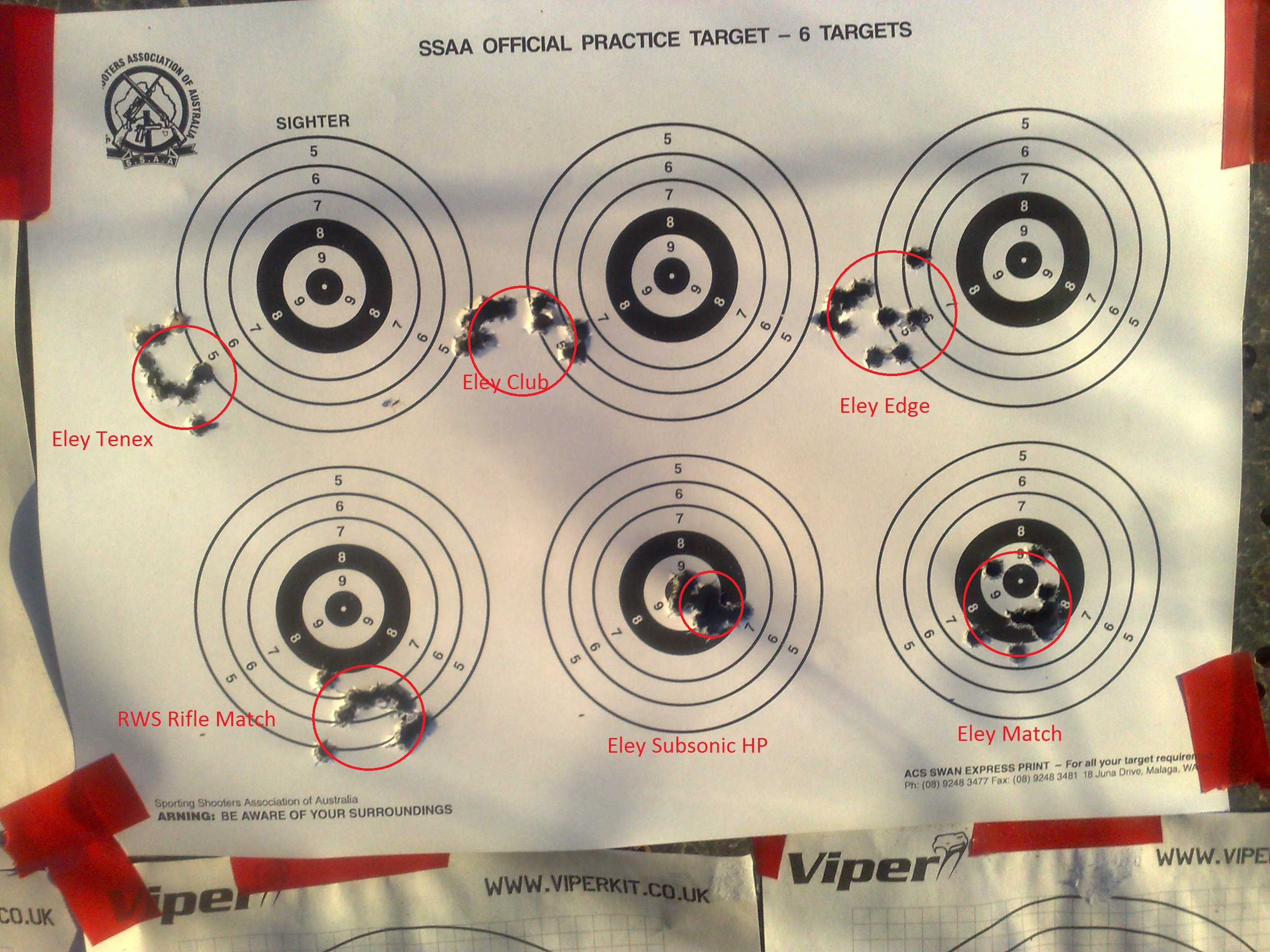

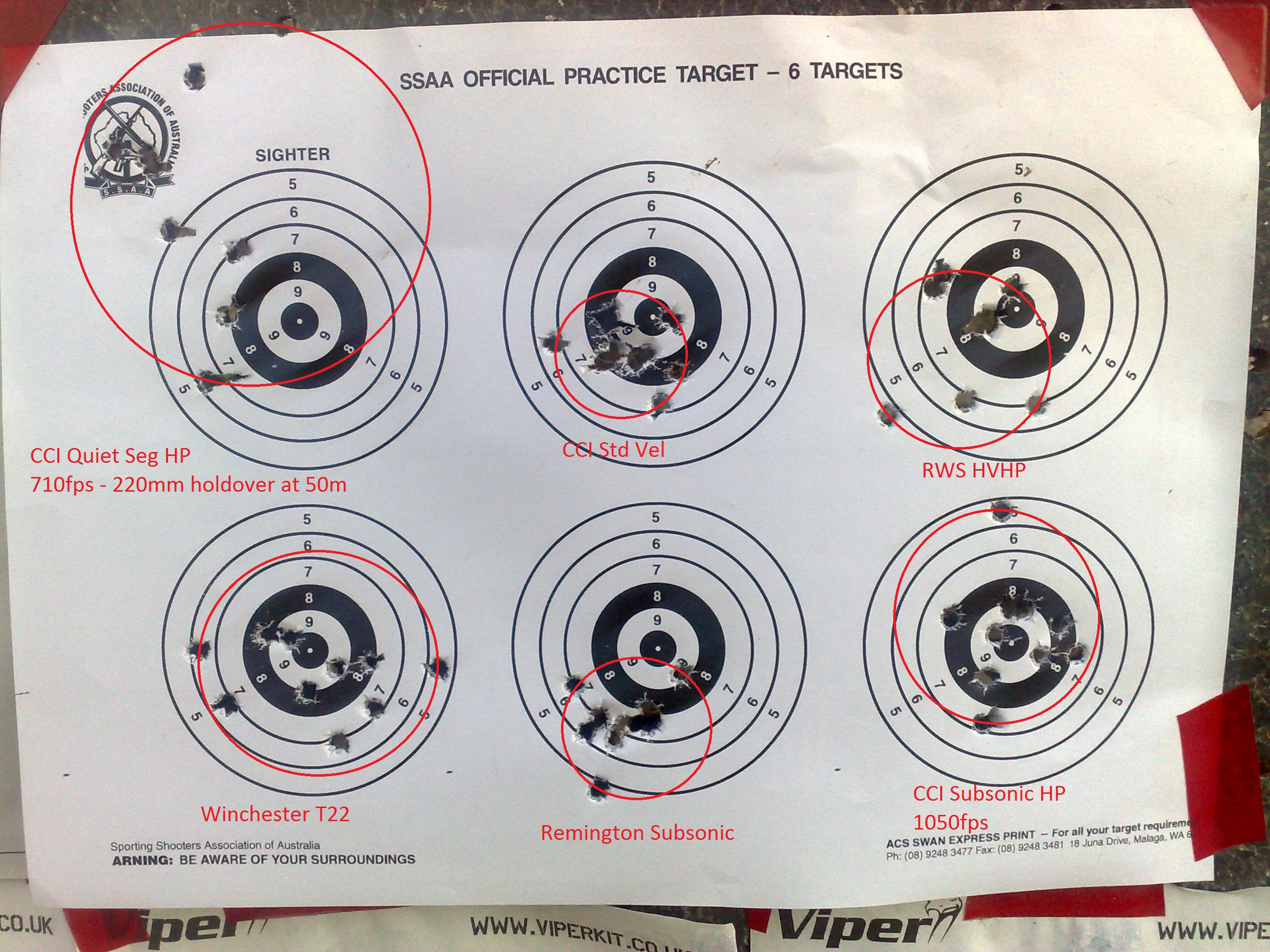

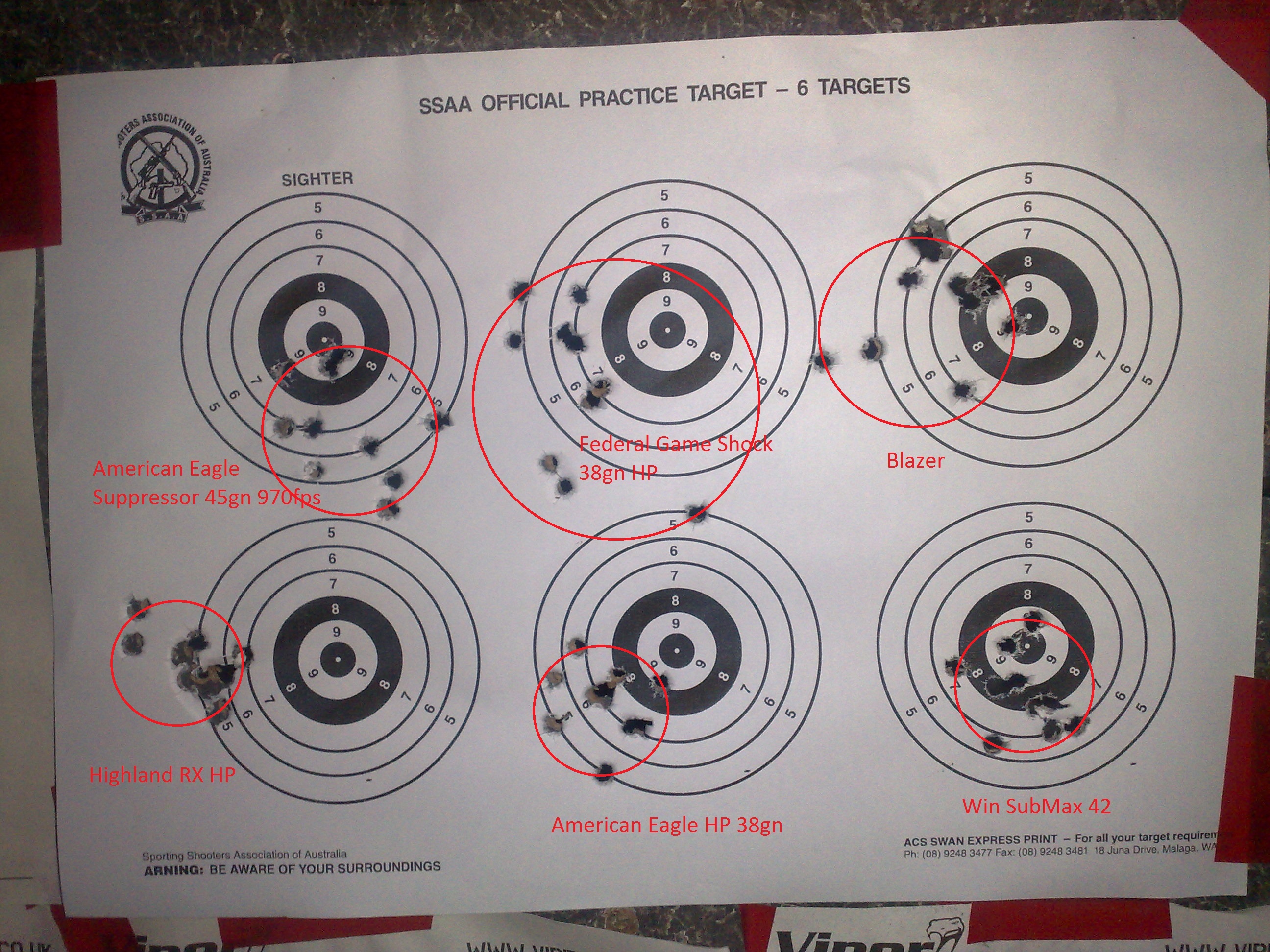

Since those first thirty rounds of Remington Cyclone (that grouped around 55-60mm for 10rds at 50m) I managed to get about half of my ammo test done tonight before it got too cold, I thought the shivering might start to affect the groups :-)
At 50m, ten rounds of the following:
(Remington Cyclone ~ 55-60mm - first groups)
Eley Subsonic HP - 14mm
Eley Match - 24mm
Eley Edge - 24.5mm
RWS Rifle Match - 24.5mm
Eley Tenex - 25mm
Eley Club - 27mm
CCI Standard Velocity - 29mm (23.5mm without the one I pulled to the left)
American Eagle HVHP - 30mm
Winchester Subsonic Max 42 - 31mm
Highland RX HP - 31mm
Remington Subsonic - 34.5mm
American Eagle Suppressor 45gn 970fps - 37mm
RWS HVHP - 40mm
Blazer RN - 44mm
CCI Subsonic HP 1050fps - 50.5mm
Winchester T22 - 58mm
Federal GameShock 38gn HP - 68.5mm
CCI Quiet Seg HP 710fps - 84.5mm (220mm holdover)
Amazing was the Eley Subsonic HP - ten rounds into 14mm.
So far, it looks the most accurate in my Target is going to be Eley Subsonic HP, and in my Compact the Eley Edge.
With CCI Standard Velocity as a very good cheaper option in both rifles.
Hopefully I can get some more done tomorrow.

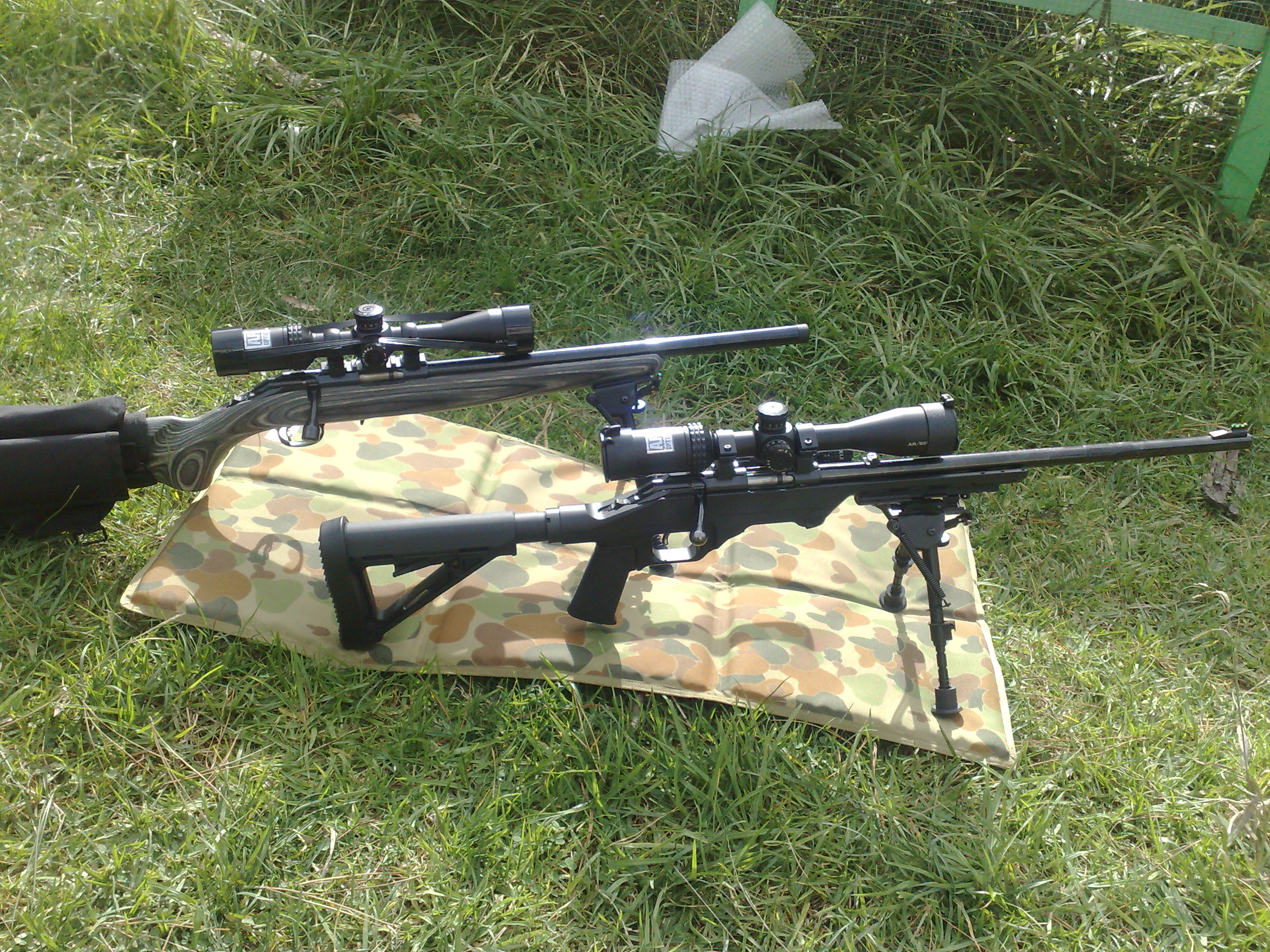

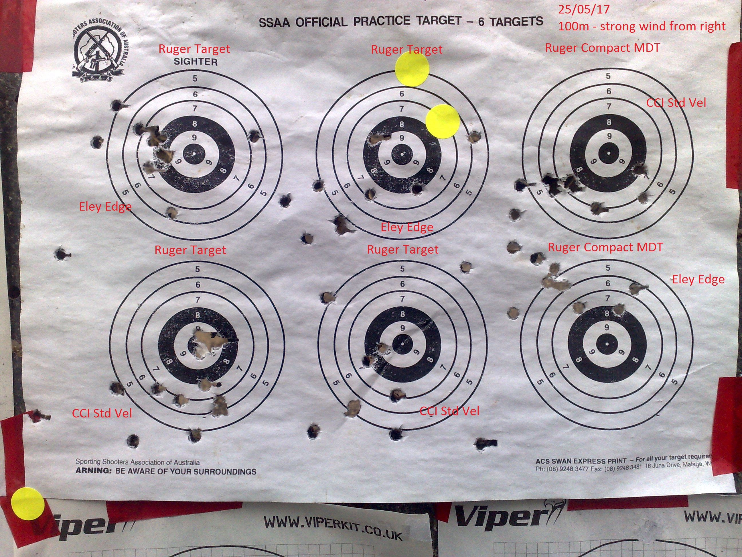

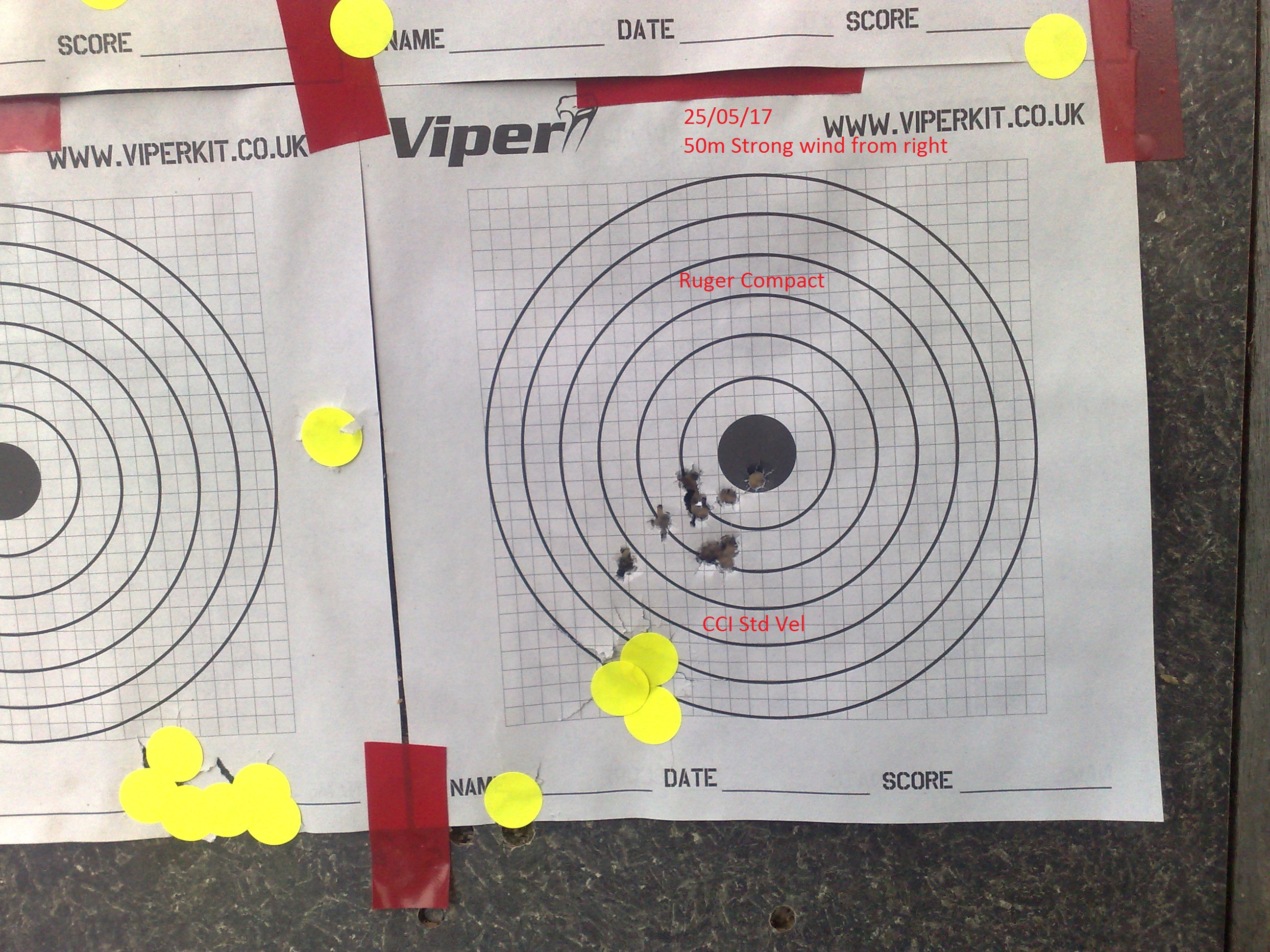

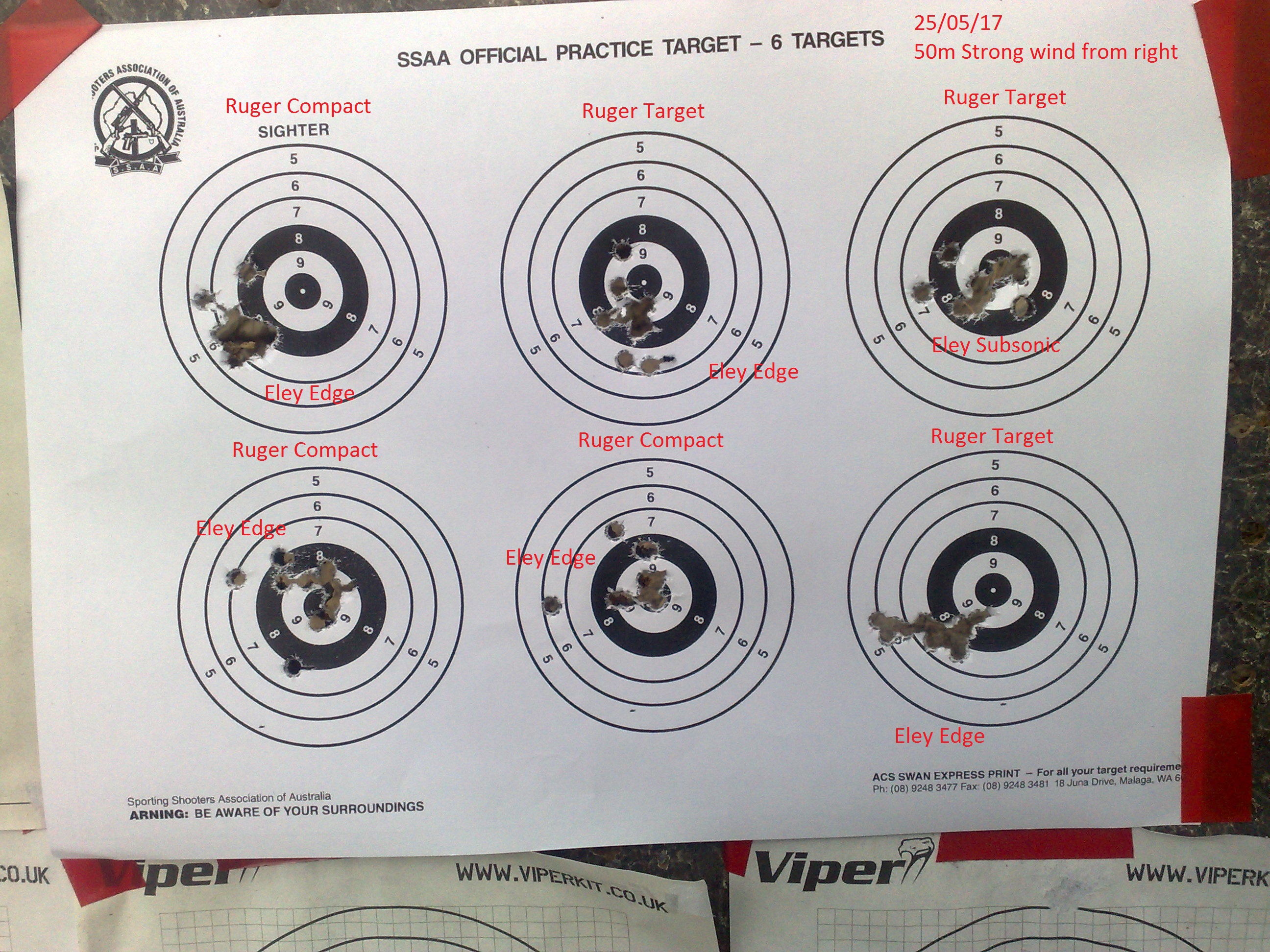

I took the Target and the Compact just now and shot them together, despite some pretty heavy winds.
At 100m the wind is messing them up too much to determine a winner, but at 50m I think the Target might just have the edge.
50m Ruger Compact vs Target.jpg (1.33 MiB) Viewed 13418 times
100m Ruger Compact vs Target.jpg (1.54 MiB) Viewed 13418 times

Nice purchase. The stock looks heaps better then there standard piece on plastic junk that comes on most Ruger rifles these days.
Enjoy...

Depends whether you buy your rifles to use or to look at I guess.
