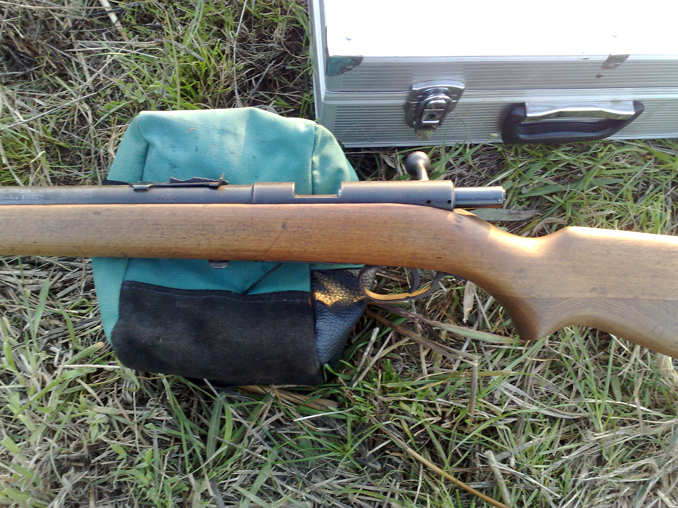

Anybody know how to date an early Lithgow?
I just pulled the barrel out of a Model 12 #34032 which I'm going to put into my father-in-law's 1940 Remington 510 to get it shooting again. I'm guessing the Lithgow is about '47/'48 vintage. Beautiful little rifle, but the owner is determined that he's handing it in for destruction. Very sad to see it go that way but at least the barrel will live on.
I shot some groups with it yesterday and it shoots almost as well as my 1950 BSA Sportsman 5, despite an odd sight picture - V-notch rear with a bead front - is that standard on these? Best group was 5rds of CCI SV into 25.5mm at 25m - 3.5MoA. I'm hoping the accuracy will carry across to the Remington.
I shot a bunch with the Remington last week to determine what it is actually capable of. Best I managed was one 113mm group at 25m. 140mm was more the norm. I pulled the bullets from some Remington Cyclones and chambered the charged brass behind some .224" 35gn NTX's and they grouped 35mm so I was thinking of reaming it to WMR to use jacketed .224" bullets. I then pushed an NTX through the bore. It jumps a few times at the chamber and muzzle but the middle part of the barrel it basically fell through - I think it's just one long bulge.
I have a choice of an Anschutz 1516 WMR barrel or the Lithgow. The WMR has some novelty value but the Lithgow barrel is almost identical in appearance to the original so I think that's the best option for the rifle. I want to keep Bob's 510 in the family and hand it on to one of Bob's sons as a shootable rifle, not just a very inaccurate safe ornament. We can't think of anything else that Bob kept for seventy-five years, so to me it has significant family value. He got it for his birthday, December 5th, 1940.

That is the standard sights. That is a crime handing that in for destruction. Take the barrel, and stock and I won't cry as much.Why are they do determined to destroy it. Surely at least giving it to a dealer to sell would feel nearly as good.
There aren't too many rimfire barrels that would be as good as an old Lithgow 12 barrel.

Although the rifle is overall in pretty good condition, the bolt handle has been broken off at some point and brazed back on. And the front mag catch is broken off, so the mag keeps dropping out. He doesn't think it's financially worth bringing up to salable condition as he reckons he can get $100 at least just for the stock and magazine, without taking up valuable acreage in the safe.
He only wanted $100 for the rifle as is, including the mag, but I already have five .22's and another would just take up space that I could put something else in. And, while I really hated doing it, I'm really happy to think the barrel will hopefully go into keeping an even older rifle shooting for many years to come. If I hadn't come along the whole thing would probably have been destroyed!
I stripped out the receiver, and I assume he plans to keep everything except the barrel (with sights) which I have, and the receiver he's handing in. The front sights are virtually identical but the rears are not compatible - the Remington is screwed to the barrel, the Lithgow is dovetailed. I'll probably put a set of Ruger sights on it though. The barrel and all the original pieces of the 510 will be put away and when the family finally finishes shooting it maybe it can go up on display in its original form. The Lithgow stock in particular I think is outstanding so if you know anybody chasing bits, let me know and I'll put them in touch.
I just need to turn 0.020" off the barrel threads and it'll slide into the Remington. I can't find the notes from when I measured the headspace, but I've already shimmed the bolt head 0.008" from memory, so I want to tighten the headspace up a fair bit during the barrel swap.

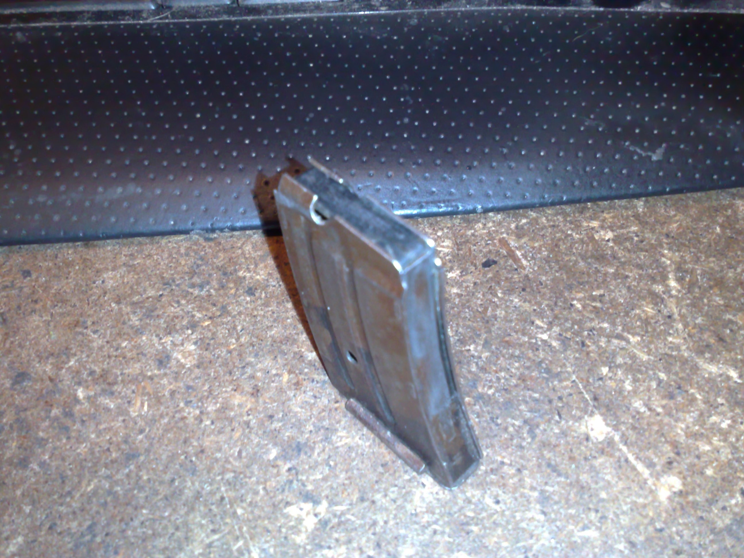

Couple pics of the mag. Functions smoothly after a clean and a touch of grease. Spring appears to have been tweaked slightly at some point, but does seem to work fine.

5 shot. Rarer than the ten.

Looks good to me, thanks.
