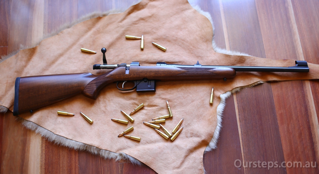

I like short/light rifles :lol:

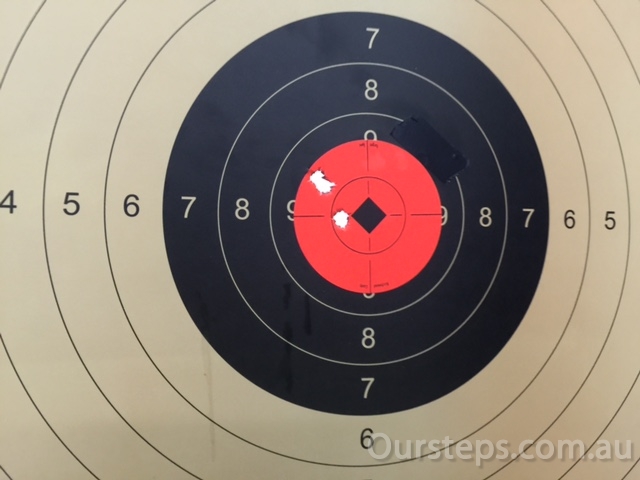

iron sight 25 meters the first 3 shot of this rifle
SHV
Posts: 1780
Re: CZ527 carbine 7.62x39
Post by SHV » 19 Jun 2017, 11:36 am
first 3 shot at 50 meters
SHV
Posts: 1780
Post by SHV » 19 Jun 2017, 11:37 am
5 shot at 50 meters

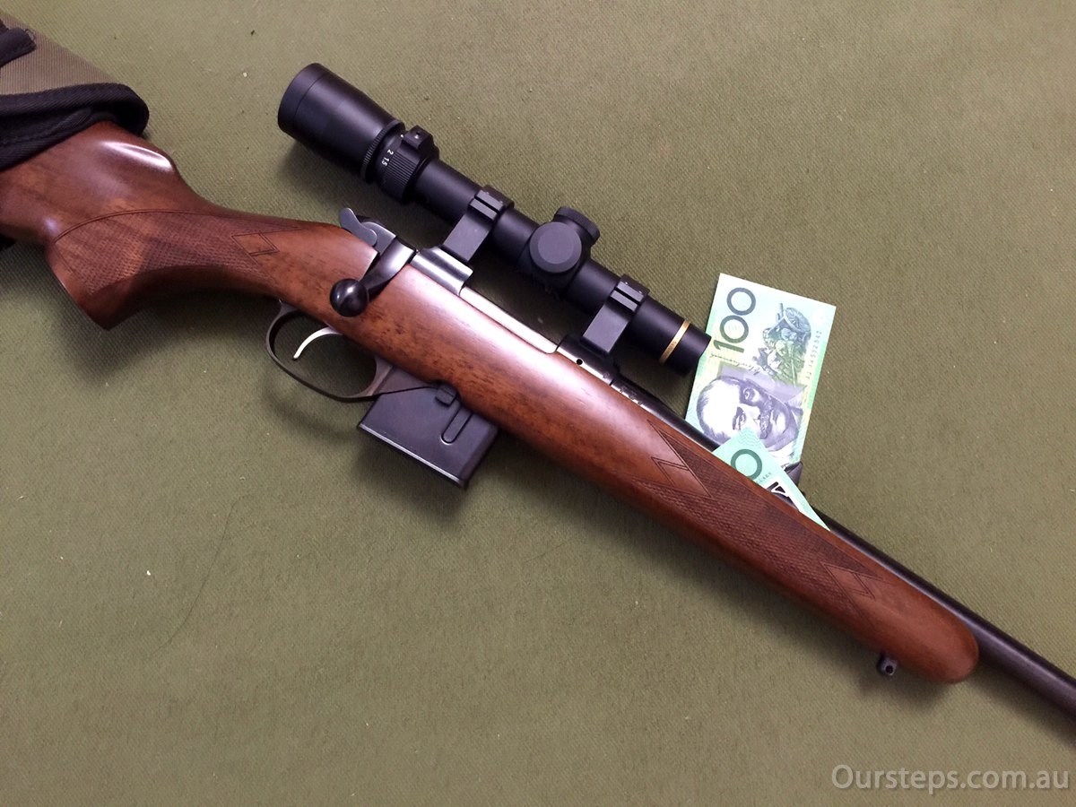

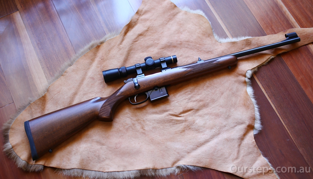

got the scope on it
SHV
Posts: 1780
Post by SHV » 19 Jun 2017, 11:41 am
very light and perfect balanced, you can shoot it even with one hand :lol:

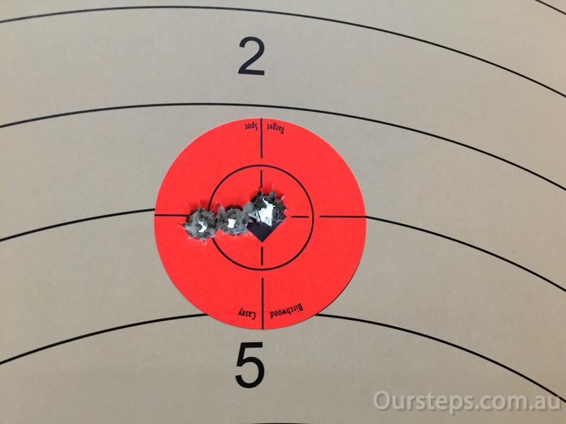

3 shot at 50 meters with 4.5 power scope, the set trigger is fantastic, the S&B factory ammo is good too
SHV
Posts: 1780
Post by SHV » 19 Jun 2017, 11:45 am
really nice result for factory ammo

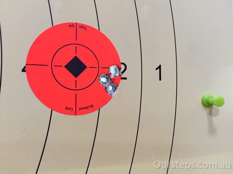

another 3 shot after zeroing the scope
SHV
Posts: 1780
Post by SHV » 19 Jun 2017, 11:49 am
but after this 3 shot, the barrel heated up, the POI spread from center to left, looks like the rumor is true...

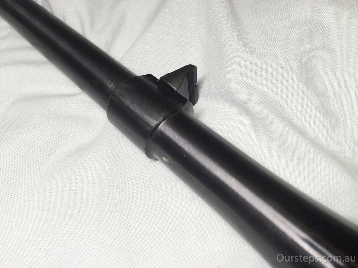

Post by SHV » 19 Jun 2017, 11:52 am

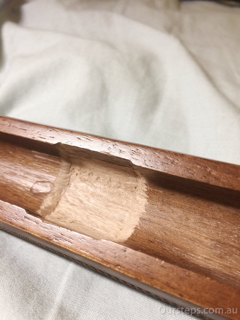

the barrel is not free floated, especially under the rear sight
SHV
Posts: 1780
Post by SHV » 19 Jun 2017, 11:55 am
so I used a small knife to cut off a little bite (about 2mm deep) on the stock
SHV
Posts: 1780
Post by SHV » 19 Jun 2017, 11:56 am
now it is much better :lol:
SHV
Posts: 1780
Post by SHV » 19 Jun 2017, 12:01 pm
haven't got time to try again, should be ok... after check to make sure it is totally free floating, put some vanish to seal the stock, the job's done :lol:

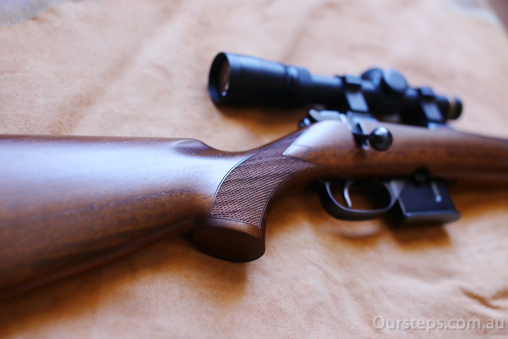

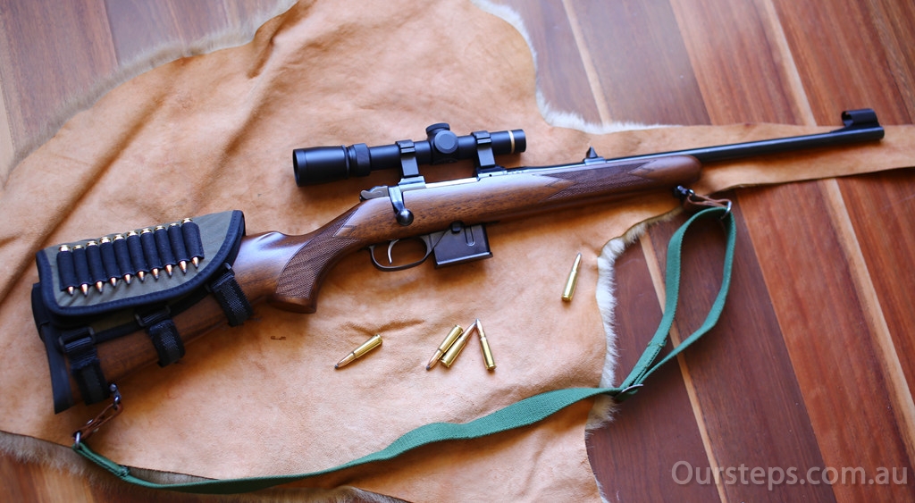

stock is nice timber and well made
SHV
Posts: 1780

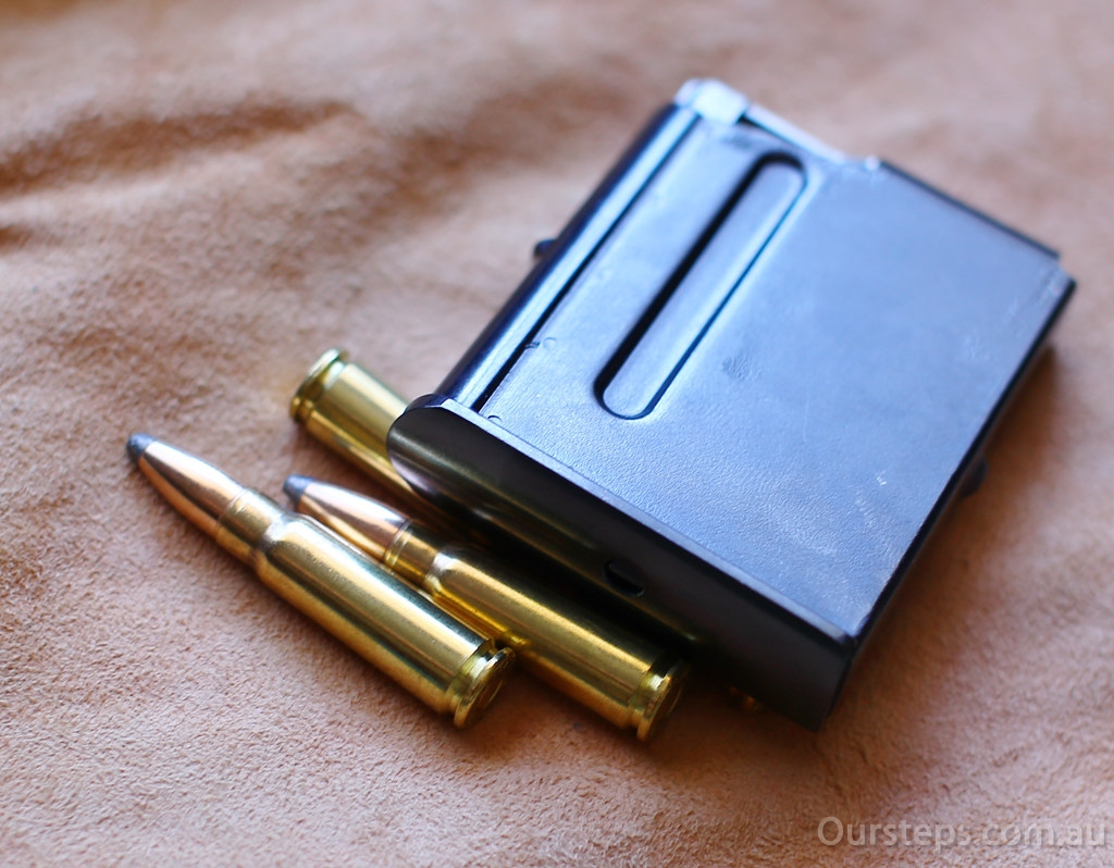

Post by SHV » 19 Jun 2017, 12:06 pm
all metal mag
SHV
Posts: 1780

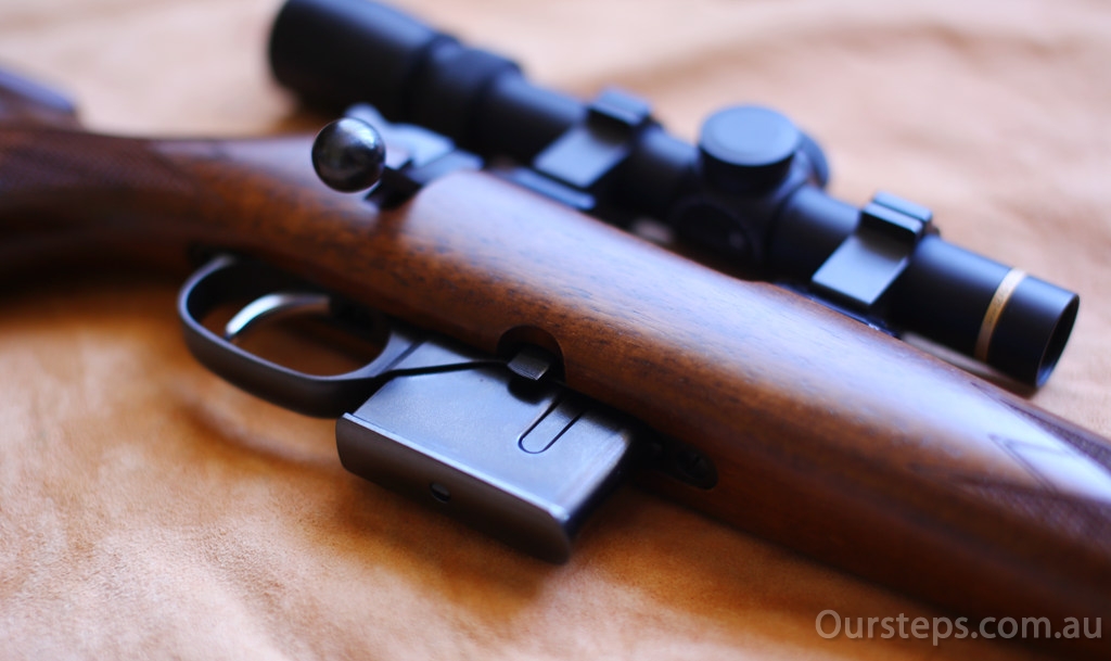

Post by SHV » 19 Jun 2017, 12:08 pm
put on the mag feels positive and solid, release is easy and handy
