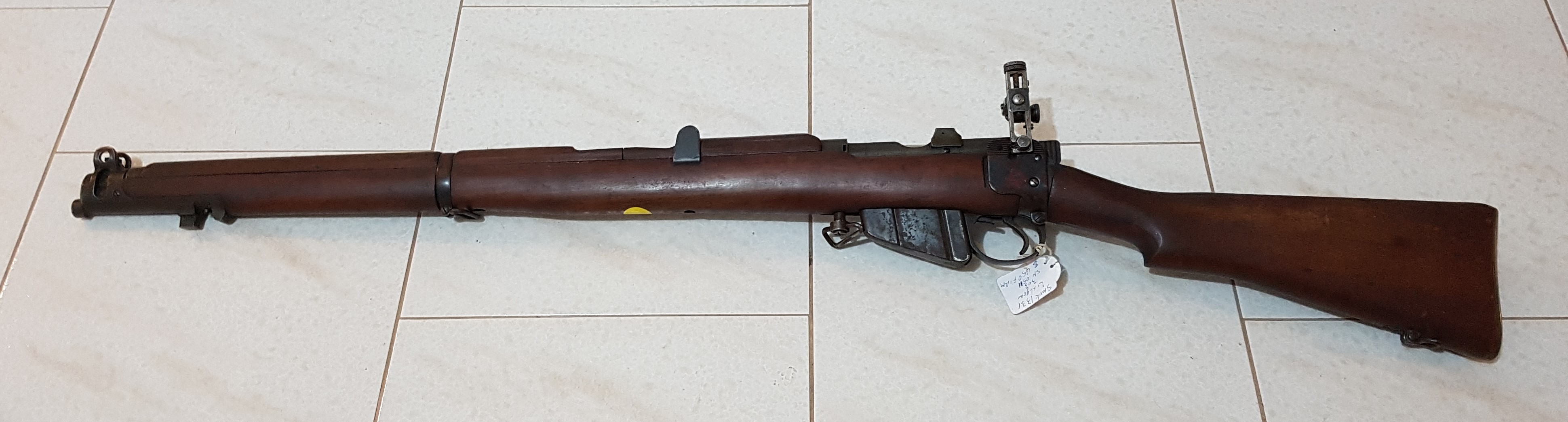

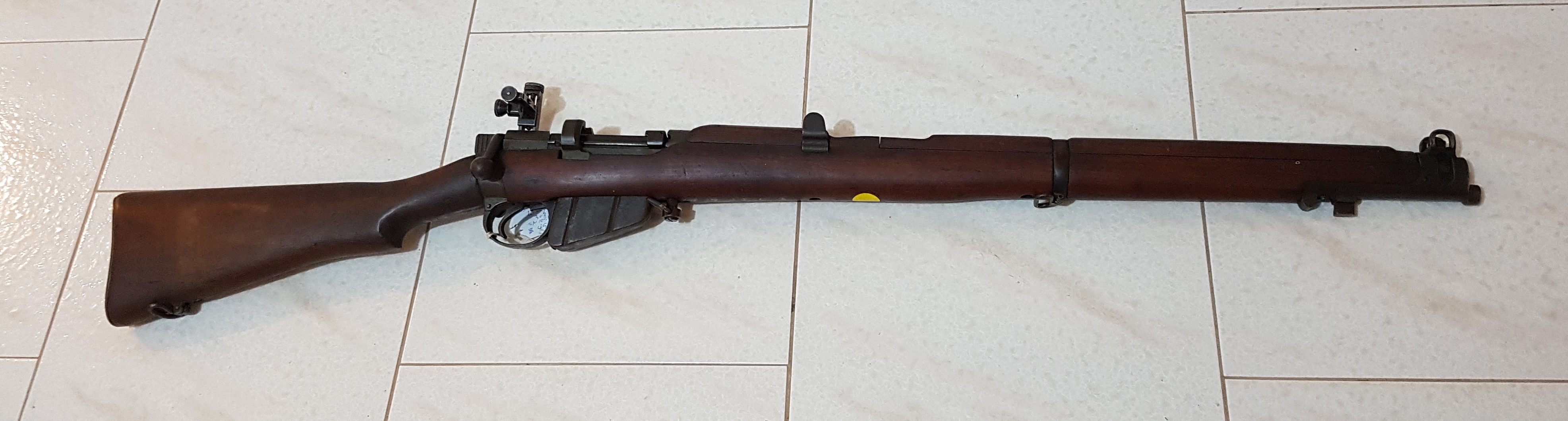

Took some time to save a bit for on of these only had a small amount so this was at Bendigo show and fitted my price range.
Wanted to give it a tub and take it out for some range time but to busy.
Its not the best one but hope it to be the start of something good.
Will need to get a sling and what ever accessories I can get at the next show at Altona.

Looks very tidy , good looking rifle. A nice pick up , hopefully it's a nice shooter.

Glad to see that central sight - yikes can they be expensive/annoying to buy separately!

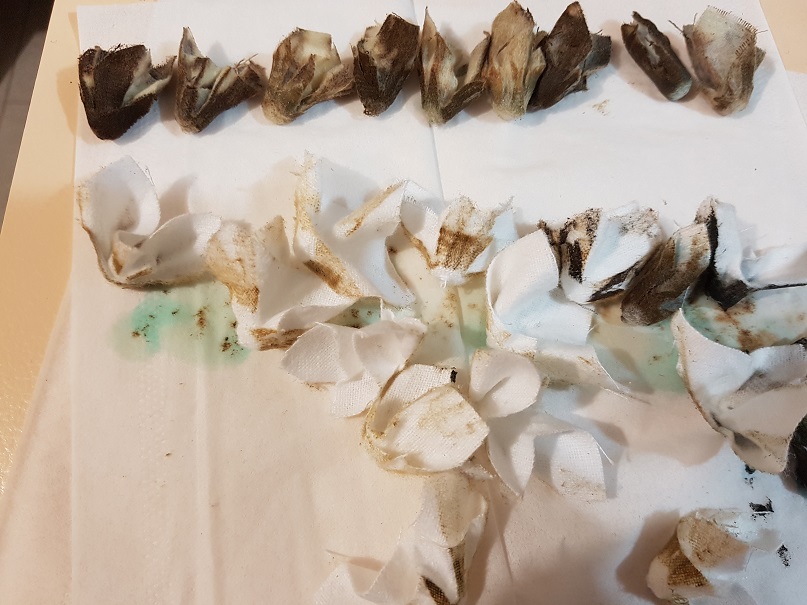

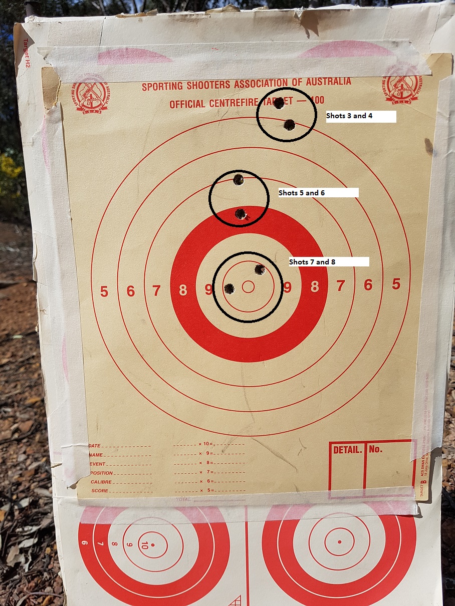

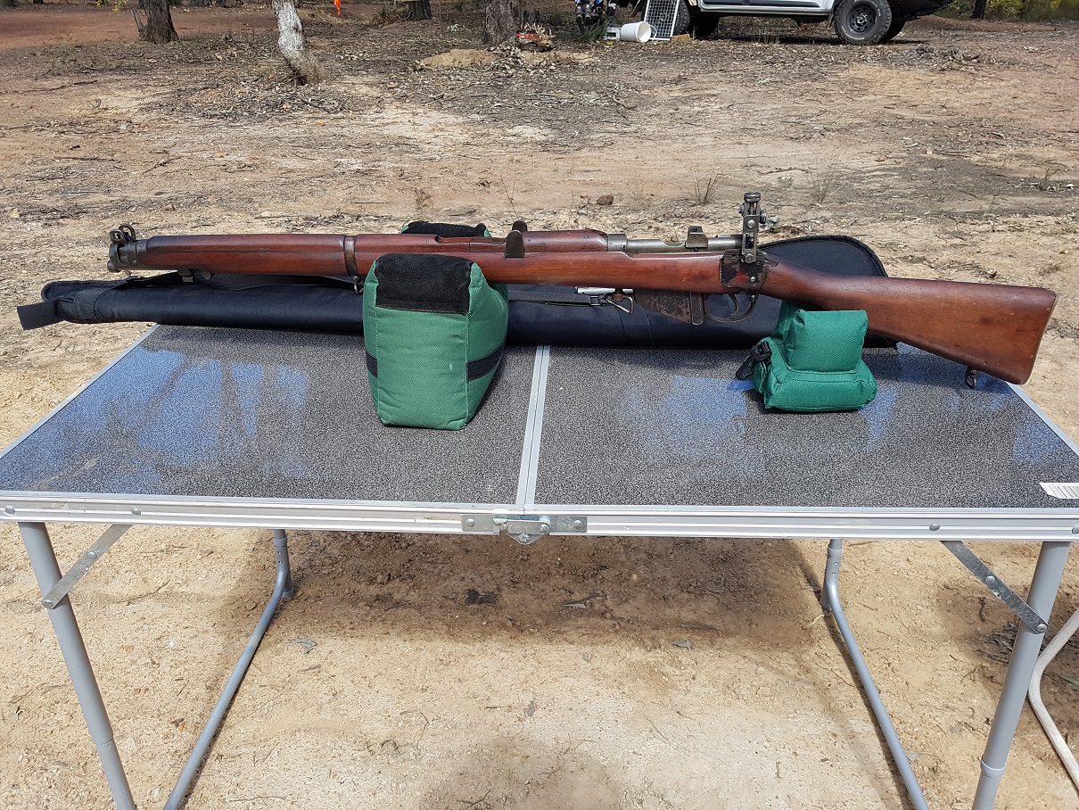

Well after a huge clean and I think there is more to do, it shot ok I just need some more time with it only shot about 10 rounds of a table (bad arm/shoulder).
The central sight is pretty good but I need to ask a dumb question, where should the target point be on the forward sight?

Depends on the gun, but usually you sit the top of the front post level with the bottom of the target. So you get a lollipop effect. Called a 6 o'clock hold.

Yep I did that lollipop thing, thanks
