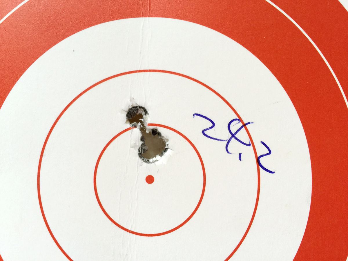

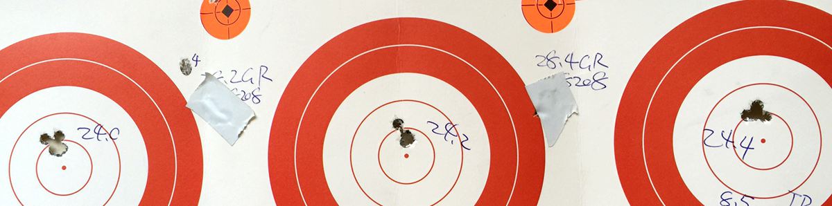

first 4 shots nearly perfect, very happy and excited, then the last one flys :crazy:
Sauer 202 223, BM8208 24.2 super loo the cheapest 55 gr bulk buy projectile, 50 meters indoor shooting range

Post by SHV » 05 Oct 2017, 9:28 am
24.2 should be the best load, got good resort before
different load test this time

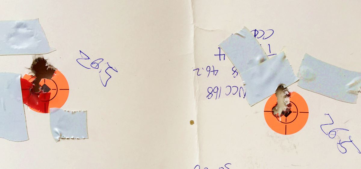

Post by SHV » 05 Oct 2017, 9:32 am
CZ527 7.62x39 carbin, AR2207 26.5gr, TBF 130gr projectile, CCI primer, 50 meters indoor
left side 5 shot is mine, first 4 shots ok but last one flys low
