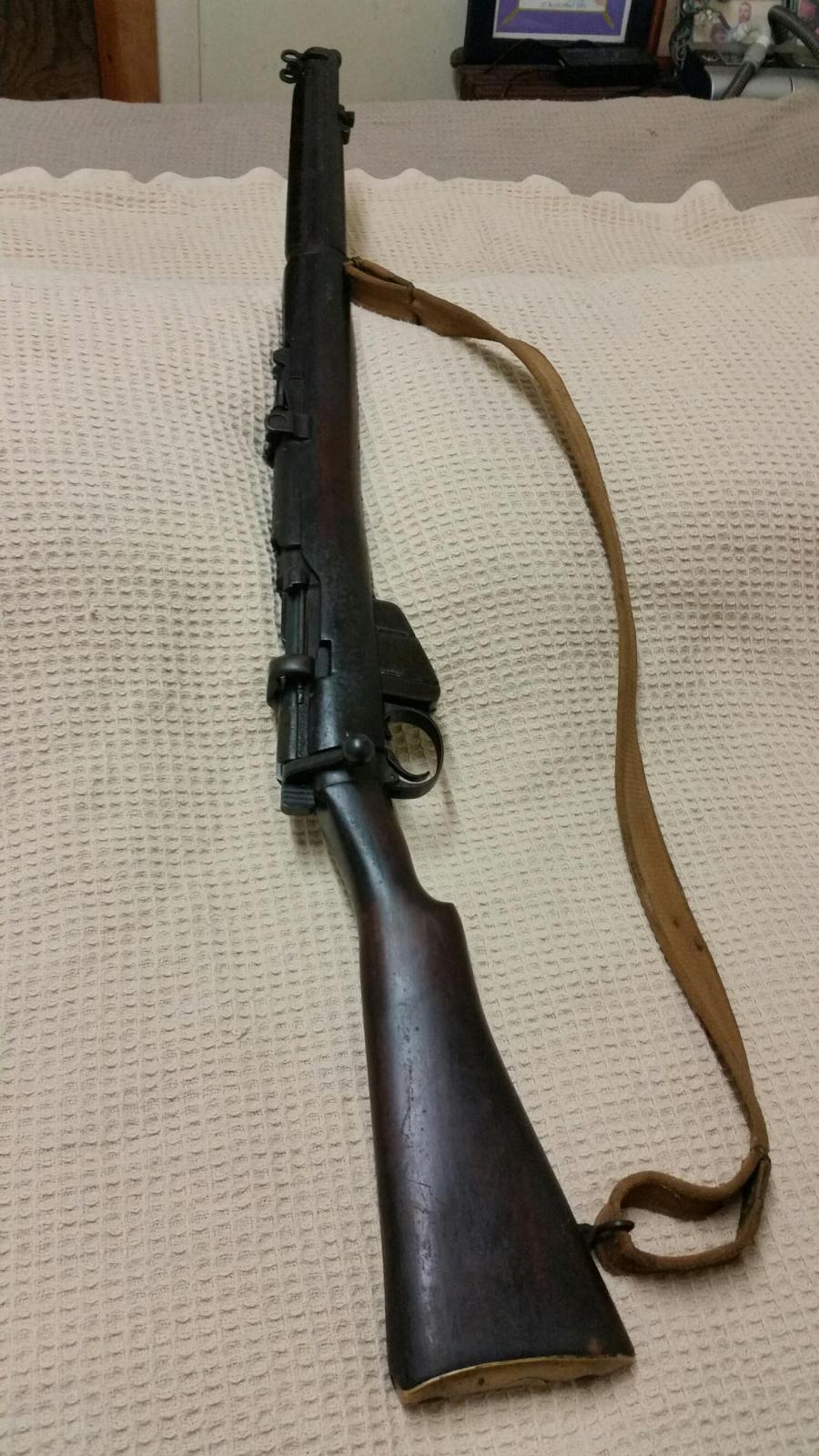

Sorry to jump in bent Arrow but while we're on 303's I have a question about mine that I was given now mine has LITHGOW SHTLE 111
1919 Does that make it date of issue as 1919 and would the firing pin outside have a round grip rather than the square one like the later ones
I will take a picky and post it soon

Right O mate i'll try that I don't know what got into me I've had a 303 for years and numbers meant nothing to me but since oldmate that gave me the 303 said it was
his fathers I just can't stop wondering where it has been and who with the bolt does not have matching numbers as the barrel but anyway i'll keep looking
If only it could talk

Post by Supaduke » 29 Oct 2017, 10:49 pm
I can say that mismatched bolts often mean it has been to European skirmishes and used by places like the Baltic states.
Or farmer Joe lost the bolt and bought a new one.
SHt.LE markings would indicate it's a British manafactured rifle.
A build date of 1919 means it could certainly be a mk3*. So a square cocking piece would be right.
A few pics would be helpful.
Does the action have a solid charger bridge ?
I find learning the history and stories of these old guns rewarding and interesting.
Supaduke

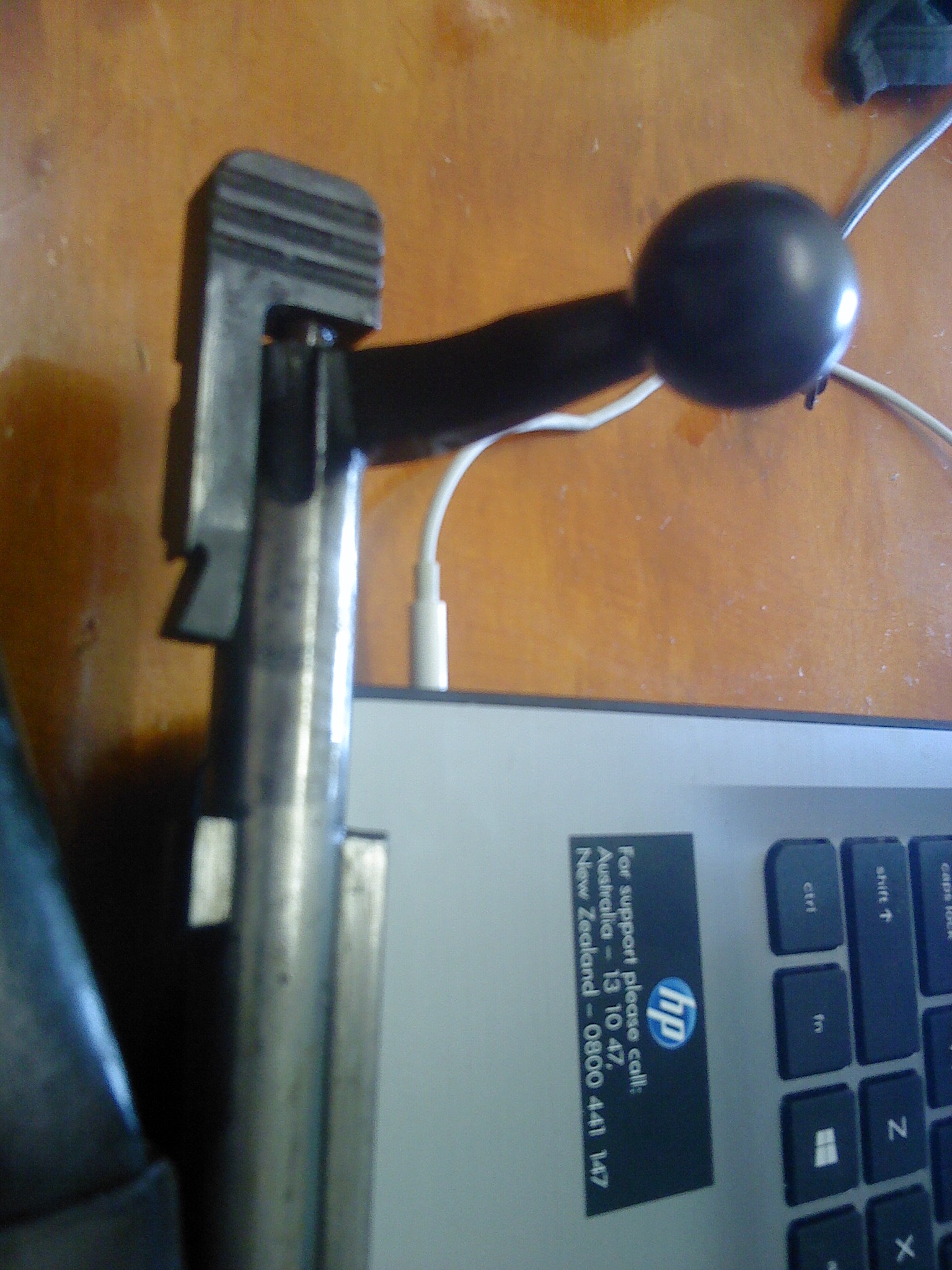

Post by Member-Deleted » 30 Oct 2017, 8:21 am
Here is some pics of the bolt Supaduke
FTR is stamped on the front-right of the action so this probably explains the bolt numbers being different to the barrel

Post by Supaduke » 30 Oct 2017, 9:38 am
You have yourself there a no.1 mk 3*.
Squared cocking piece
Fixed charger bridge
Magazine cut off and volley sights deleted.
1919 was when the action was manafactured.
The stock could be a year or two older. Not uncommon for rifles to be assembled a year or two (there are examples 12 years apart) after the action was built. Quite normal.
The Lithgow shield marking on the receiver collar was used up till 1926.

Post by Member-Deleted » 30 Oct 2017, 12:52 pm
Thanks Supaduke looks like it has been rebuilt at some stage
The plot thickens I might start cleaning it up I've only had it a couple of weeks after cleaning I should be able to get more info
from it thanks again
