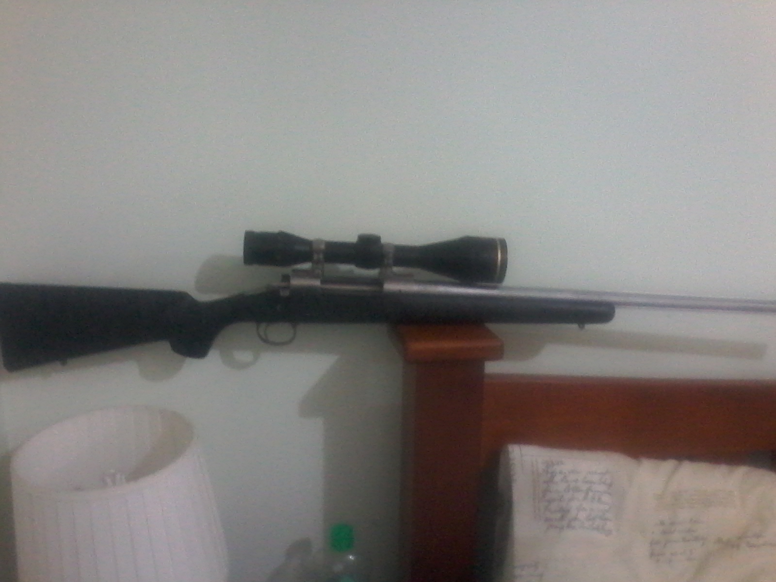

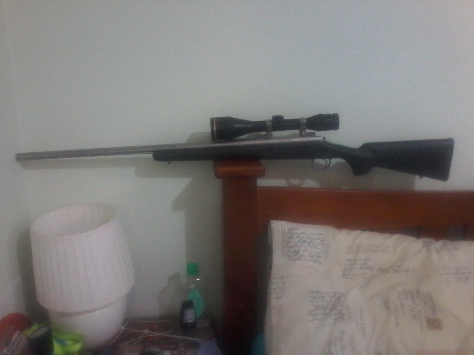

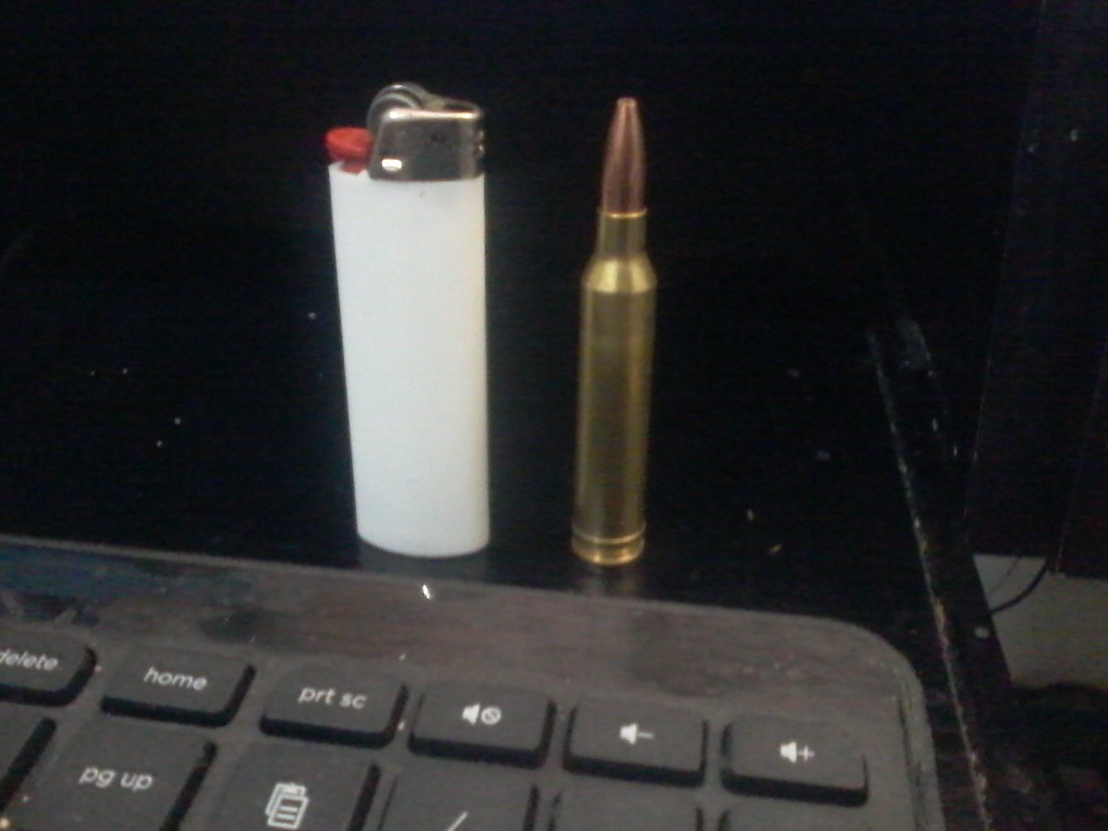

Pictures of my baby.

Nice one duncan61 she looks good what's the scope, mine will have the z3 Swarovski I had on the 25-06
My 7mm is going to be a learning curve for me so any info like that is gold because I don't think they are cheap to shoot
although I will be reloading for it . Your's handles the 175's ok I presume whats its grouping with them
