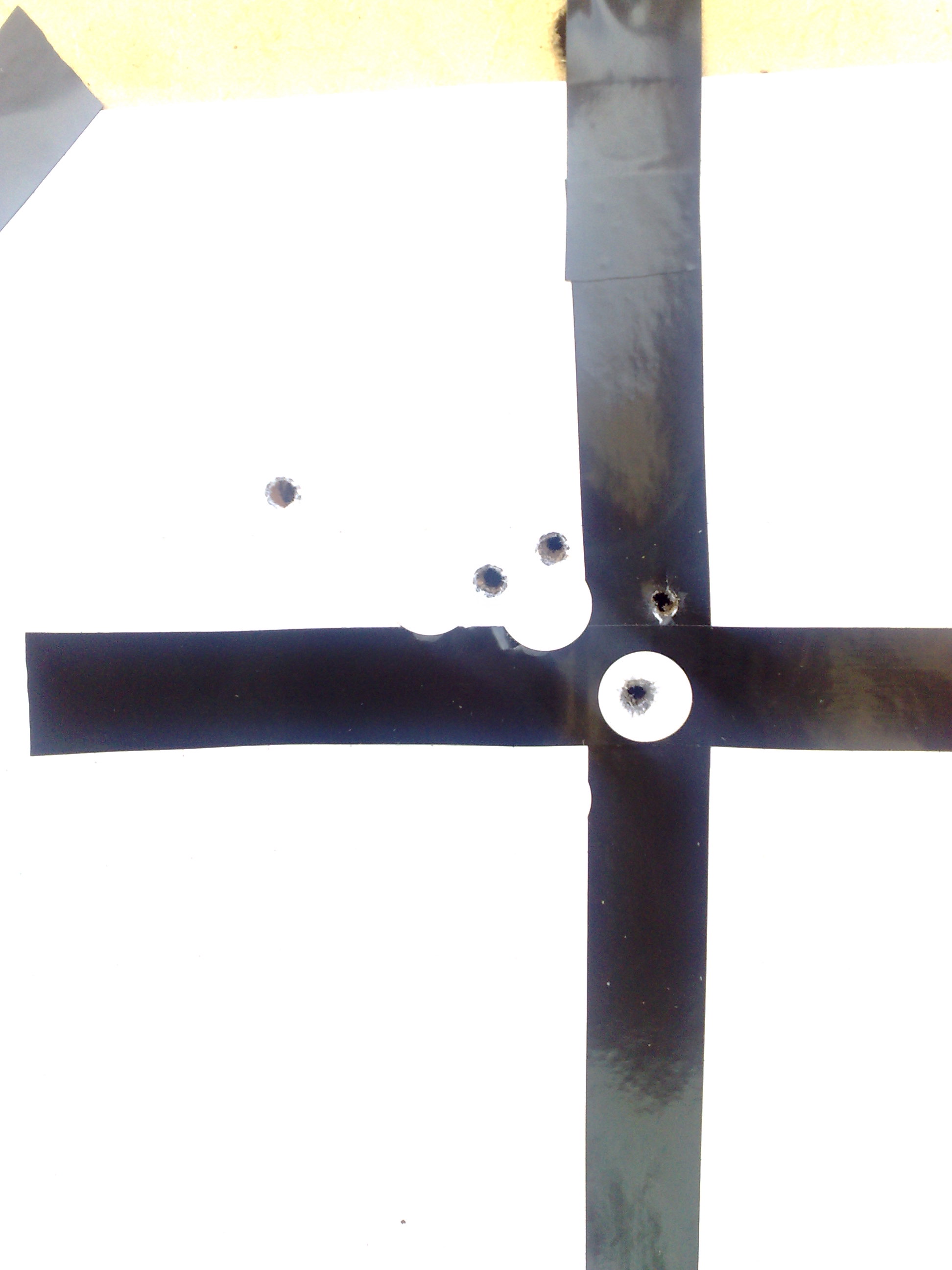

I put the first rounds through my .223 Ruger American Predator this arvo. I didn't even bother running a patch through the bore as it looked just fine. I only had a front bag and the chrono has been out in the rain and wouldn't give me consistent readings (I later discovered a spider living on one of the sensors).
Brand new rifle so I put five rounds through to foul the bore (used 52gn bullets swaged from .22LR brass) which went into 31mm at 100m. Then adjusted the scope 3MoA to the right and 4.5MoA down from where I'd boresighted it. I shot this group with the muzzle brake on for my brother's education.
Then shot four five-round groups with the 80gn ELD-M on AR2206H at 22.5gn, 23.0gn, 23.5gn and 24.0gn. I set them with 10-thou jump (COAL 2.378") and they were still too long for the mag so I fed them singly. The bullet is 1.277", or 5.7 calibers long and seated .660" into the case - compressing the powder by about 12mm.
The 22.5gn went into 32mm (39mm low and 16mm to the left of the 52gn zero) with two consecutive rounds touching.
The 23.0gn did 37mm with a flier, a group of four fell into 17mm (38mm low and 5mm to the right).
The 23.5gn did 27mm also with a flier, four into a line of 18mm by 4mm vertical spread (23mm low and 13mm to the right).
And 24.0gn did 47mm with no cluster at all - the closest pairs were 19mm and 24mm (39mm low and 17mm to the right).
24gn is ADI's listed max and I didn't load higher as I was concerned about the case volume raising pressures - it took noticeable ram pressure to seat the 24gn loads - but I got no pressure signs at all so I'll make some 24.5gn and 25gn loads to test. But it looks so far that 23.5gn is where I need to tune it.

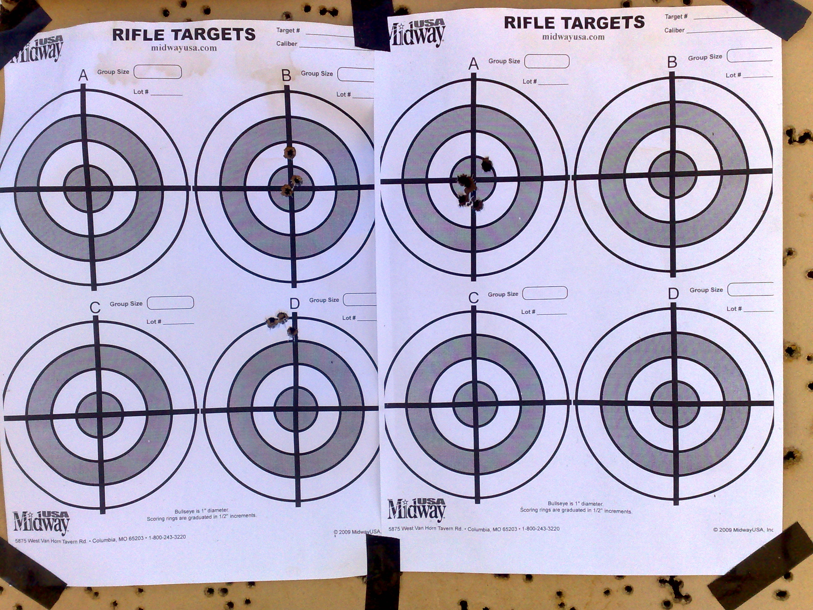

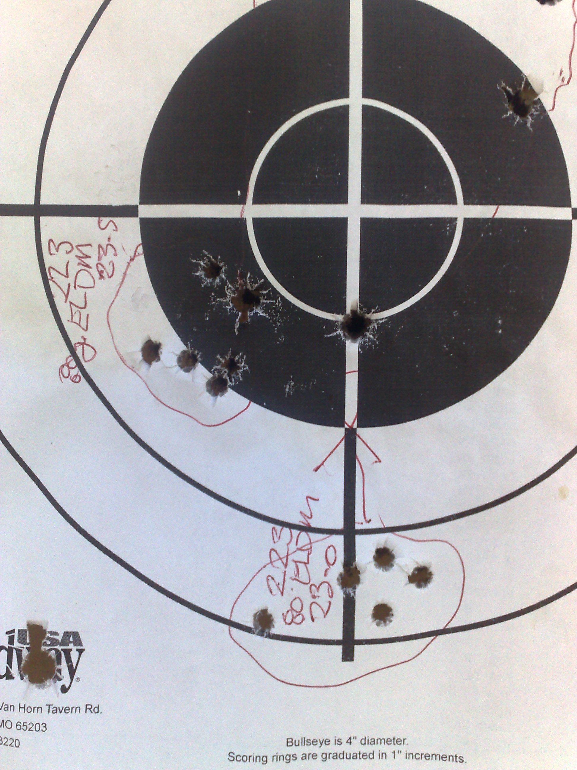

We were shooting different calibers on the same targets as we could tell the groups apart due to the size of the holes, then going down and patching them out.
I didn't shoot any more .223 today but I loaded 50rds of the 80gn ELD-M on 23.5gns of AR2206H for further accuracy testing. My brother decided he wants to head home tomorrow so we concentrated on his .243 and his Anschutz .22. If not for some pesky fliers the Annie would've shot some really nice sub-MoA 100m groups. Our best groups we both managed to fling a flier high to the left!
I put a peep sight on the Norinco JW21 so I zeroed that and we shot some rimfire silhouettes at 100m.
And I put a smaller aperture in the No.4 M1* so I zeroed that as well.
Not enough guns!
Anschutz 64MS Eley Edge 100m
.243 RAR 58gn VMax on 12gn Trailboss 100m
.223 RAR 80gn ELD-M on AR2206H 23.0gn and 23.5gn 100m

No obvious fouling so far.
I sized the necks and measured the brass. Only the 24.0gn loads show any stretch - about four-thou longer than the rest.

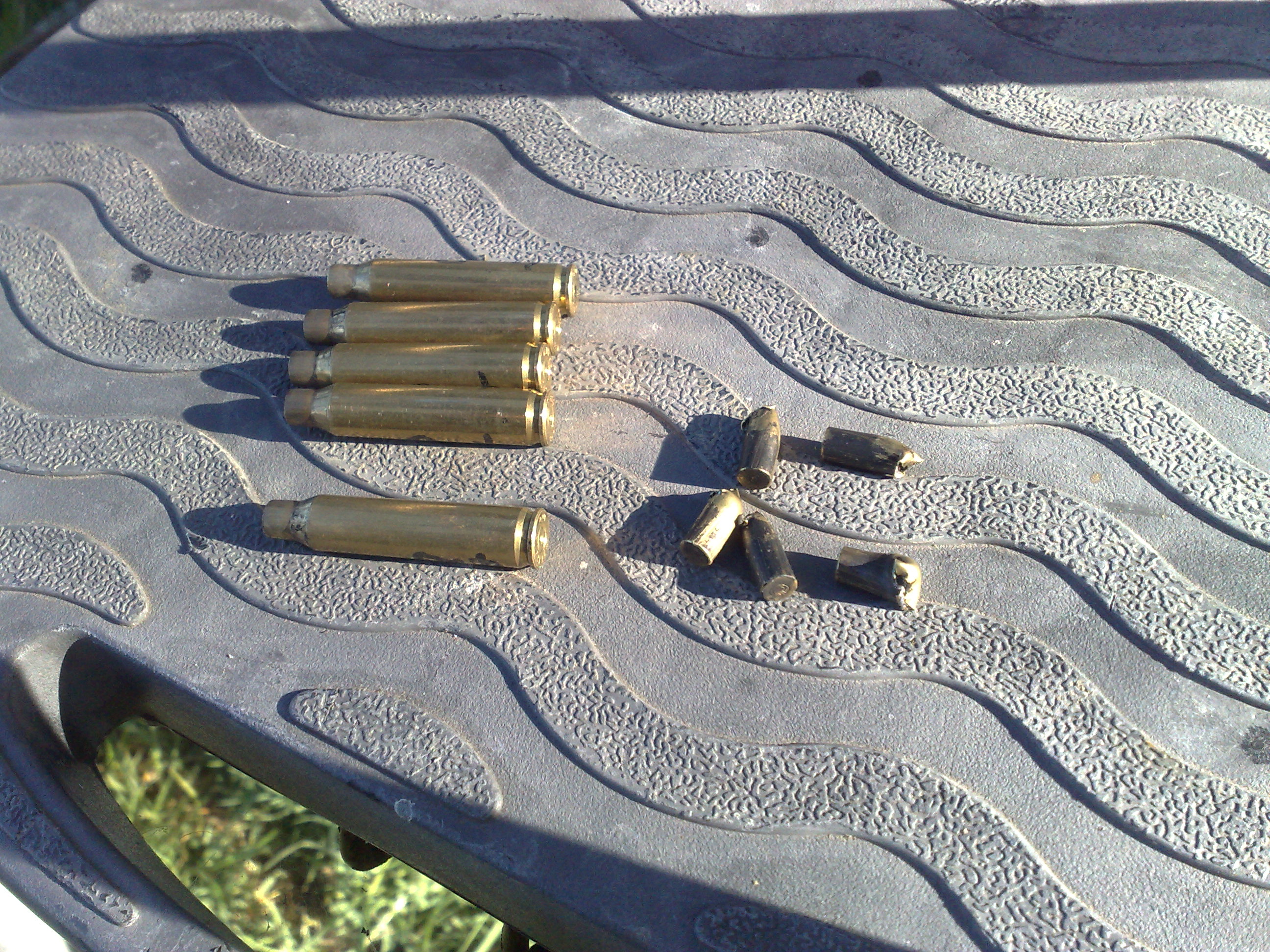

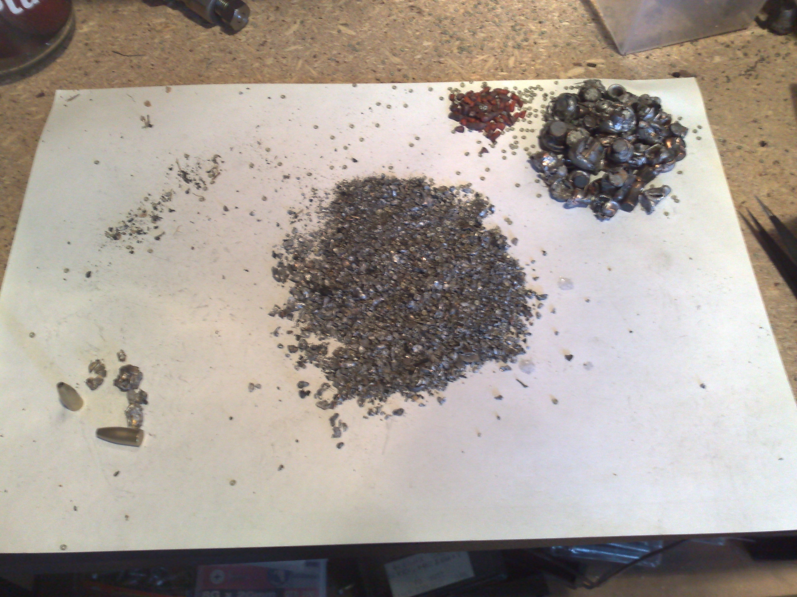

First I want to determine minimum terminal velocity required to deform them so I'm starting with Trailboss.
ADI list a Trailboss load of 4.0gn behind a 53gn bullet at 1040fps. The PPU case holds 10gn to the mouth and 9.8gn to the base of the neck so 4.0gn is about a 40% load. I hope to test shoot these today.

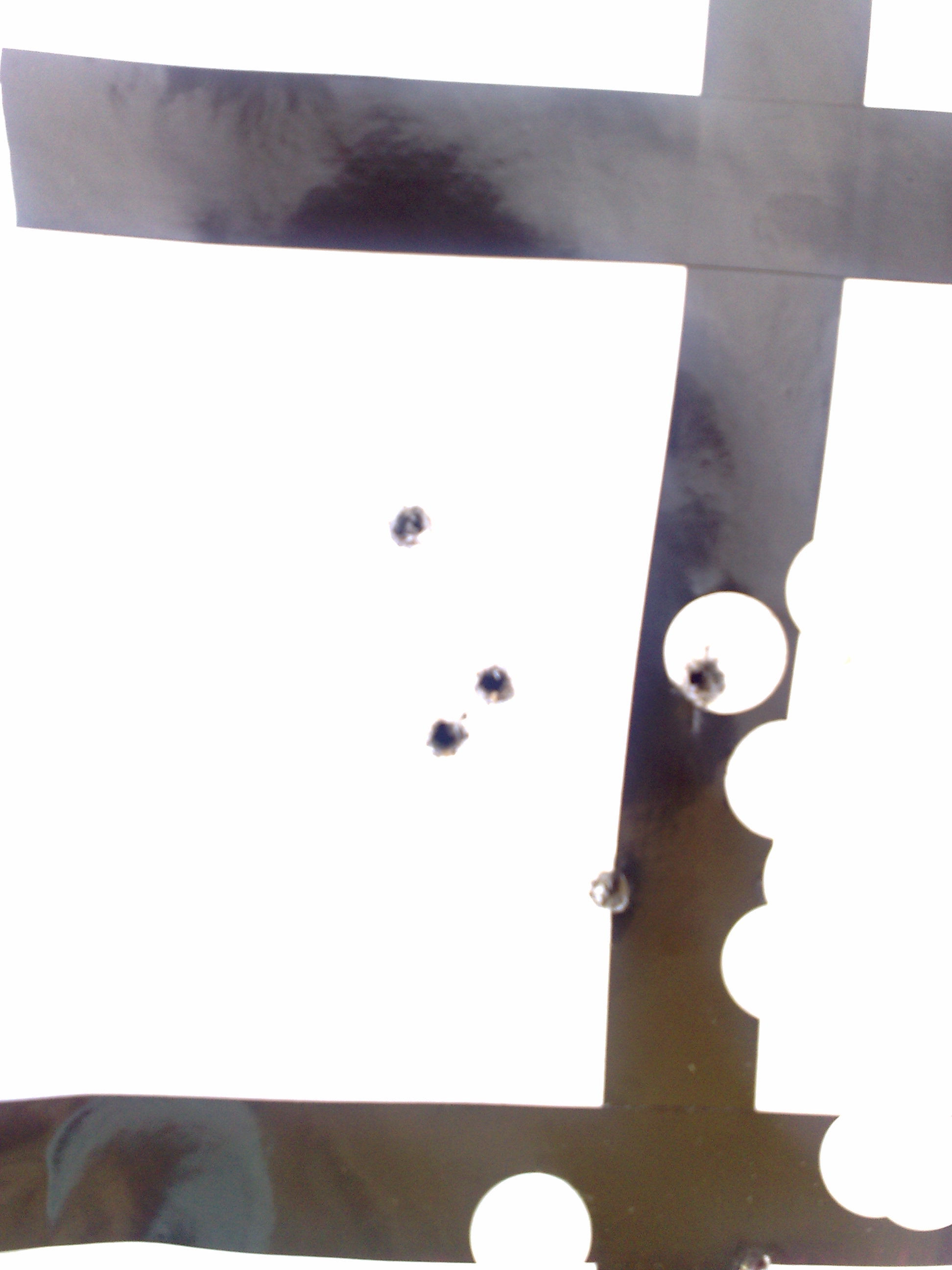

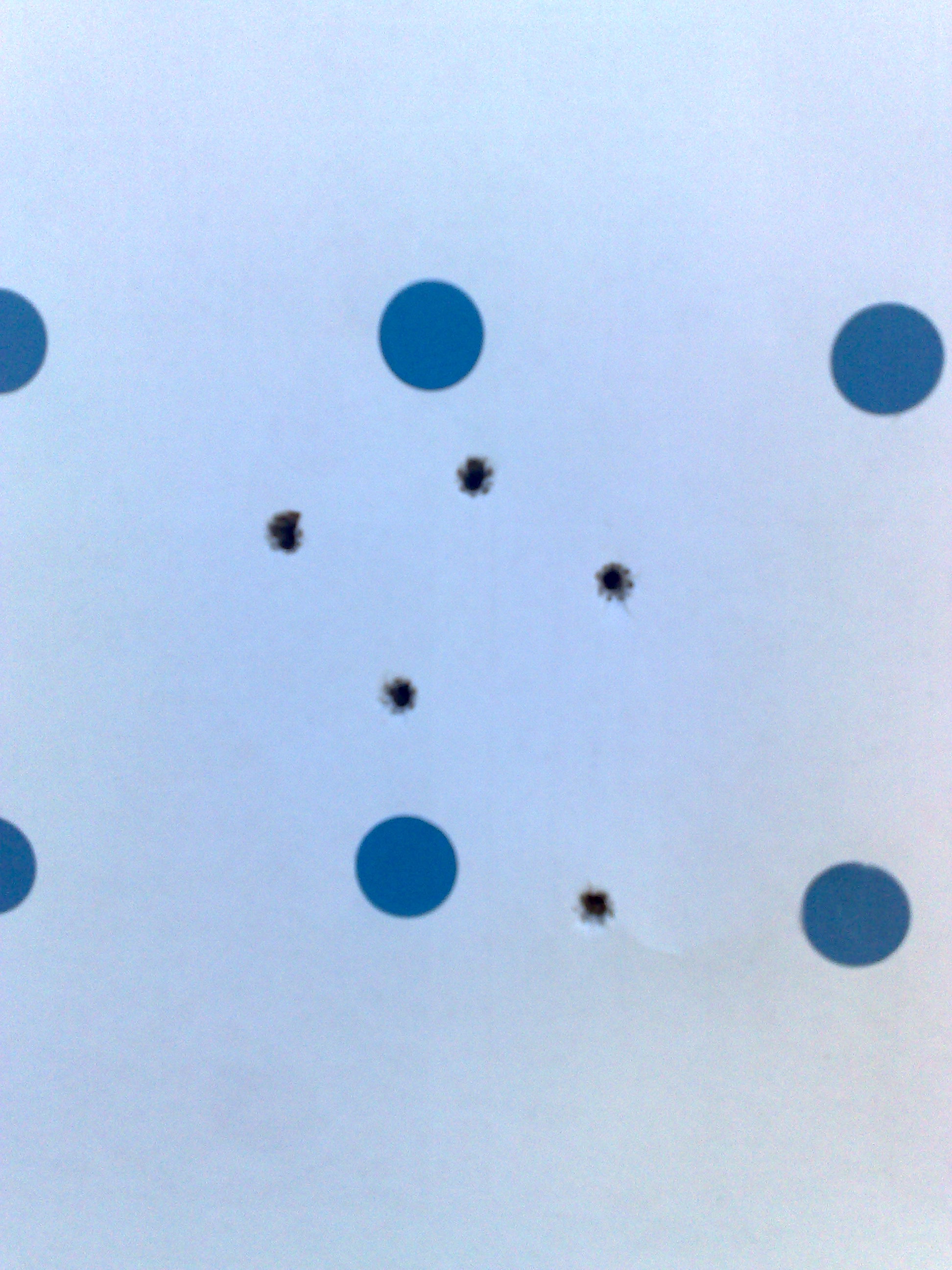

bladeracer wrote:First I want to determine minimum terminal velocity required to deform them so I'm starting with Trailboss.
Tried these just now, muzzle velocity 1180fps but virtually no deformation at 100m. At 100m velocity should be around 1000fps. Five shot group around 75mm fell 450mm low from the 80gn ELD-M zero.

The five I fired the other day certainly exploded hitting my rubber stop. I recovered everything right down to the powdered lead particles. Two were mulched up in a mess of lead and pieces of brass unlike any bullet I've seen before. Otherwise all I found were a few small brass fragments and powdered lead. Terminal velocity would've been around 2750fps. The photo was just after I spilled Trailboss across my bench :-)

Where these projectiles excel is as you have discovered they fragment and do maximum damage on small game resulting in less crawl offs or finishing shots.

Although it wasn't as still as I'd like I was too sore to do much else so I did some shooting with a wind from about two-o'clock but gusty. My chronograph seems to be stuffed so I don't have any velocities. My loads generally run fairly in line with ADI figures though so I can estimate them.
Unfortunately, I think my 8"-twist is too much for the thin jackets. I fired fifty full-power loads and twelve of them disappeared between the muzzle and the target. Those that reached the target showed reasonable accuracy.
I shot two five-round groups at 100m of 25.5gn, 26.0gn, 26.5gn and 27.0gn of AR2206H.
25.5gn (~3220fps) I lost one bullet but managed a 38mm group of five.
26.0gn (~3270fps) I lost two bullets and got a five-shot group of 46.5mm and a three-shot group of 45mm.
26.5gn (~3325fps) I lost three bullets and got a five-shot group of 40.5mm - the other group of two shots were almost touching each other.
27.0gn (~3380fps) I lost five bullets and got a three-shot group of 36mm.
I fired another two five-shot groups at 27.0gn and lost one bullet, getting a five-shot group of 47mm with neck-sized brass and a 33mm four-shot group with FLS brass. I''m going to shoot these cases over and over to see if there's a difference in case life between FLS and neck-sizing.
So a fairly consistent 1.25MoA to 1.5MoA (for those that don't come apart at the muzzle) runs about the same as the 55gn RooMax and 35gn NTX (under today's conditions). I'll make up more loads working down from 25.5gn until all bullets start arriving intact, and then look for accuracy tuning.
The bullet has a pretty sharp bottom edge as I had three that folded one side of the neck during seating. A heavy chamfer can probably sort that though.
