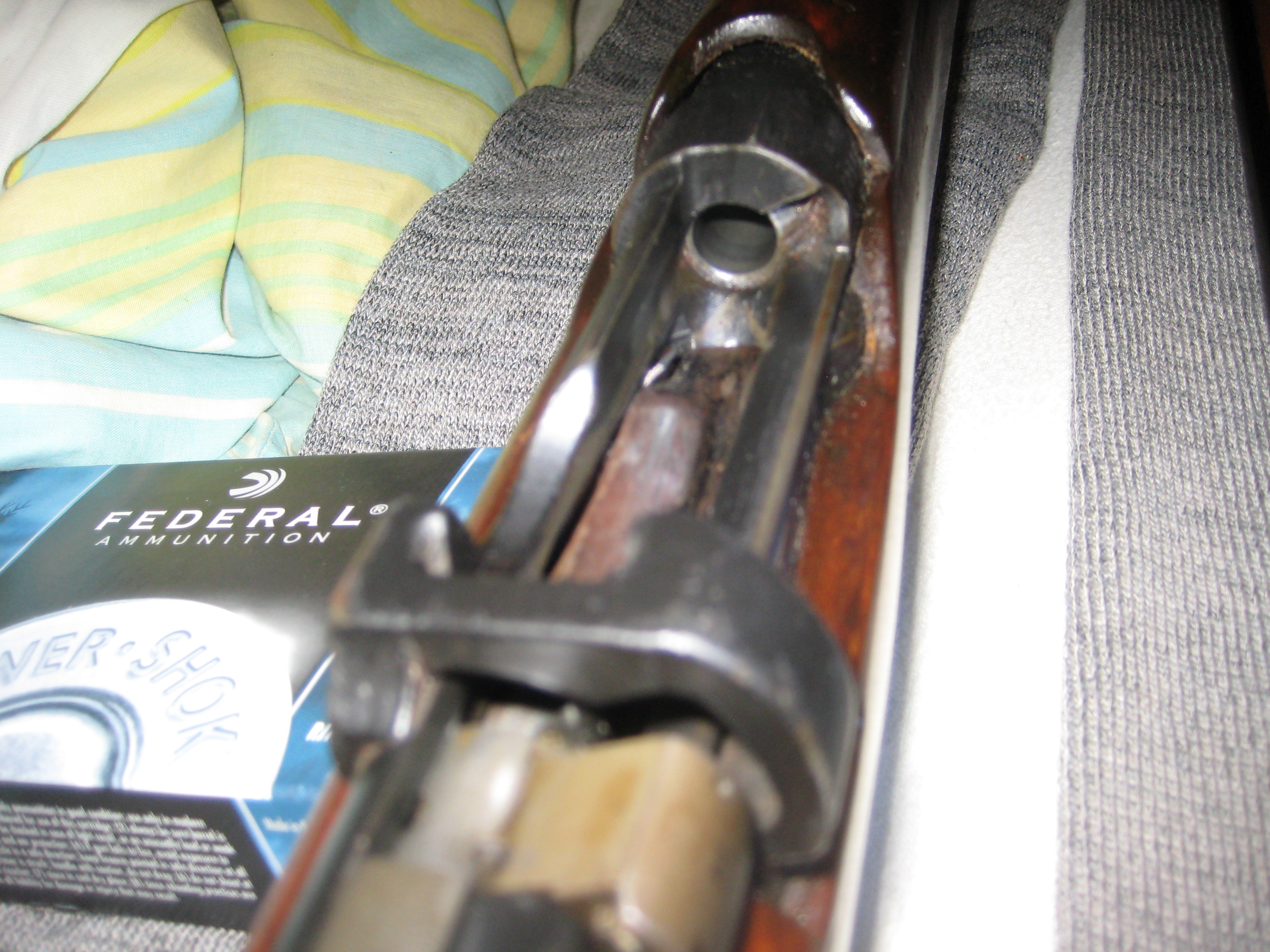

I've bought a lovely Lithgow SMLE MkIII.

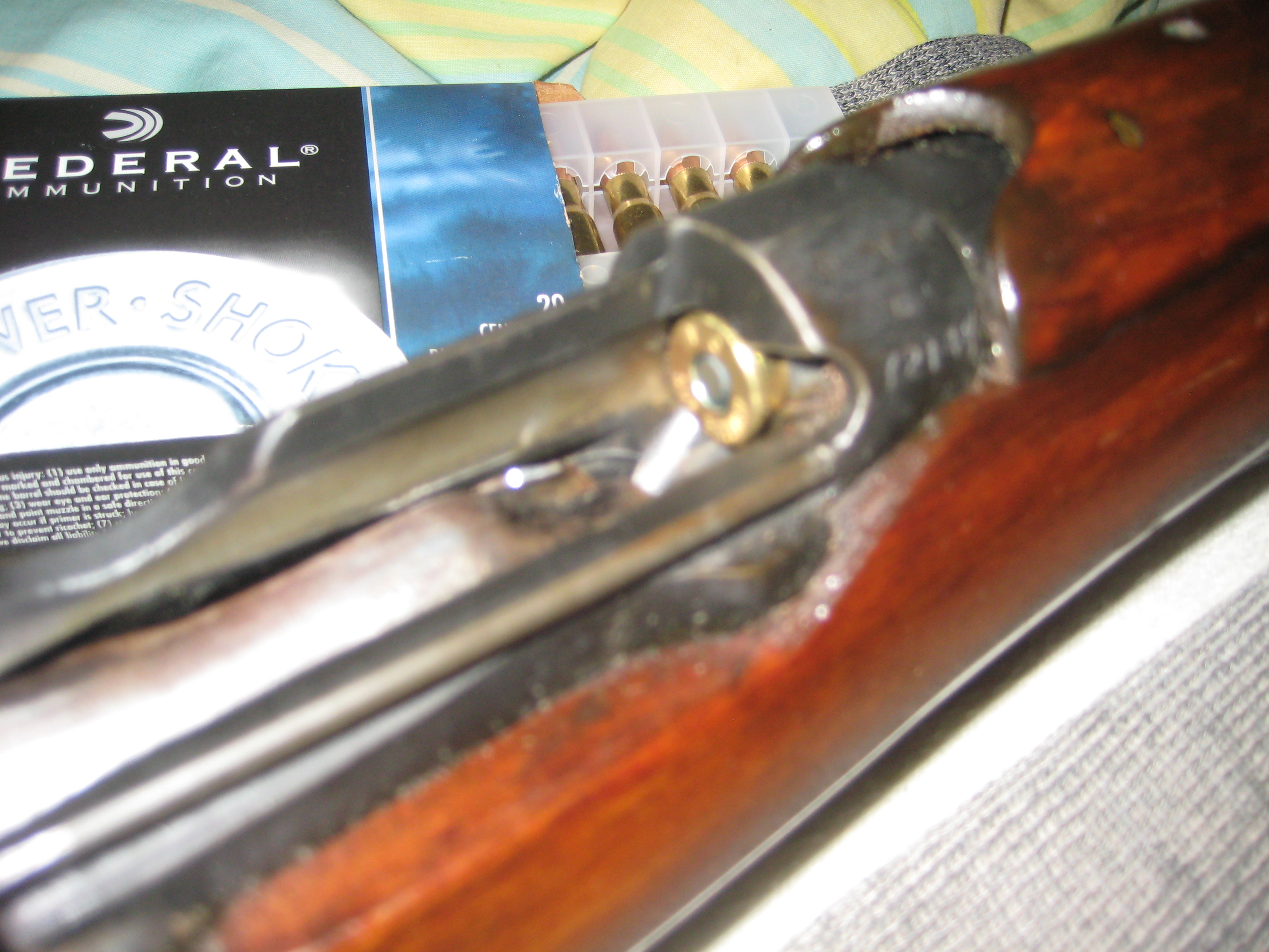

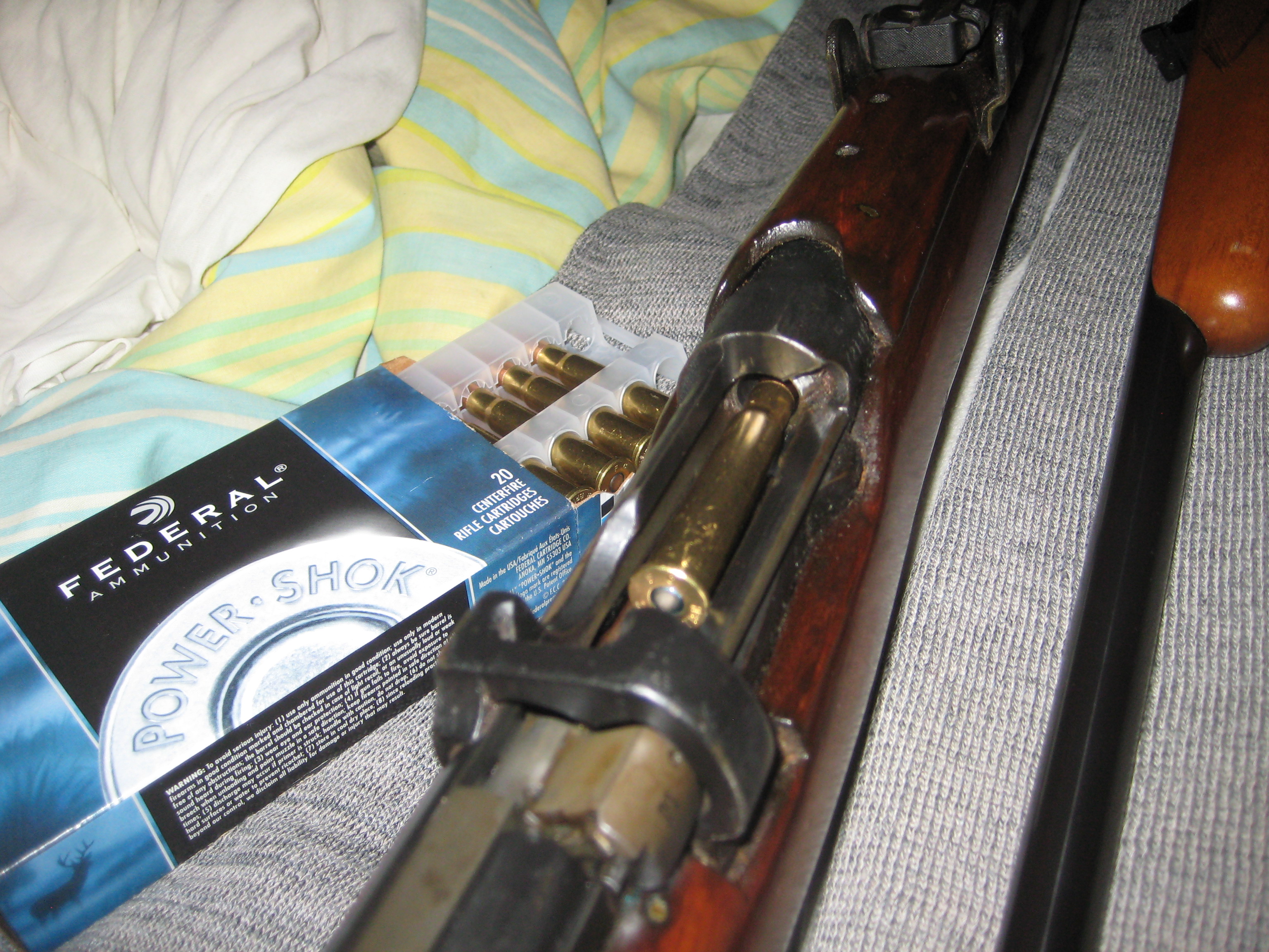

When I bought it home and tried to load a .303 round in it, got the first 90% of the round seated in the chamber, but the last 10% wouldn't fit, you either had it push it quite hard, and then it'd get wedged, and have to be rammed out with a ramrod.
Now, from my understanding these things may have gotten chambered for a smaller round? Though mind you, this was sold as a "303"
Metal above the bolt is labeled "FTR" with a little C or square under it, then the serial number.
The Bolt has a marking "M" on it
The s**ty blurred picture is the round slightly forced into the chamber. You can see where the round gets scratched up.
Can anyone tell me why it won't seat the round correctly? Pictures attached.

Does the bore measure about .311" at the muzzle?

I'm by no means an expert, but if it were me i'd be cleaning a the chamber with some 0000 steel wool gun oil on a 30 cal brush, if that doesn't work then it's most likely a 303-25 of some sort, but i would think you'd have issues up front of the round rather than in the back with all the scratches at the back of the case, these typically have a oversize chamber to allow snow and battlefield muck a bit of tolerance, they should load without an issue, seeing the boxes in the back but i'll ask anyway factory rounds yeah?

First of all congrats on your purchase, they are an amazing firearm. Now to your issue, due to the rates that these rifles were churned out, some didn’t make the same quality we know of the Lee-Enfield. So what you should do is take it to gunshot/smith to check the head spacing of the barrel. 2nd thing would be to give the barrel a deep clean with Solvent and a good sheen of some gun oil. Then you tackle it from that point. Plus it may be just mine but I have found my SMLE doesn’t really like federal, not sure why. I know that it does love S&B though.

Have those cases been fired in another gun? You may try a virgin brass case or if you have access to a small base die.

First check if a .303 round will slot into the muzzle end. Should go most of the way in. Secondly, another forum member had a similar problem, turns out the gun had been rechambered to .303 sport. The case being about 2mm shorter.

this is what I think you will find is the problem :thumbsup:
try google the 7.7x54 round and you will understand it better than I can tell you :drinks:

Post by JimmyS » 24 Dec 2017, 8:06 pm
I just googled as advised, you've got to be s**ting me.
Bastards sold it as a .303, this makes me mad. I presume the seller was lacking integrity and just said it was a .303, or the gun store wanted to sell it as a .303, as a .303 sport (7.7x54) wouldn't sell for as much.
So basically it's useless to me, as it seems that 7.7 x 54 ammo isn't easy to come by, at all.

all you need do is trim 2mm off the 303 full length die and trim 2mm off your 303 cases, full length size with 7.7x54 die and you have a 7.7x54 :thumbsup:
or get a 303 reamer down the chamber :drinks:
the 7.7x54 is a shortened 303 case that's all
but get the shop to either: rechamber to 303 or get the full length die and seater turned down for you

The easiest conversion for the SMLE was to cut 2mm from the barrel end and modify the extractor slightly.
The cartridge was close to .303 so I guess it was easy for factories to retool.
The rifle won't fit a .303 cartridge but the modified calibre is called 7.7x54, somewhat confusing because I believe there is a Russian calibre with the same name.
