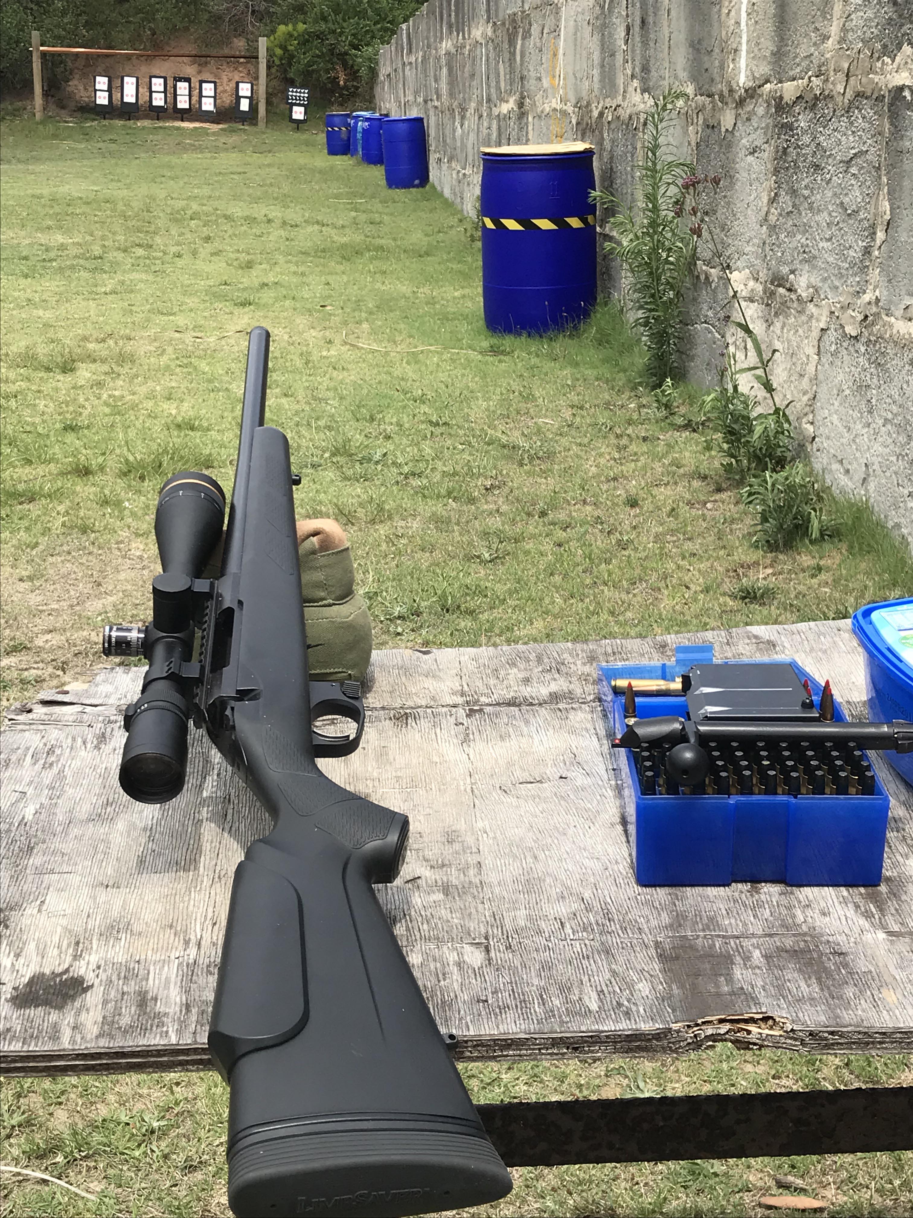

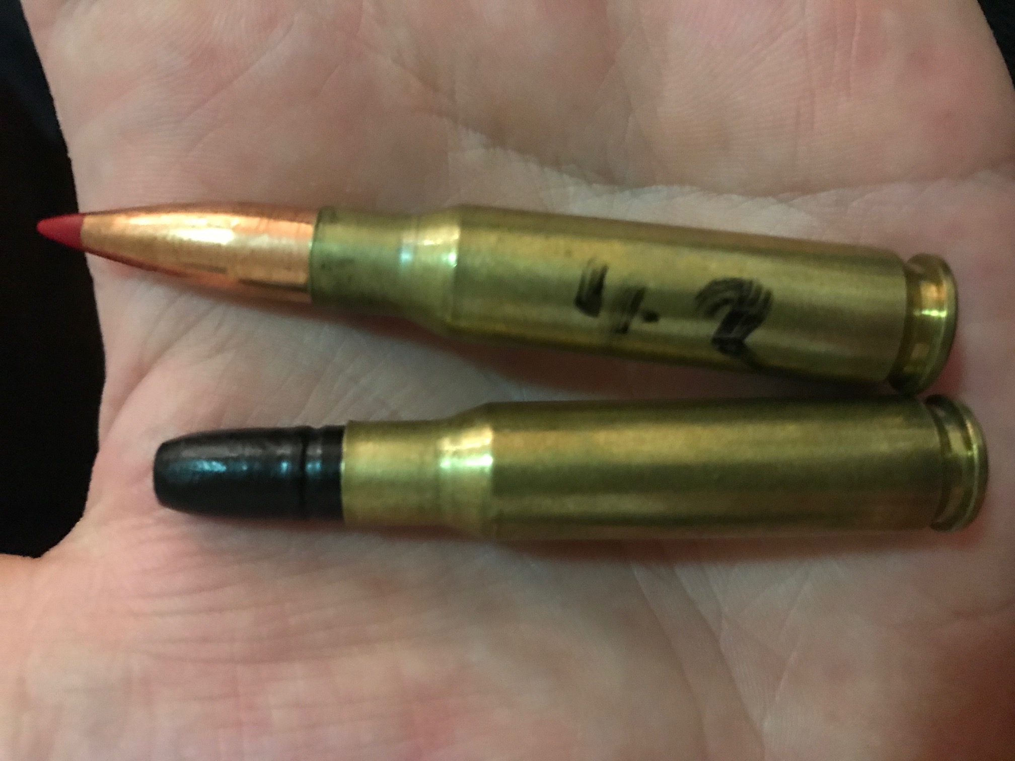

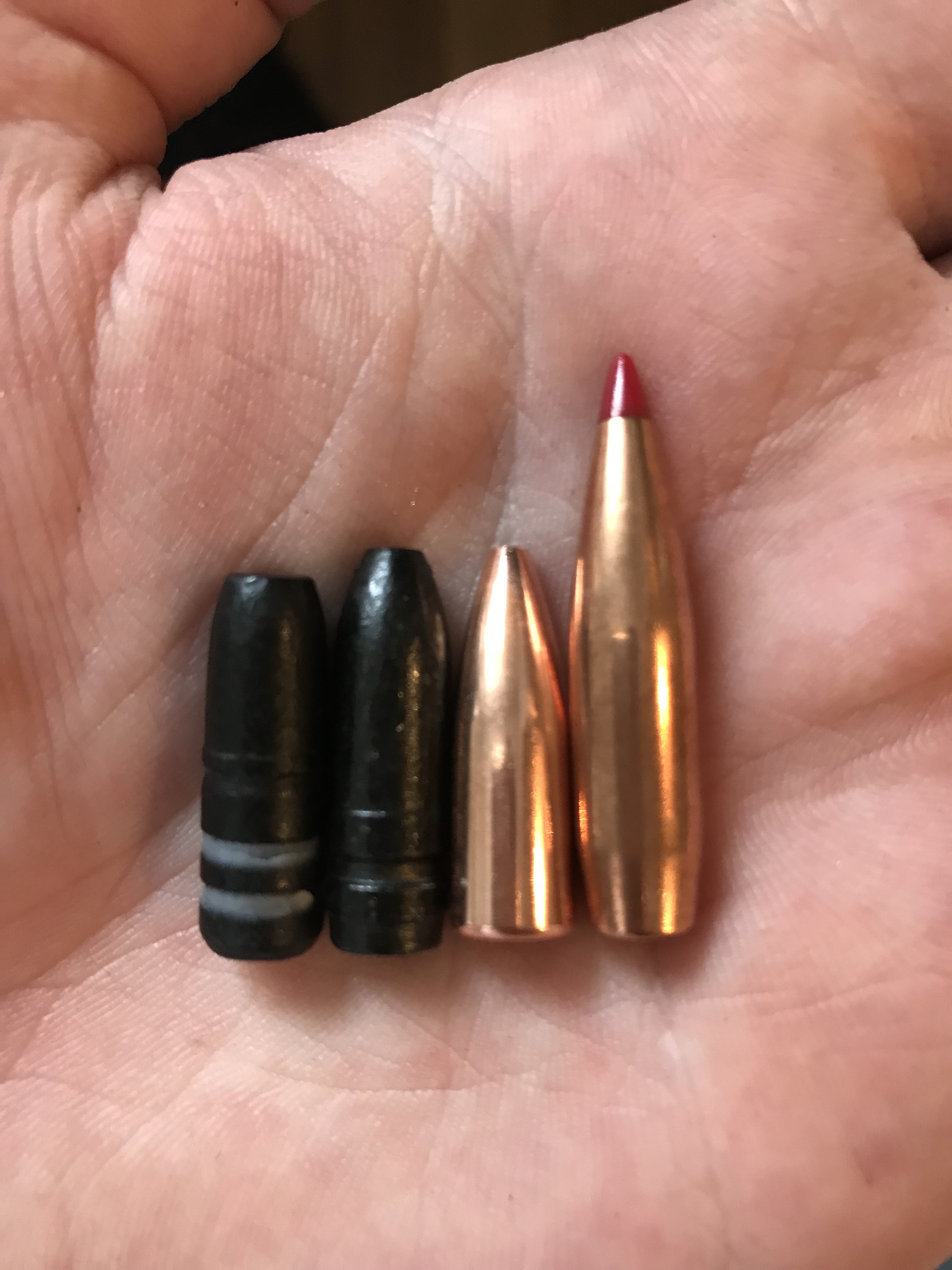

A few different choices, but because there's no need for GCs (when using Trail Boss), the RNFP 30/30 projectile on the left is a perfectly adequate:
RNFP, RNGC, FBHP, ELD-X
so, cheap 10gr Trail Boss vs expensive 42gr 2206H:
Cheap vs expensive (RNFP vs ELD-x)

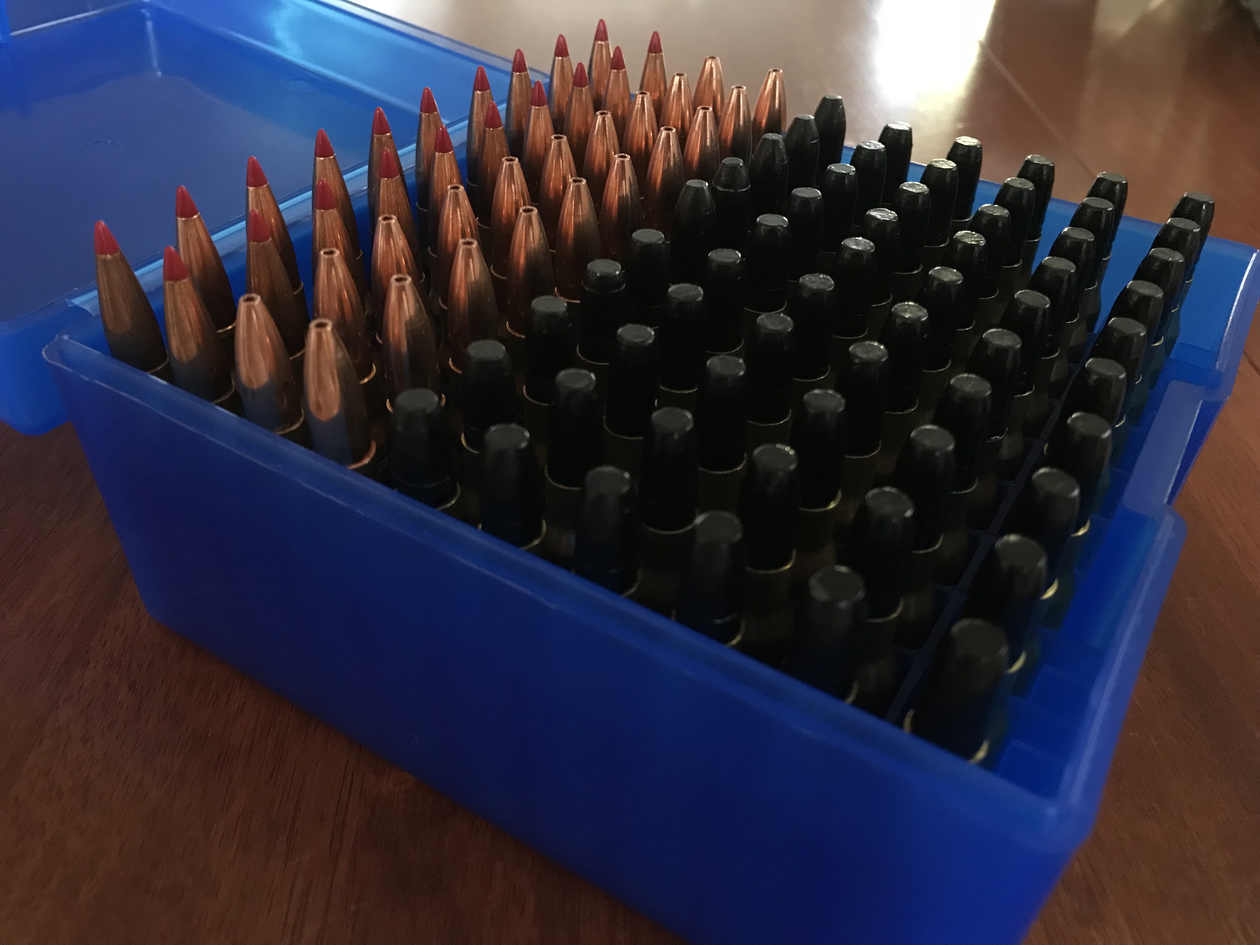

Typical batch taken to a 50m range, 178grs for 500m rams, 150gr HP for everything else (and hunting), and mostly 165gr lead for plinking:
Mostly plinkers with a few jacketed

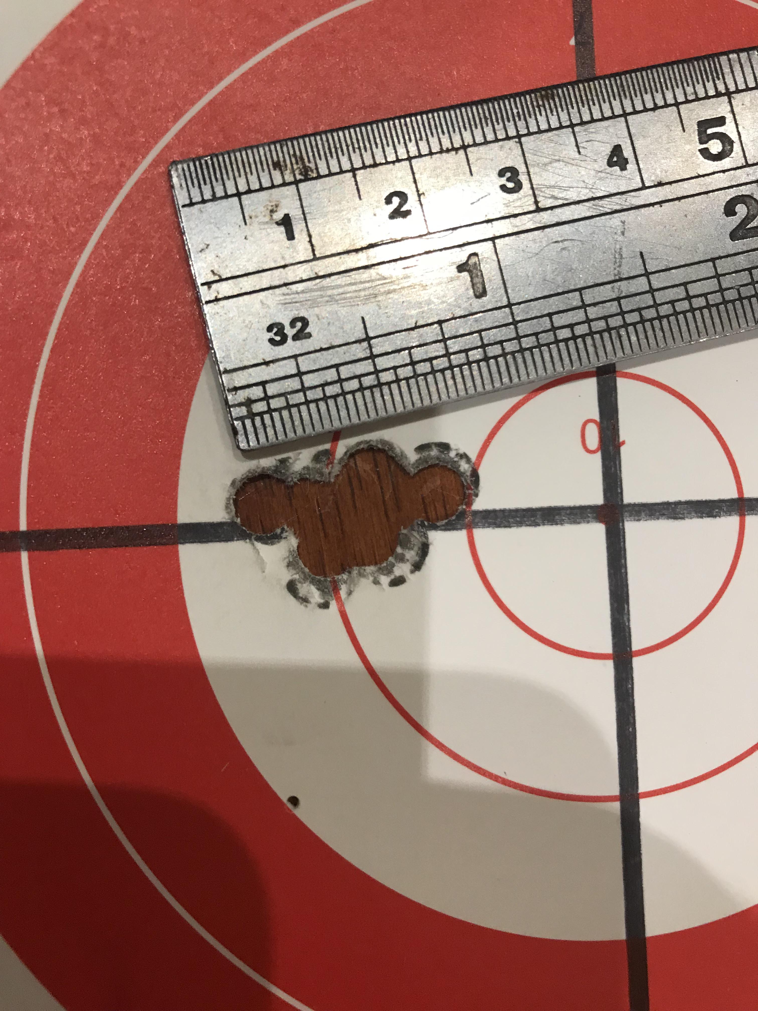

This is a typical 10 shot group using the cheap 30/30 projectiles:
RNFP (30/30) over 10gr Trail Boss

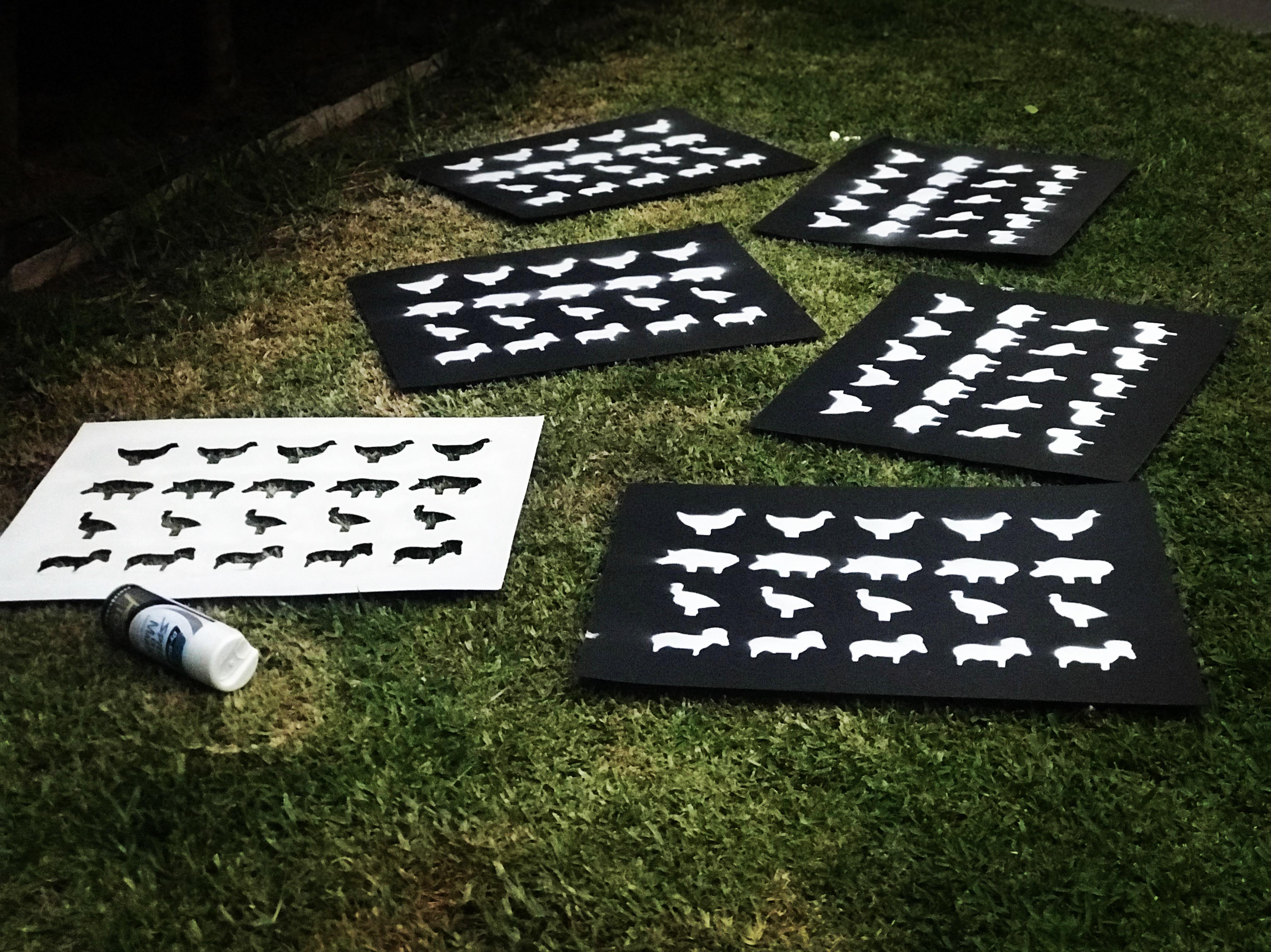

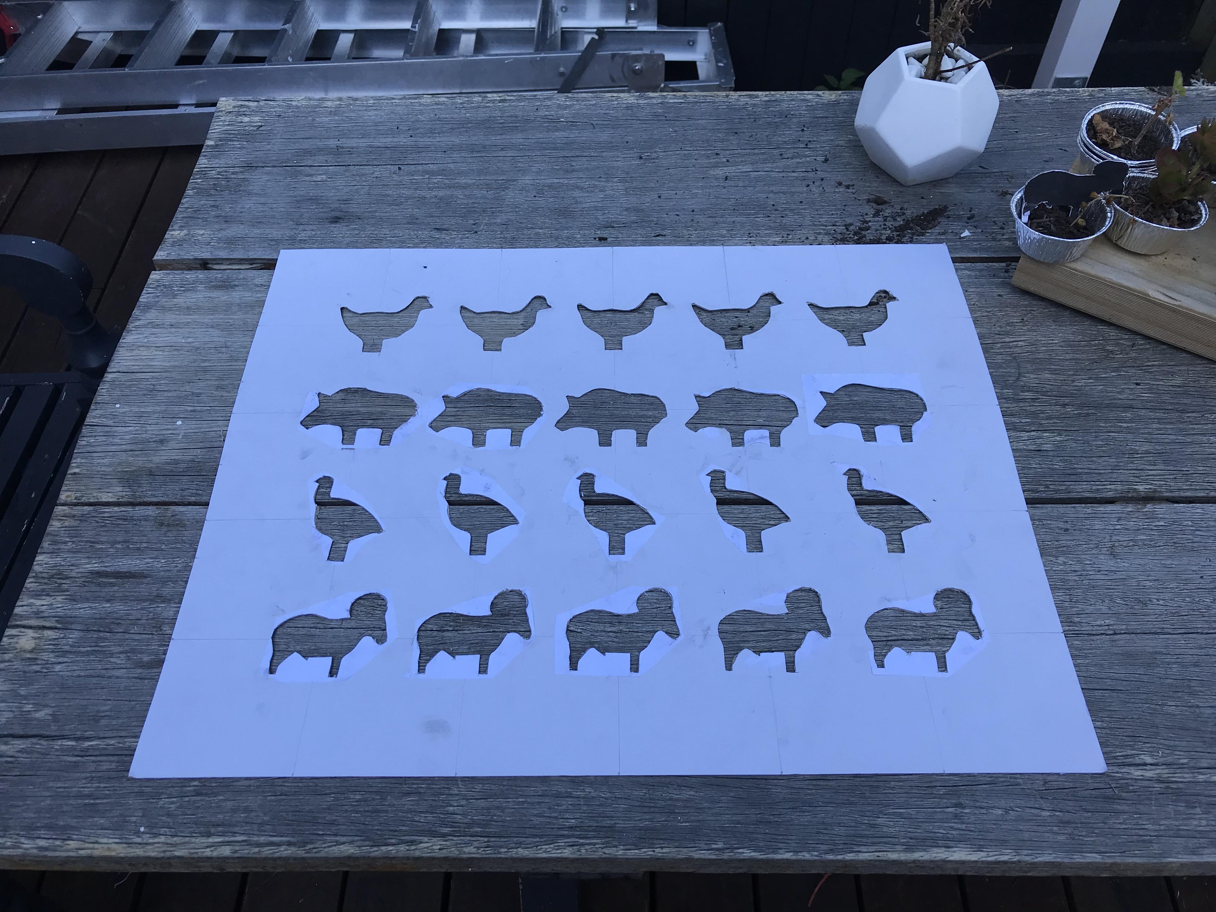

Using the official silhouette vectors, I scaled all the targets to the correct size for a 50m persepctive:
50m silhouette stencil
The stencil in action:
600gsm black card from Officeworks
End result, 30c a shot practising high-power metallic silhouette without breaking the budget (and avoiding unnecessary wear on the rifle) :

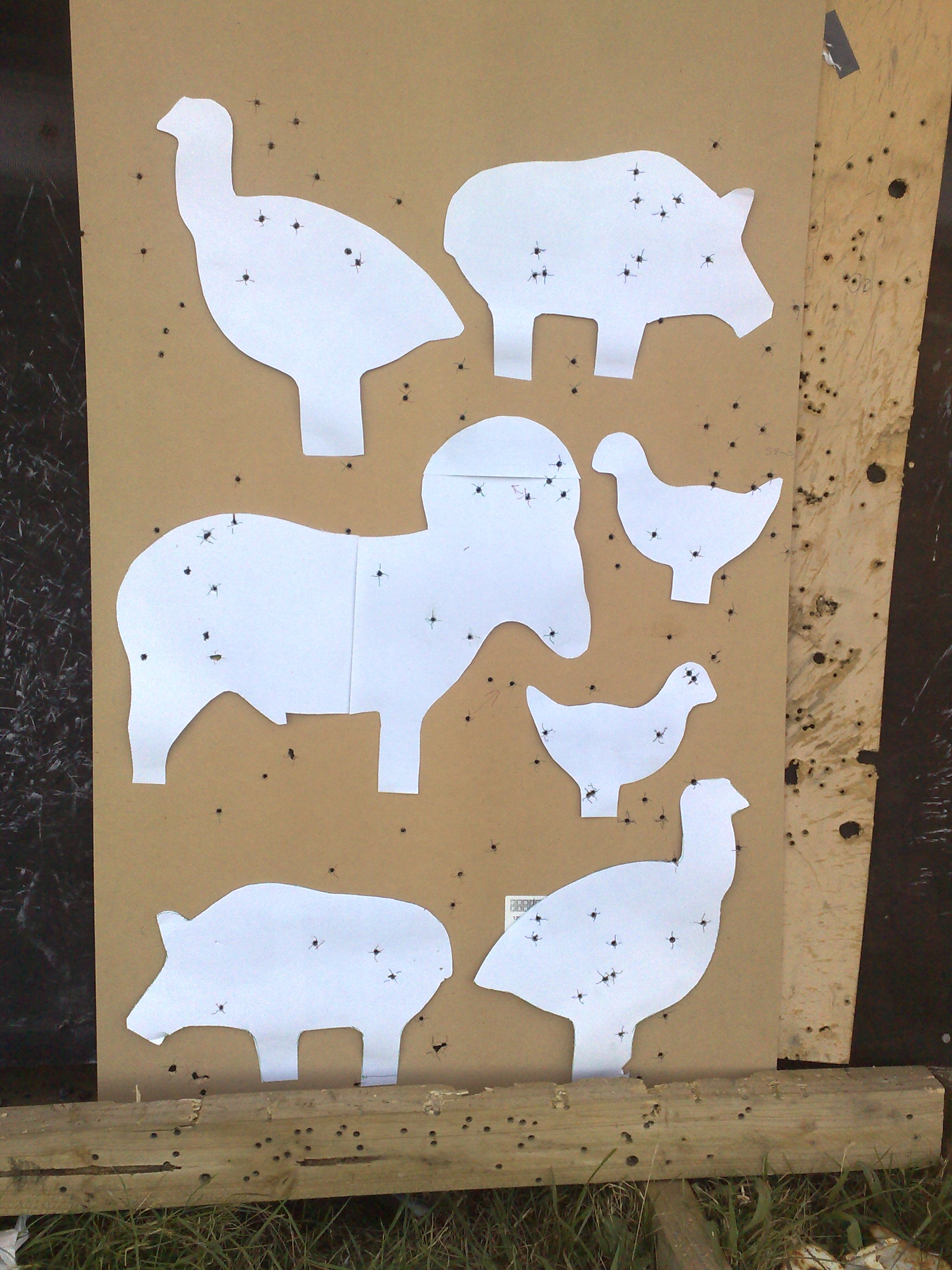

I shot these yesterday. The chicken is a low hold 50mm below the foot, the pig is held on the bottom of the belly, the turkey the top of the back, and the ram dead-on.

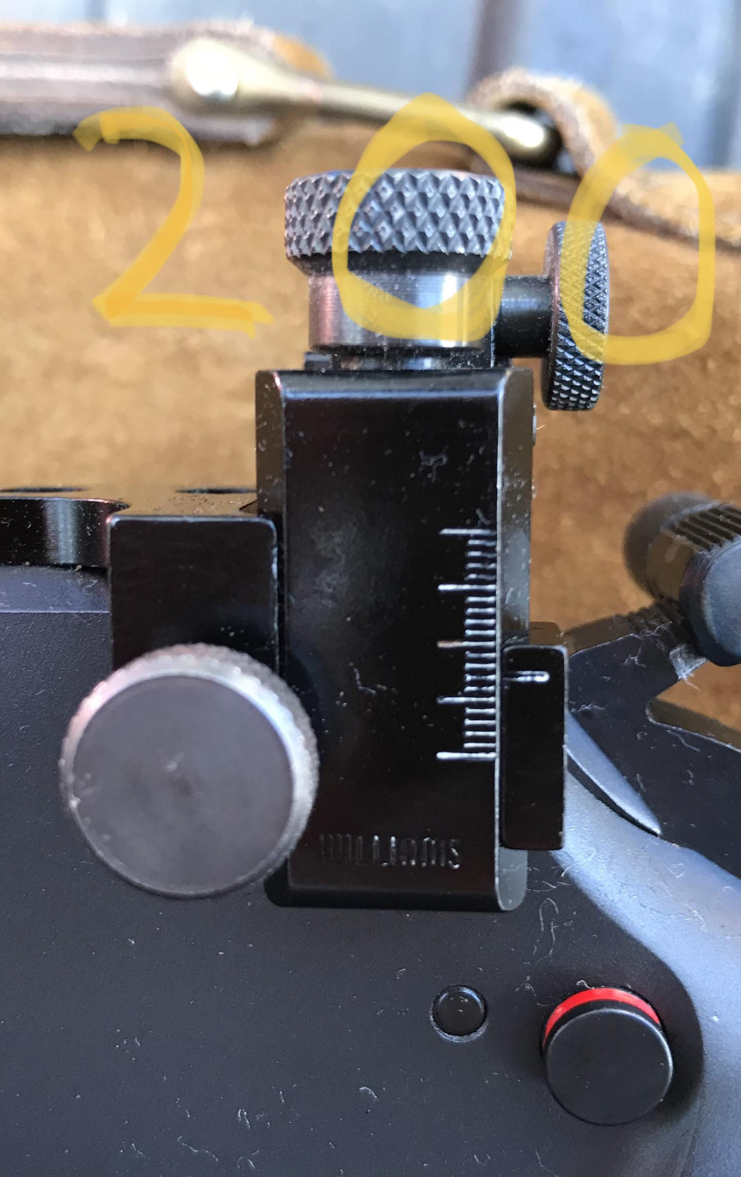

I tried to do holdovers at the start, but found my scores were significantly better if I re-zeroed at each bank, most competitors do this. I also started with a plain FP-336 on my Marlin 336, only to realise I needed the long target knob and finger-adjustable gib lock. Makes it field adjustable without any tools, which is helpful for the 15 second "ready" period where you adjust your sights for the next distance. Also I needed a high front sight to go with it. I've now memorised the locations on the little ladder for distances all the way out to 300m - perfect for hunting, I pretty much tweak the elevation for every shot!

Blade here's a close up of the gib-lock (set @ 200m):
200m setting
Re: Cheap 30/30 pills through a 308w bolt
Post by bladeracer » 16 Jan 2018, 10:45 am
in2anity wrote:Blade here's a close up of the gib-lock (set @ 200m):
Will the sight not stay set without the lock screw?
Post by Gamerancher » 16 Jan 2018, 11:27 am
Short answer, no.

in2anity wrote:This is a typical 10 shot group using the cheap 30/30 projectiles:
Cracker mate :drinks:
Norton
Posts: 833
Post by in2anity » 19 Jan 2018, 12:45 pm
Norton wrote:Cracker mate :drinks:
Thanks mate :drinks: it's a boringly accurate rifle TBH; when it comes to the real deal (I.e. jacketed) anything I feed it (and more importantly any load) is way more than adequate for metallic silhouette shooting (i.e. standing offhand) which is great, because I don't like to run my rifles at max pressure. Because of how inherently accurate the rifle is, there's no issues just using starting loads (which only output around 40,000psi). Horses for courses :thumbsup:
