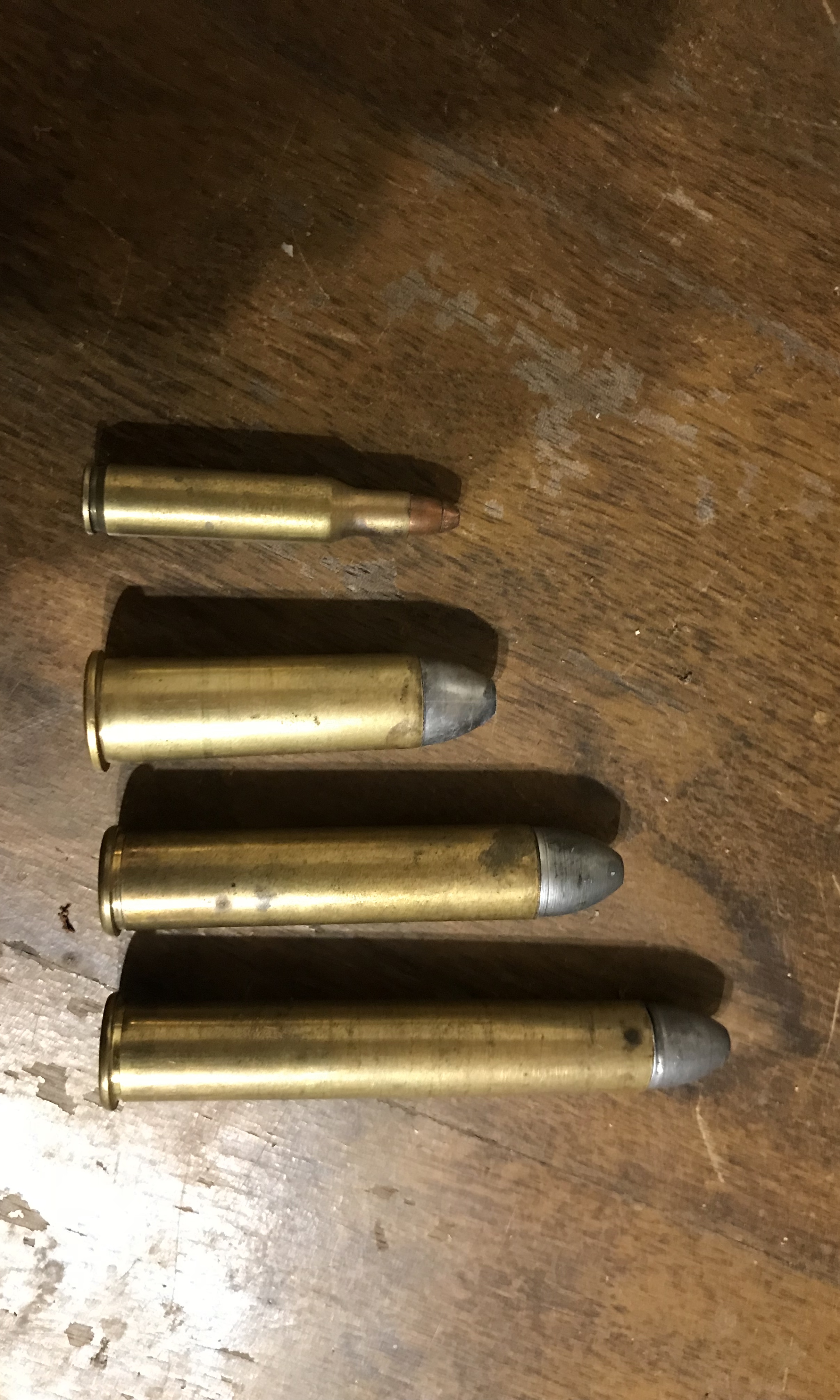

Here you go...
.222
.50-70
.50-90
.50-110
